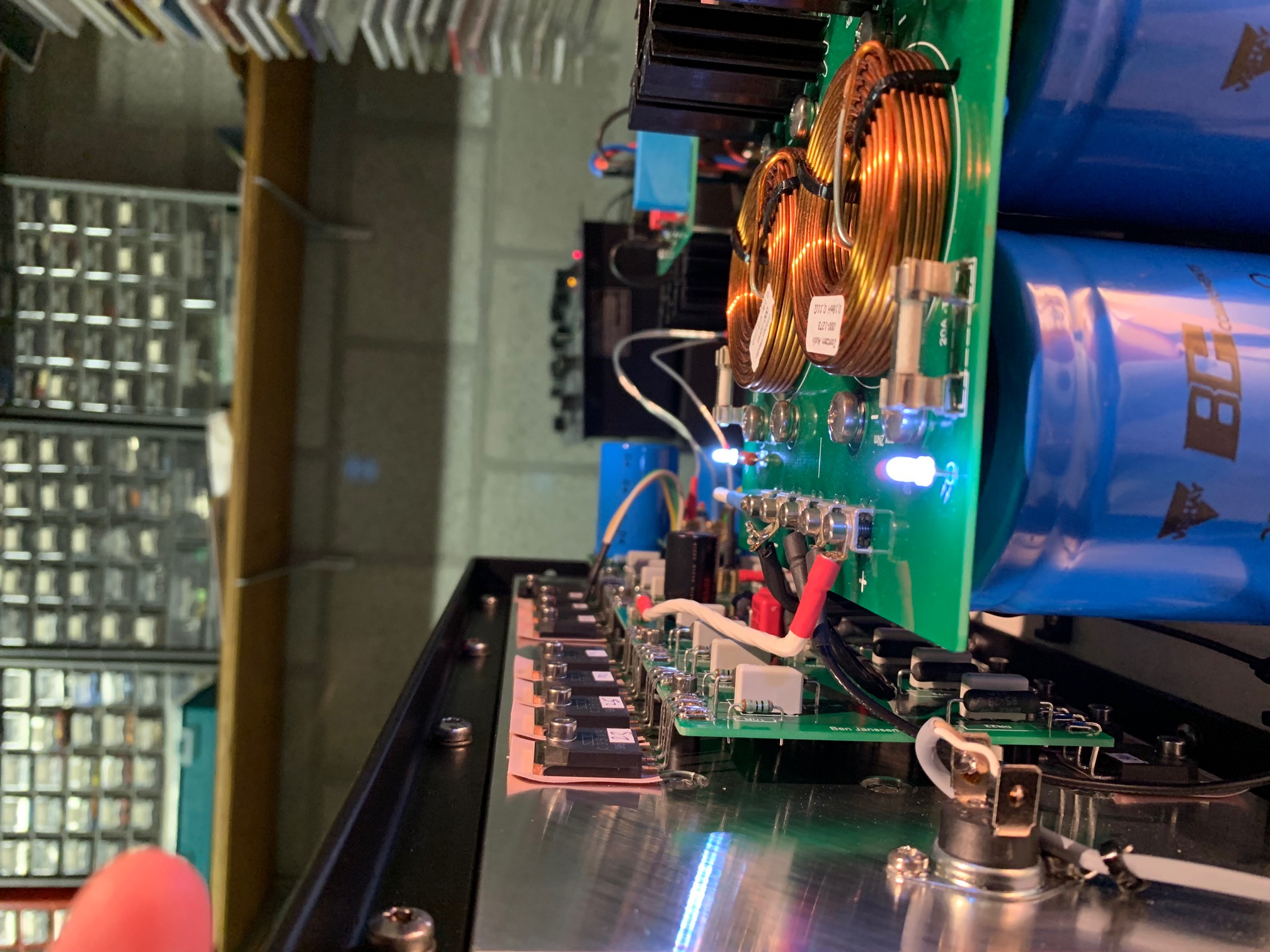

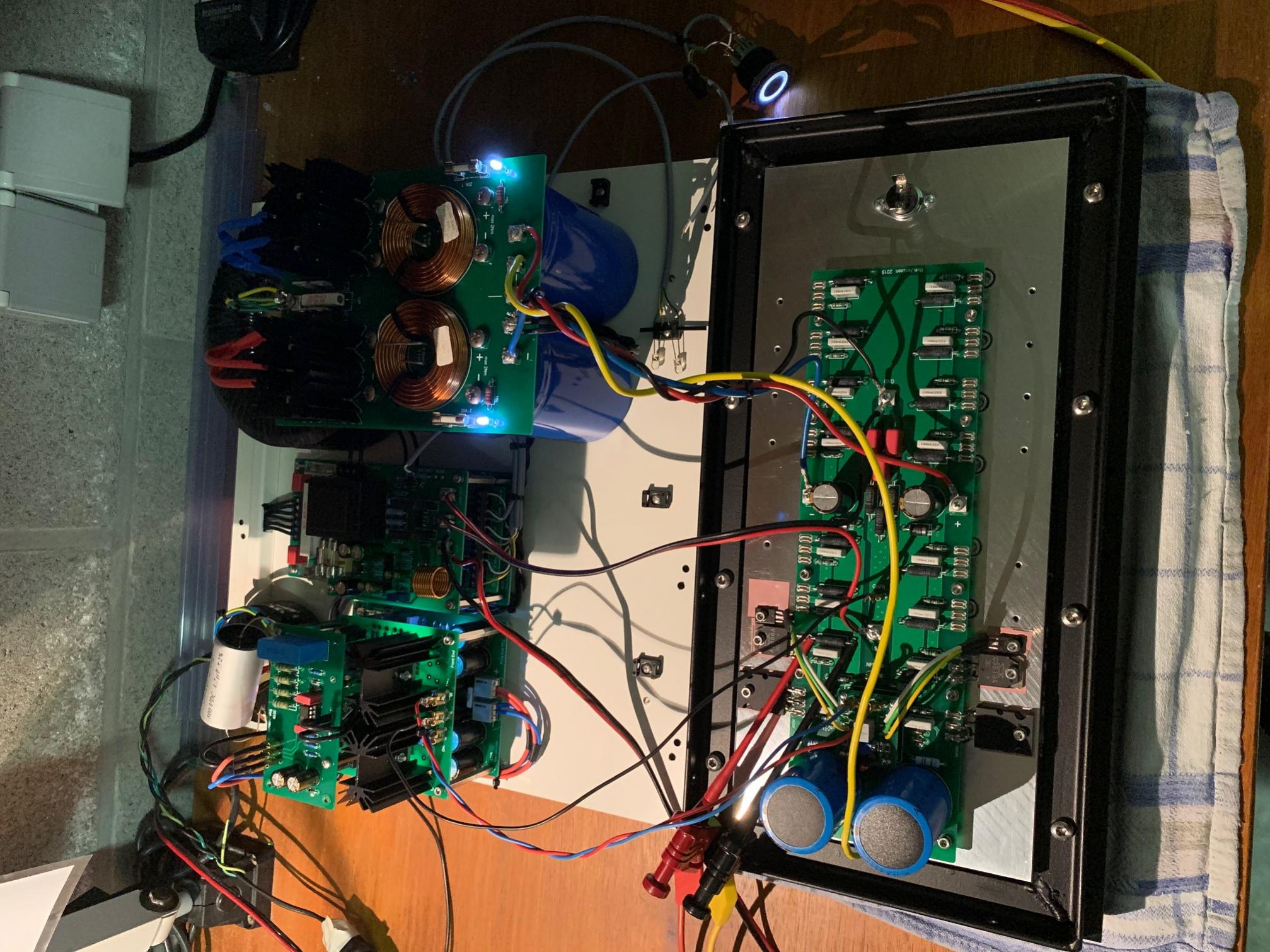

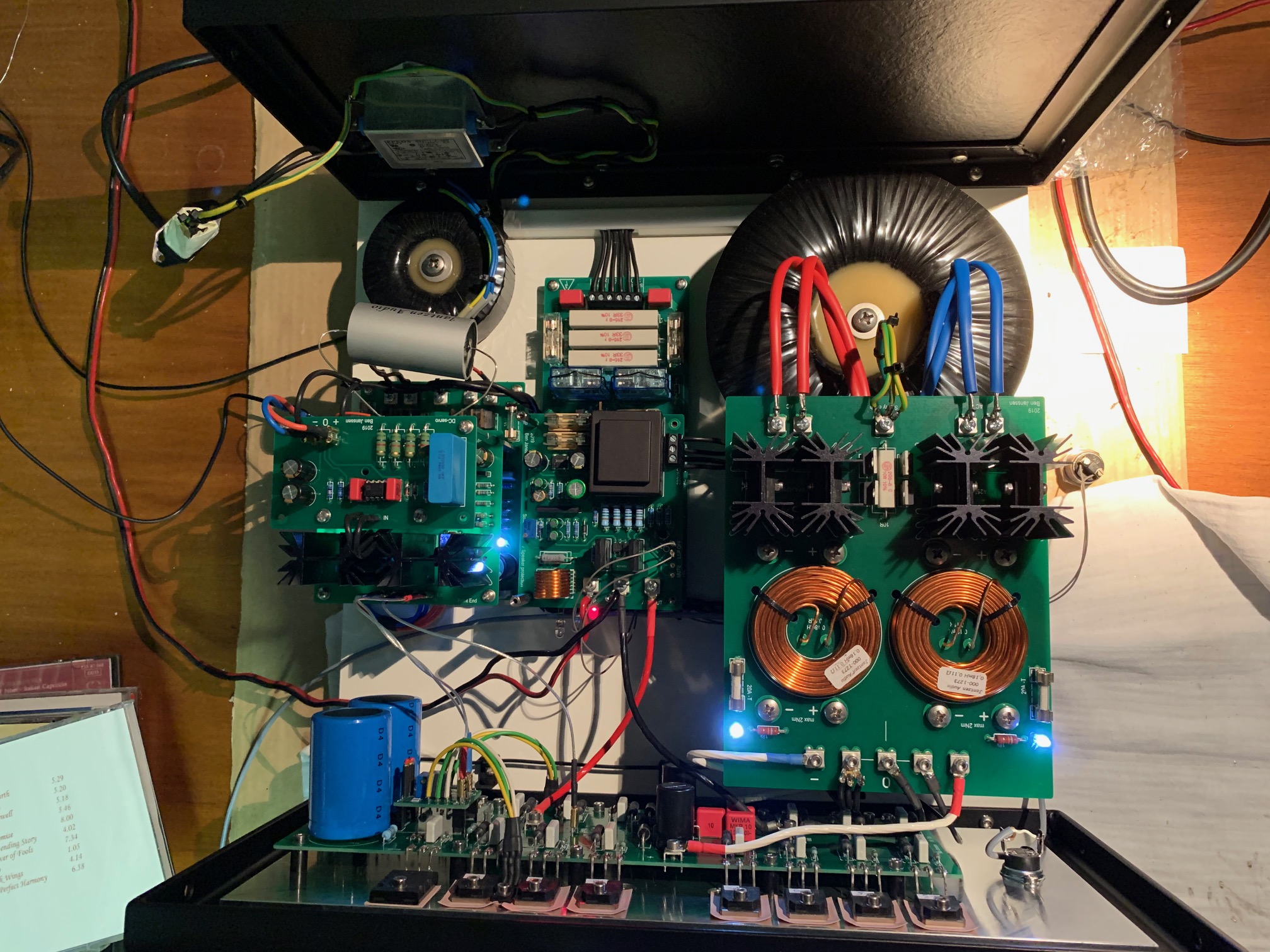

Thanks for the feedback, I'm rather happy you have the same opinion about the square wave reponse.
I just remembered I had some pictures of square wave tests done some time ago, but only with 1 pair of output devices (same circuit but different PCB).
Now we can compare the square waves done at 10kHz with a 8R//820n load.
With only 1 pair, the square wave respons is about identical, same damping but amplitude with 1 pair looks a bit bigger.
I can't quantify what I'm hearing. I have to wait until I can power up the second monoblock (I'm waiting on some copper/silver 11AWG wire for the power supply wiring), should arrive in a couple of days.
Well,
The second mono-block is running. With this one, I only used 1 pair of output devices. This to check what the difference is soundwise.
Remark, the amp with the 7 pair of output devices has burned in about 100hours currently. The one with 1 pair only a couple of houres.
1. Is there a difference between 7 pairs and 1 pair: Yes, easy to recognise
2. Difference in sound: 7 pairs = more detail, more top end. But pleasantly.
3. preference: for now the 7 pair amp is by far the better sounding one.
