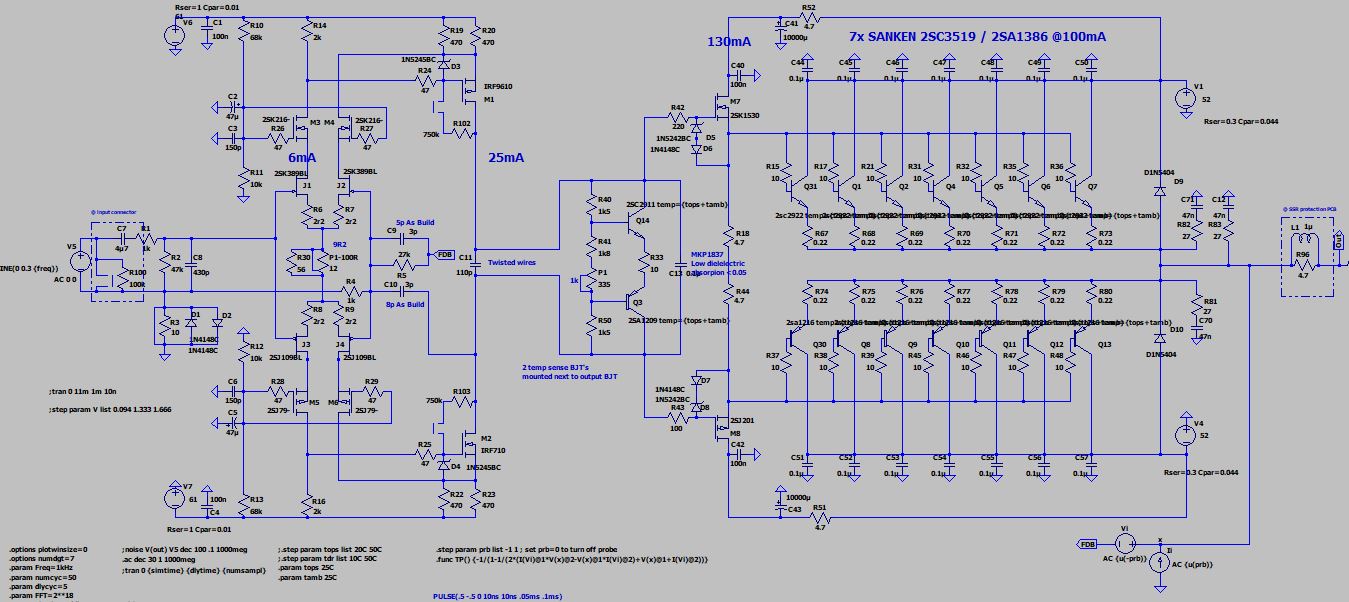

Now Bensen, see if you can figure out what is going on based on these results:
Things to check:
- RE Resistor ratio
- VBE match
- Current ratio at quiescent
- Current ratio at 1A
Measure each VRE at quiescent and at 1A. I think with those measurements, we can figure it out.
Also, post a schematic.
Best, Sandro
Dear Sandro,
Here is what I'm able to measure:
1.Resistor ratio: Resitors are dale RS-2B 0R22 0,5% ==> Worst case:0R2198 -- 0R2211
2.VBE match @about 20°C : @100mA: 0,6396…..0,6406mV
3.Current ratio at quiecent:
@18°C: 105mA…112,3mA (based on voltages over emitter resistors)
@50°C: 105mA…113,2mA
4.Current ratio at 1A: Not able to measure this due to thermal problems
5.Hfe's @100mA: 99...108
Below is the circuit as build.

Hi Bensen, interesting that going from 1 pair to 7 pairs made things worse. Weird. But, it could be a bunch of things including:
- 7 pairs may loading the pre-driver output, the capacitance at that node went up 7X slowing the node down.
- A potential oscillation due to a decrease in stability of the amplifier - you increased the parasitic pole time constant quite a bit.
How did you decide 7 pairs was the right number?
Anyway, would be interesting to see what you find.
- Sandro

1- Resistor match looks good. But, their effect on ratioing will be at 1 Amp, not iddle.
2. Delta is 1mV. BTW, you are running each pair 100mA? That is 700mA in just the output stage, that heatsink will be really hot.
So 1mV, is a ratio of exp(1m/26m)=1.0392x or 4%. This is quite good.
3. 113mA/105mA = ~1.06 or 6%. While not precisely what 2. predicts, but close enough within the margin of measurement error.
4. No worries, we know at 1A is about RE match which is already good.
5. Close enough.
Good to see that measurement matches theory within measurement error, but at this point, I don't think matching is your problem. I think you put way too many output devices. Given your supply voltage of 52V, this is a ~130W amplifier give or take into 8ohms, so 3 pairs is really all you need.
Dear Anatech and Sandro,
I will perform some 10kHz square wave tests in the next couple of days.
Indeed, I've not done this witu 7 pairs. With 4 pairs everything was rock stable.
7 pairs... let's see??
Why 7 pairs: I noted that in the Original thread of this amplifier. Please find here:
https://www.diyaudio.com/forums/sol...low-nfb-fet-front-bjt-ops-14.html#post6164872

I'll look at the thread. For reference, from Bob Cordell's book:
"A rule-of-thumb thus emerges: divide the rated power by 75 and round up to the next integer. This is the minimum number of output pairs recommended to satisfy this thermal criterion. A 400-W amplifier would thus require six pairs of output devices"
- Bob Cordell
For your amp, that works out to two pairs. I like being conservative too, so hence I recommended 3. You want to be even more conservative, then I would recommend 4.
Best, Sandro
- Bob Cordell
Best, Sandro
Well Sandro, my calculation (link two posts back) are based on calculations with actual parameters used in the amp.
The output devices are temperature derated, page 2 in the spreadsheet. I have used the DC SOA lines from the datasheets, not the 10ms line!
On page 1 you have to input a worst case phase angle together with the impedance of the load. My input values are based on again actual speaker measurements from b&w and Sonus Faber speakers available on stereophile IIRC.
The rule of thump from Bob C. Is applicable for 8ohm loads probably.
Anyhow, I trust my calculations.
- If you put new output transistors, class A/B, will tou match them?
