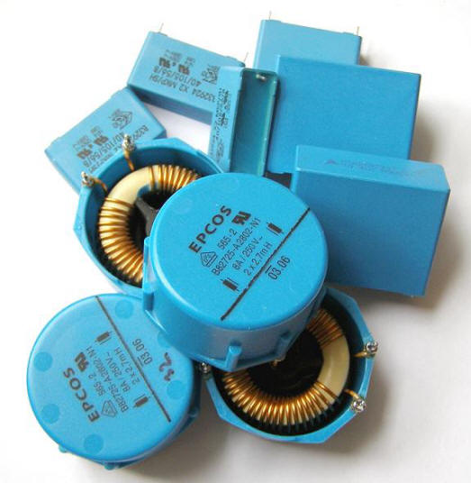

poobah said:Are those round Epcos things common mode chokes?
Hi poobah:
You're correct - they are. They are part of the high-current power filter I built for the power conditioner you saw at the website. The Epcos are known (at least in my part of the world) for their high-quality stuff for power filters (chokes, X2, Y caps, etc.). Here's a better look at them.
More info about the filter itself is
here .
Milan
