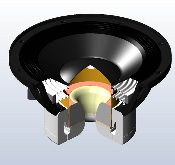

If neodymium is all that great . . .
Interesting contortions they go through to get consistent flux across the gap. Looks like a not-so-cheap fabrication. I also wonder why the pole looks so overbuilt--seems like extra steel where it's not needed.
Pretty though! :cool:

The pole is not overbuilt. This design uses a four inch voice coil with an internal 4 inch diameter neo slug. The pole size is determined by the internal hole size of the neo, large enough to give adequate venting but not so large as to loose flux. You need a lot of neo to drive enough flux over a 35mm long gap!
That's the downside of neo type motors - thick poles are required to handle the flux, and even then you can saturate the **** out of the pole. Magnets outside the voice coil are a great way to go unless you simply need to have a physically small motor.
Sorry folks, I don't think I'm communicatin' here. I'm suggesting that, for magnetic purposes, the big shoulder at the top of the pole need not be there. If a picture's worth 1k words, a quick n' dirty FEA must be worth 1001, so here you go. :)

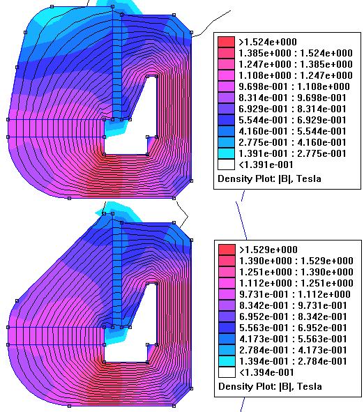

Top is the TAD motor (quite close, anyway). Bottom is same, only a couple lbs. lighter after a Dr. Bill diet. Density and distribution of B is identical.
The alteration of the pole vent profile would also serve to raise its resonance further out of the passband, I believe.

Oh, I agree from a flux standpoint - they could definitely cut some out! And a lot out from other places, too! But it often comes down to a cost-benefit analysis. Sometimes it's lower cost to keep the steel there, and not machine it out (depending upon how the tooling for the forging is worked out). Live with a few extra pounds of steel to save $15 of machining work.
Also, sometimes you want a restriction in the pole to force some air back through the gap, to induce more cooling.
Definitely overbuilt from a flux standpoint, but there may have been other mitigating factors for the actual shape.

Bill, your FEA model is not a fully accurate representation of the magnet structure. It ignores the feature that redirects the flux path to give a more even distribution along the gap.
When this is included you get a slightly different result. A lot of FEA modelling was put into this design.
In addition all the pieces are turned, not forged. As Dan noted, it makes no sense to turn off more steel than one needs to. It just adds to manufacturing cost. Also, the magnet has to be fixed to the chassis. The area that is not machined away is the mounting surface to the chassis.
The shape of the vent hole was determined from airflow considerations. The smooth shape gives less "chuffing" at large excursions. The pole vent size in combination with the air volume under the dustcap forms a helmholtz resonator, like in a reflex cabinet, that does alter the response of the driver by potentially putting a dip in the response. A smaller diameter would actually move down the resonance, just as with a reflex vent and would result in more airflow noise. As this unit is intended as a woofer only, then air flow is more important than resonance frequency of any tuning effect. ( to move up the resonance, you would have to increase the pole hole diameter, taking away magnet area, or reduced the vent length, taking away excursion)
The tuning would be worse if the voice coil former was not vented. But by venting the coil you partially short circuit the pole vent resonance thus reducing it's severity. The coil venting is arranged so that it is not choked off at large inward excursions.
As you can see, there is a lot more to the design than just the flux path to consider!
Huh? The model was just eyeballed from the TAD pic, granted. But I looked reeeal close at that picture, and It looks very close to my sketch... Where is this 'feature that redirects the flux path?' I'll add it to my models and try again if you like...
Ok by me. TAD can use as much steel as they like. Better than using too little, I guess. Mitigating factors and all... :)
Hmm. Going solely from the picture again, I believe the basket is attached to the shoulder of the top plate, not the pole. The pole is all I suggested shaving... (If the chassis was mounted to the Pole, TAD would be getting an angry call from Volt's lawyer!)
Again, I can dig it. But just to be clear, I never suggested shrinking the vent diameter...
...Or flare a significant part of its length, as I pictured...

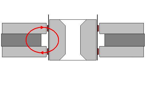

See this previous post for my quick n' dirty sketch. It's a dual-gap topology patented by HyperDynamics and licensed to Harmon. JBL calls it Differential Drive (DD). The flux flows into the pole across one gap and out across the other. The two VCs are on the same pole but they're counter-wound, effectively canceling their "pushes" against the B field, I believe.
Edit:
I attached a slightly less confusing version--stripped off the non-magnetic support structure to show the flux flow. Another nice thing about this topology is that any symmetrical flux gradients in the gaps that would otherwise yeild a tilted BL curve cancel in the integration of the two coils. Very slick.

About DD:
When you take into account the nonlinear hysteresis curve of the iron, I think it will no longer work out perfectly, but it's too late now for me to think this through in any detail.

Like you, I recognize the usefulness of Faraday rings in many motor designs, so by no means do I believe eddy currents are always your enemy.
I suppose the school of thought you choose to follow might be application dependant. In a woofer, might extensive Faraday treatment lower Qes too much for a desired bass response? (Hmm, I wonder if that's part of why JBL used alternating rings of steel and copper in the motor of the previously mentioned 1500AL--to encourage circumferential eddy currents but discourage motion-damping axial currents.)
Conversely, the ATC literature makes me wonder if the additional self-inductance they talk about might hamper treble response, if that's a design goal.
