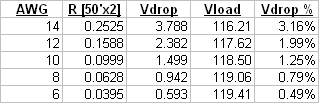

AC Wiring Losses
I did a quick calculation (not to be confused with speculation) on a 50' run of 14AWG NMD with a 120VAC source and 15A load, to compare use of larger wiring.
I could not find any EMI/RFI line filter specs with DC resistance, so who knows the voltage drop (at 60Hz). I thought it would be silly to save 0.05 ohms on your wiring and then add say 0.1 ohm with the filter.
P.S. - Jim, I hope your 12ga. stranded/litz wire meets electrical code, for insulation flammability, voltage etc. I'd hate for the inspector to have you pull it out.

It looks like (from the last post) that I need a heavier wire still to make the ~50' run across the house. Perhaps 8 ga to keep the drop less that 1%.

Bashing your head against a wall over a 1% drop is a waste of time. You'll get greater variations during the day from the utility.
