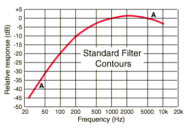

Do you know how the A-curve looks like?
Get your facts right! Hehe like you said!
http://hyperphysics.phy-astr.gsu.edu/hbase/sound/acont.html
So, 100 dBA at 20 Hz is equal to ~150 dB unweighted. I wasn't that far off hehe!
So again, I wouldn't worry much about low bass.

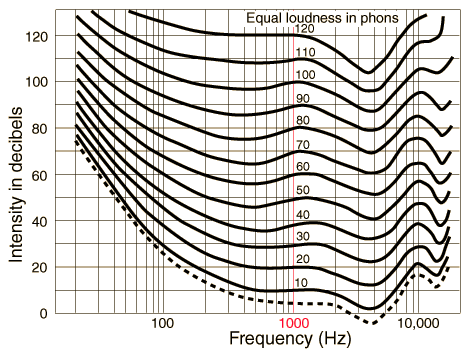

Since Fletcher and Munson curves compress when the loudness goes up, you should stay under 130 dB unweighted at 20 Hz according to those curves to stay under 100 phons ( = 100 dB @ 1 kHz ).
The A-contour filters out significantly more bass than the others, and is designed to approximate the ear at around the 40 phon level. It is very useful for eliminating inaudible low frequencies.

Oh, ok no i didn't realise the A-curve was like that... cool
Well, 130dB at 2000Hz would be really damaging!
I guess the A-curve is derived from the frequency response of the human ear.

No, I did not know the A-curve was frequency dependent you are correct.muhy3 said:Sure excessive "noise" does damage to our ears, but not to the extent you exaggerate it to be.
I was about 50 decibels too exaggerated for 20Hz sounds. At least I learnt from my mistake, thanks to simon5!
This comment is incorrect, I quoted from Australian law.Originally posted by muhy3
The published papers in Australia are done by dumbass idiot researchers looking to make a buck.
I quoted the workplace laws because they are the highest scientific authority on noise and sound pressure. Unfortunately, I did not find out about the A-weighting.Originally posted by muhy3
I/We don't want to hear your stupid talk about how it's not good in the "workplace".
If my values above refer to A-weighted noise, which is what i really meant, then the halving argument is valid. It's just that 130dB at 20Hz isn't comparable to 130dB(A) which I didn't realise. Actually, 130dB at 20Hz is around 80dB(A) which is safe for your ears for any duration. But if 135dB at 20Hz is equivalent to 85dB(A) then it is unsafe for periods of more than 8 hours, according to the equations.Originally posted by muhy3

I rethought my original idea, and I realized that it doesn't really matter how the human ear perceives sound. The fact is, loudspeakers aim to reproduce all frequencies as recorded by the sound studio. The flatter the response of a loudspeaker system the better, because any audible frequency present in a recording has an equal weighting relative to any other frequency.
The whole point of equalizing is to offset any non-linearity of drivers which accentuate some frequencies better than others. Nothing new here.
But it is interesting how the human ear works:
We have a tonotopic map of frequencies in the audio region of our cortex, ie, a certain frequency is "heard" by mechanical resonation of a particular set of sensor s in our brain. By the particular geometric layout of these sensors which evolved, we are actually performing a fourier decomposition of frequencies without knowing it! Each narrow frequency band resonates a specific set of sensors, thus we are able to distinguish different pitch of sound. It's pretty cool! I studied a little about it last semester.
It's not surprising that we are very sensitive to sound at around 1-2kHz because this is about the frequency of our voices.
