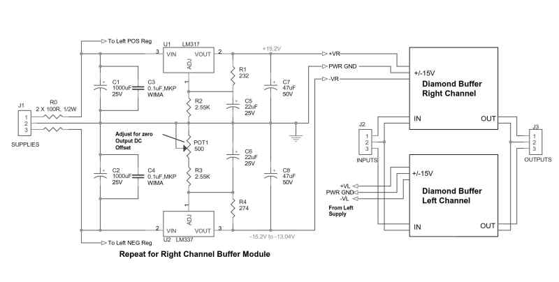

I started my new Tube DAC
Here the schematic of the carrier PCB
Algar_emi said:
I know, but since the buffer module are made by surface mount and very difficult to modify, it seems like the easiest thing to do. Anyway, it was impossible to get the exact matched pair transistors for both half of the circuit, so...
Hi Algar,
I understand. The reason I mention it is that the circuit must have low power supply rejection so requires a good power supply....
best

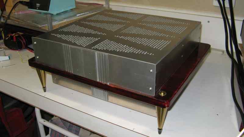

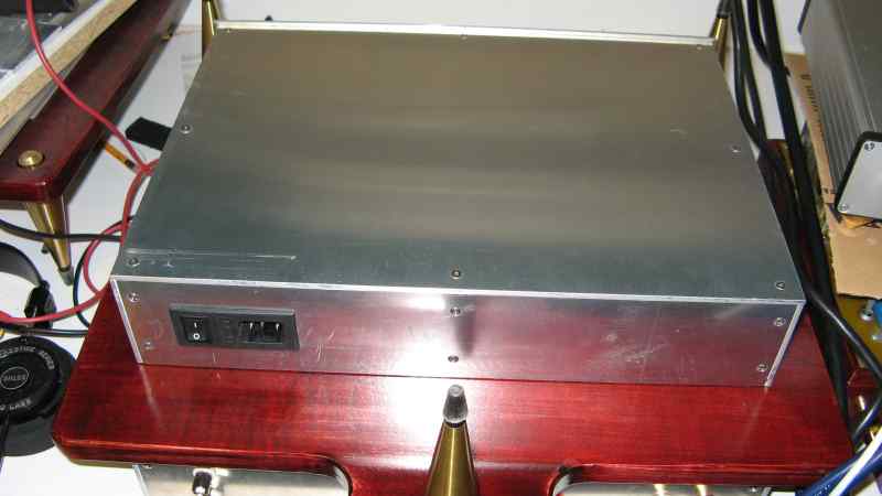

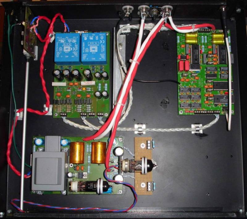

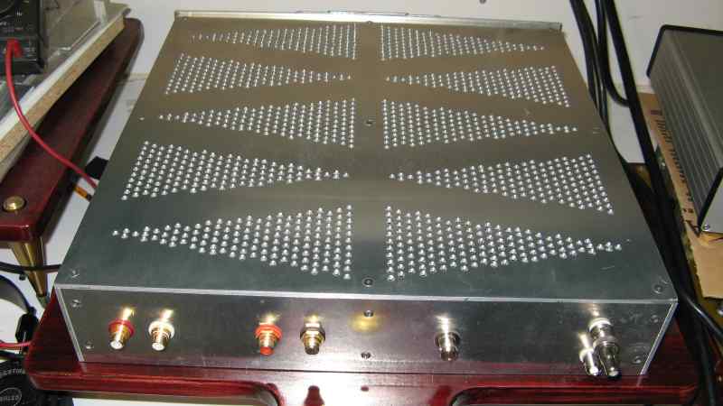

I also started this Tube DAC. I started in 2001 and I finished on november 2005. Yes, I know it's a long time. :)
But it is well worth it !! And I don't sell it too..... :)
Also thanks of my friend ( Peter Beyer ) who helped me with it.
Tubes are the Sovtek 6N1P-EV and the Brimar 6x4 smoke glass.
I can also changed the Sovtek for a SQ Philips E88CC. When I do this then I have to put 2 resitors ( 150R) out of the little PCB in front of the tube. The 6N1P-EV got a higher heater current.
