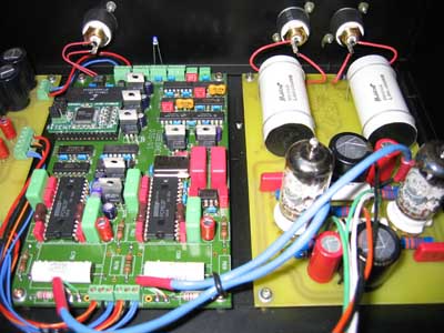

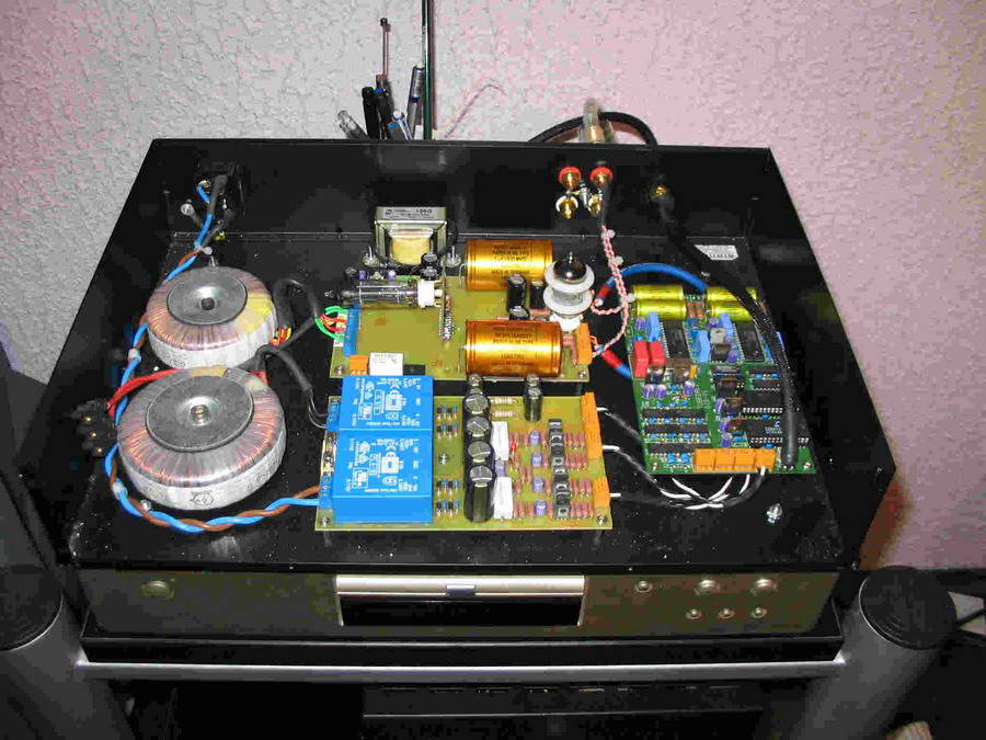

Hi guys,
My DAC is also finished. If anybody needs PCB artwork I'll be happy to share it. It sound wonderfull! Better than anything I've listened so far (well, maybe not better than AN DAC5).
I tried Svetlana 6N1P, Philips ECG 6922, russian 6N23P, Siemens E88CC... I'm extremely happy with the 6N23P. I tried Audio Note copper foil 0.47uF at the output, but I like Jensen more than Audio Note. Audio Note is more detailed, but Jensen is suited for more music genres.
Guido, thanks for all the help!

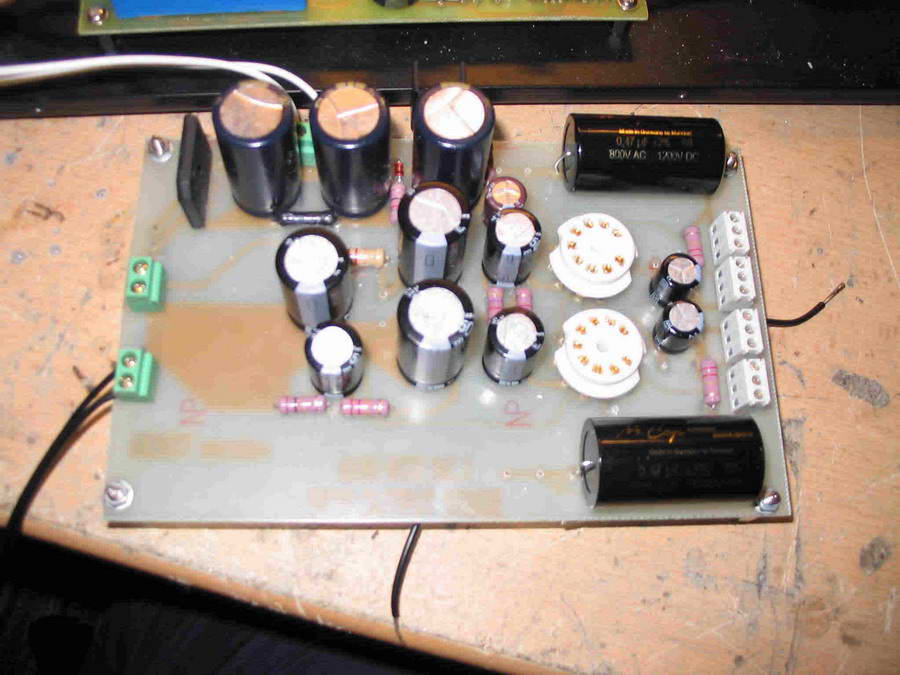

This is SRPP output stage I've been playing with. I'm playing with it mainly because my preamp (Aleph P) has very low input impedance, and SRPP has a lower output impedance and higher gain. I still didn't connect it to the DAC, due to a lack of time, but when I do I'll post my opinion here. It is the clone of Audio Note DAC 4 output stage, so I guess it can sound bad. Here I have Mundorf Supreme Silver/Gold, and I'm planning to hear them in the DAC.

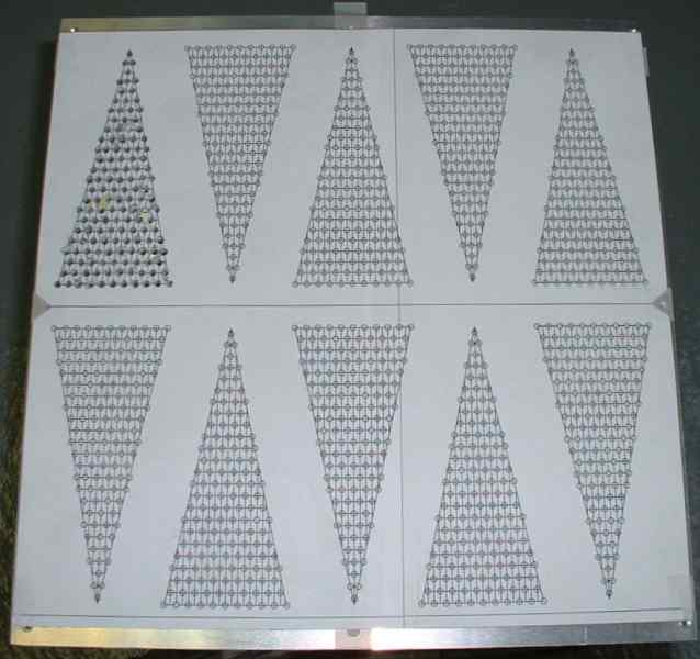

Detail of the top cover plate. After using the dac for some time, it appears that it generate a lot of heat. So I designed a neat pattern of ventilation holes. There is 10 groups of 139 holes :eek: in an arrow pattern. A lot of drilling but it will look good :) I used AutoCAD to print out the drill pattern.
Bye...

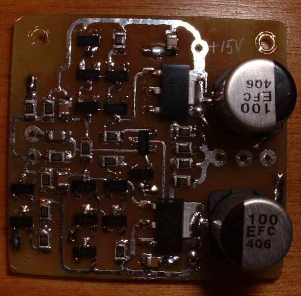

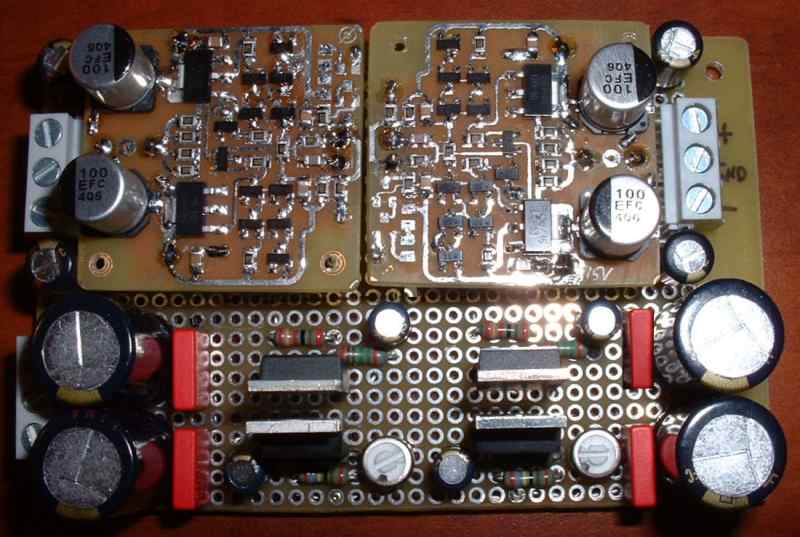

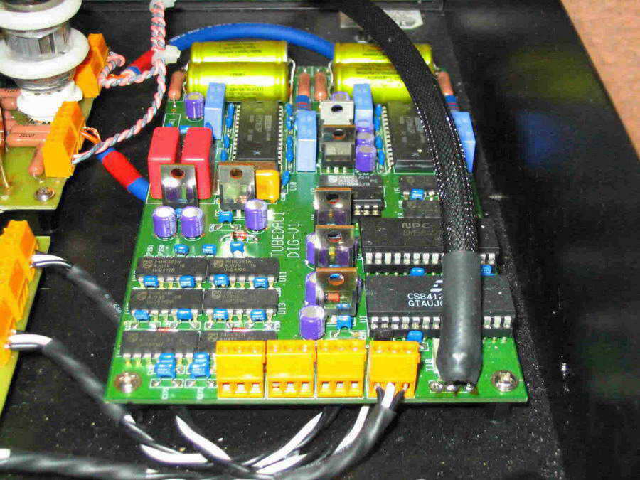

I'm about to install my version of the Diamond Buffer into ,my Tube DAC. The buffer input is the Tube Output, then a volume control (probably 50K-100K pot) will be after the buffer. So I'll have a variable output with tube sound.
I was not able to get the perfect complimentary transistors for all the buffer transistors (or maybe some needed to be matched). Since the buffer is DC coupled, it caused a small DC offset at the output. To solve this problem I built a daughter PCB where the buffer PCB plugin. The separate LM317/337 regulators supply the buffer at +/-15V. I'm using the +/-25V aux. supply of the DAC supply. If I fine tune the negative supply I can tune out the DC offset. So I installed pot on the LM337 regulators. Now I have an other set of dual mono regulators inside the DAC ;)
Here the image, all point-to-point again.
I tested the Diamond buffer and the specs are outstanding. I won't be supprised the sound will be very good indeed :D
Here the measured specs:
Gain (1V, 1Khz): 1 or 0dB
Distorsion (Ref 1V, 1Khz):
THD(%) IMD(%)
100Hz 0.022 0.020
1Khz 0.015 0.016 (1st harm: -84dB, 2nd: -80dB)
10Khz 0.013 0.017
Freq Response: 10Hz to 20Khz, within 0.1dB
Vmax Tested:
3Vrms, dist: 0.045%
Output DC Offset: Can be adjusted to <1mv dc
