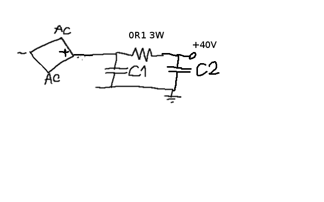

I don't understand what do you mean by "near". They are very close to each other, 2cm of wire.
Physically they might be very close to each other. We are referring to what the amplifier sees at the output of the PSU.
Use the cheaper caps as the raw smoothing caps at the output of the rectifier. The better caps are then separated by a small resistance CRC, the better caps provide a low impedance output to drive the amplifier.
Even without the R, the better caps provide a low impedance source for the amplifier.

Thank you, I think I have it, it's Rectifire+ to Cap1 and to 0.1R, 0.1R to Cap 2 and to + output.The better caps are then separated by a small resistance CRC, the better caps provide a low impedance output to drive the amplifier.

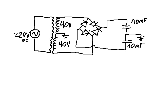

Thank you so much for your reply.40 x 1.41 is 56 volt.
The cap charges at peak voltage minus one diode drop.
Vrms x √2 - Vd
Usually, one takes Vs=0.7 but here, it is smaller because of no load but the cap current leak.
Australia mains is 240V, France is 230V but they keep naming it 220V as it used to be.
Mains voltage is +/- 5%.
40V transformers don't care about these details.
So let me get this straight, the ac in the secondary should be 43V (since the mains is 236V ac and the trans is rated 220-40), but the dc output of the rectifier measures 62dc. Why does rms comes into play suddenly? This is confusing and frustrating especially because the rating of the amp is in DC and 62Vdc is so close to the required V up to around 58-60V max....
Another issue is what kind of measurement my meter makes in a non pure dc voltage... probably not true rms on the caps.
I also added two 10k resistor for loads and it didn't change the voltages.
