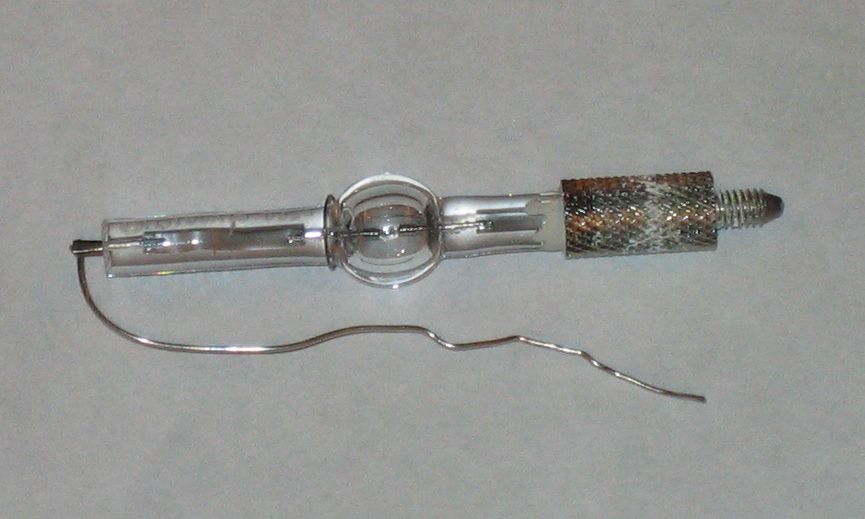

Hi Eucyblues
dont bother the knurled metal end , you can manage it I think,
I found the LP350 reflector, but the perfect reflector is not cheaper , need $60, this pirce is without cage.
the Crackle reflector is cheaper, $ 30, the Crackle is outside, specular inside is perfect.
but your original reflector is like this too, I think you can manage your original reflector if you got my cement.

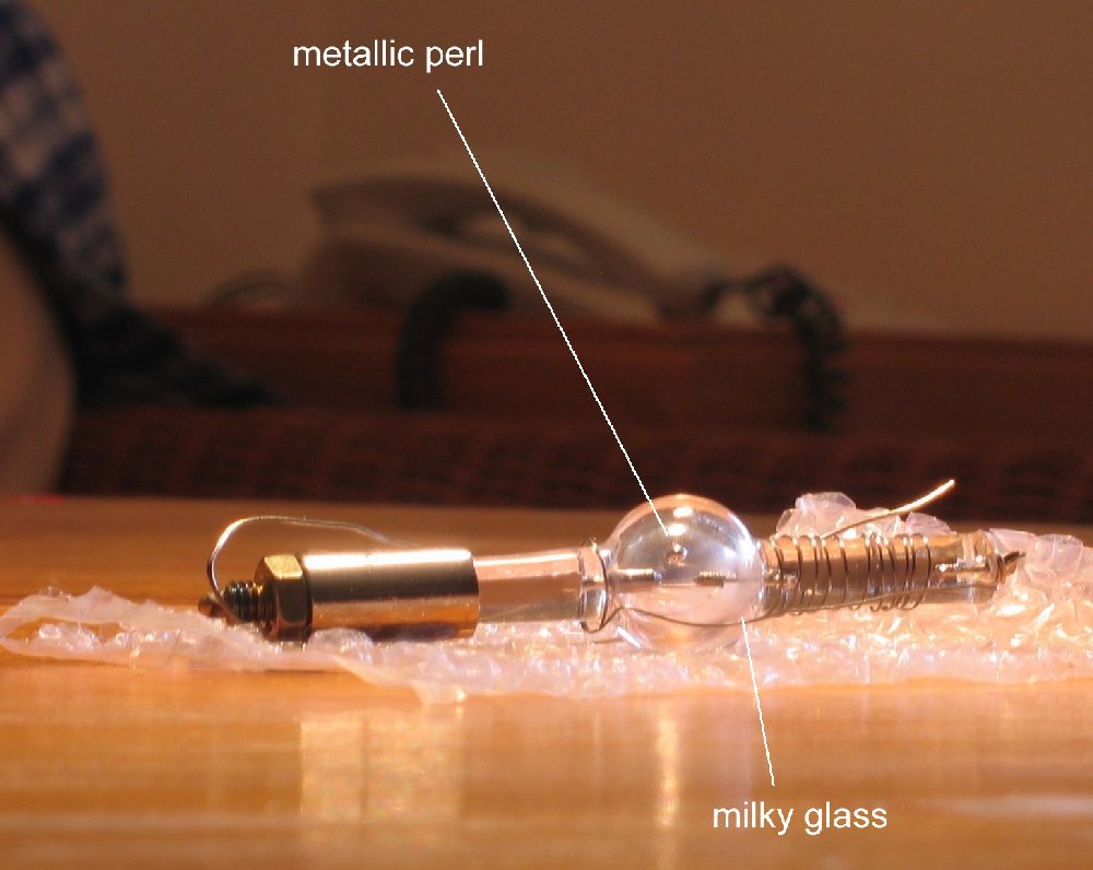

Hi ywh,
it's the first time I try to post in a forum - but lets try.
I ordered and already got from you the JYd275/D.C. for my Infocus LP350 because measuring the power supply of my LP350 I found out that voltage is increased in steps up to 75 V DC (not AC like in pdf list) and current starts with someting above 4 amps and goes down to 3.6.
You mentioned to Eucyblues that
Infocus LP350 need JYS/DC 270W .
But there are two LP350 versions -
the original LP350 and an upgraded version
after initial lamp problems.
Unfortunately I got the original and upgrade is
no longer offered.
Infocus name for non-upgraded is SP-LAMP-LP3E,
for upgraded power-supply projectors SP-LAMP-LP3F
I didn't try the new lamp until now - also because I'm not sure if that lamp is ok (little milky glass - see picture).
I tried to send an e-mail also.
Maybe you can give me some hints,
Thanks,
fly2max

Hi fly2max !
some inf of the pdf list is wrong, but I can not delet it now.
yes! it is a DC lamp,you need DC lamp to replace SHP. there is a biger electrode in the bulb.270w SHP is OK! dont bother LP3E or LP3F.
little milky glass is metal halide, and a little mercury

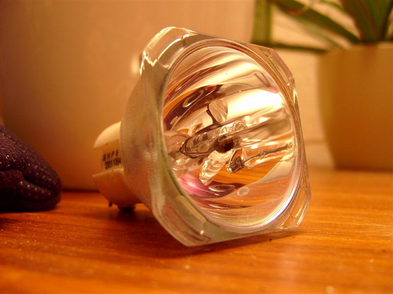

Hi ciscoopa !
the bulb of your pic is not metal halide lamp, 100%
here said it is metal halide lamp, I dont believe this web.
http://www.projectorcentral.com/Sharp_PG_Series-Notevision4_(XG-NV4SU).htm
your bulb is UHP,I believe your practical bulb.
you need JYD/AC, $60 each, shipping is 5$.

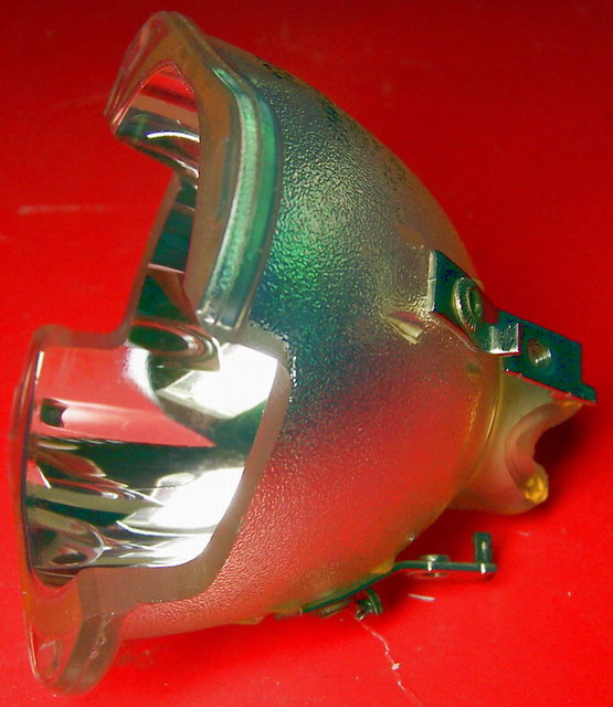

Hi FRIDAY
Mitsubishi LVP-X70UX lamp is SHP 150W,it is a DC lamp, there is a biger electrode in the bulb, but JYd150/AC is AC lamp, has no biger electrode, so BURNED INTERNAL CONNECTION TO ONE ELECTRODE,the biger electrode is +,stronger.
dont try your luck on one more JYd150/AC pleace,that is SHP.
I have bran-new SHP bulb, it is perfect, from bran-new lamp assembly.
the pic is bran-new SHP bulb
from bran-new lamp kit, I pull the bulb out
this is new SHP lamp, work without any problems,
3000hrs !
this type reflector can not be used,I have to use the bulb only.
