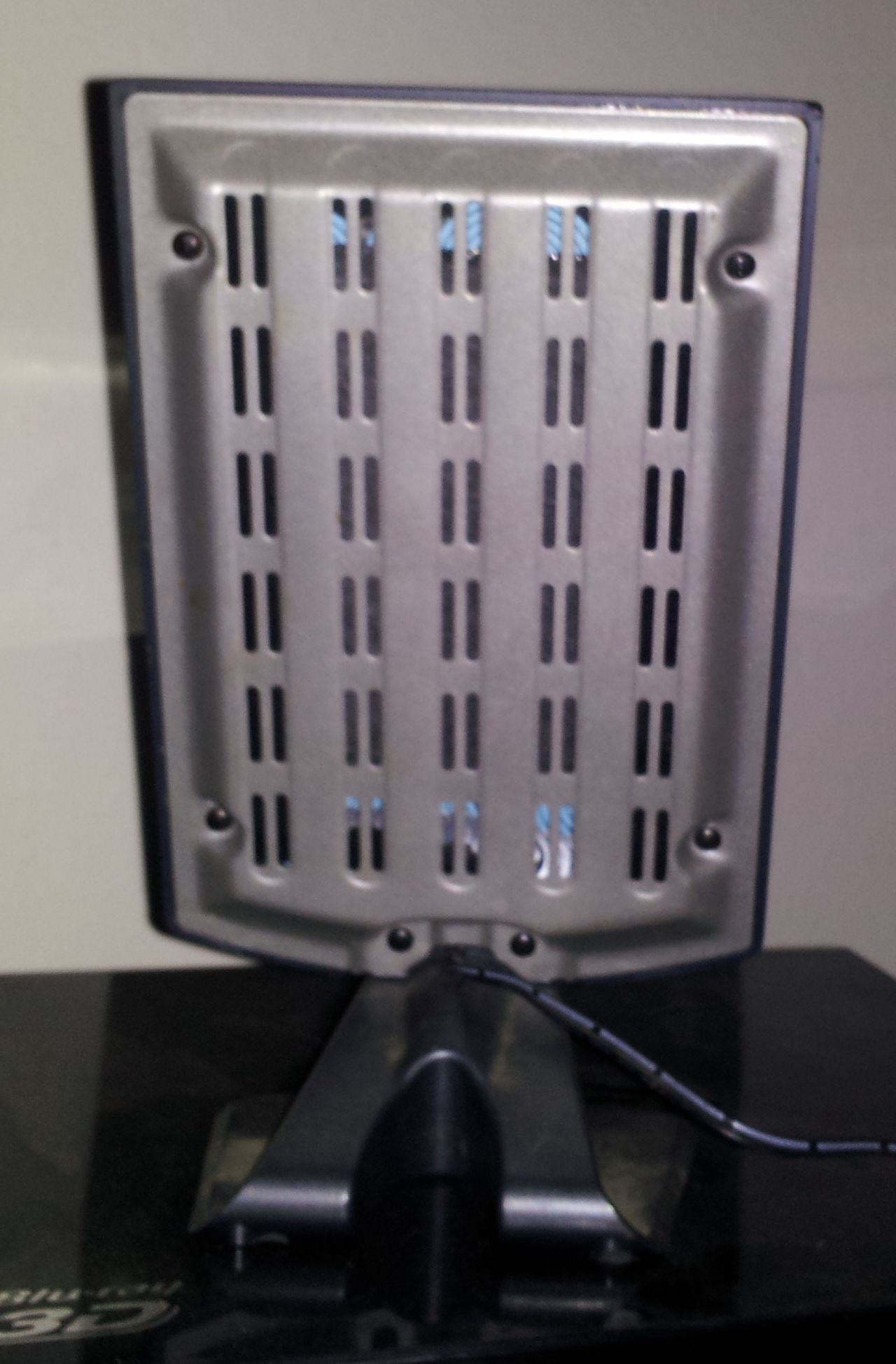

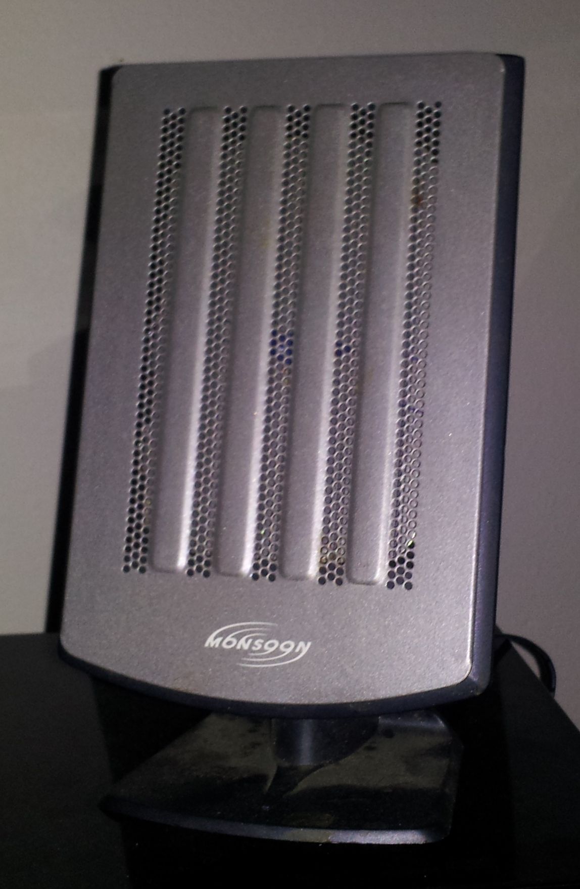

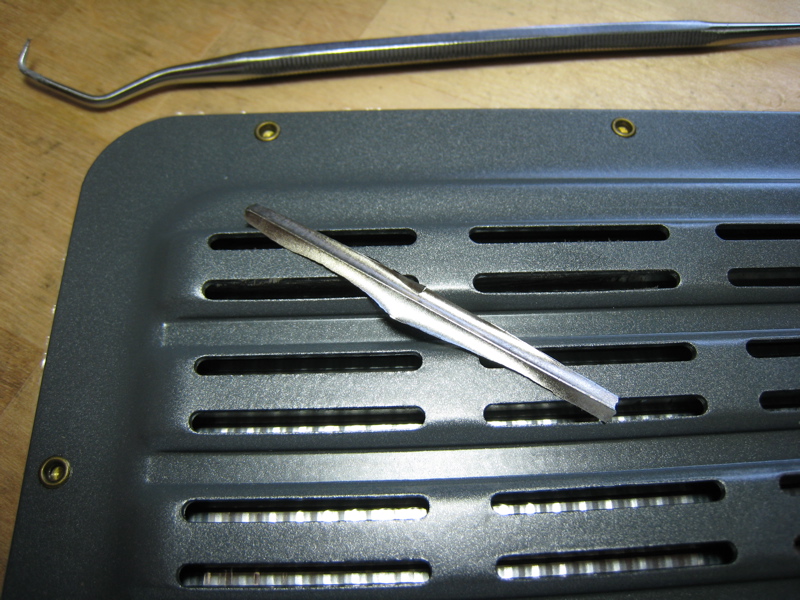

The nickel plating on mine continues to flake off. Worse: the remaining 'grit' stuck inside is making them buzz again despite my best efforts. I will try to use a small vacuum cleaner nozzle next time I take the grills off. If that doesn't work, then these may have reached the end of their life...
Here's a picture I took of one that was too far gone to be salvaged.
You can see it would be difficult to clean fully w/o opening it up, and even if you fixed the buzz how long would it be until: A) you have to do it again, B) a magnet shifts out of place?

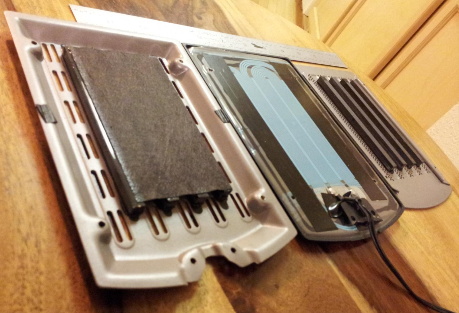

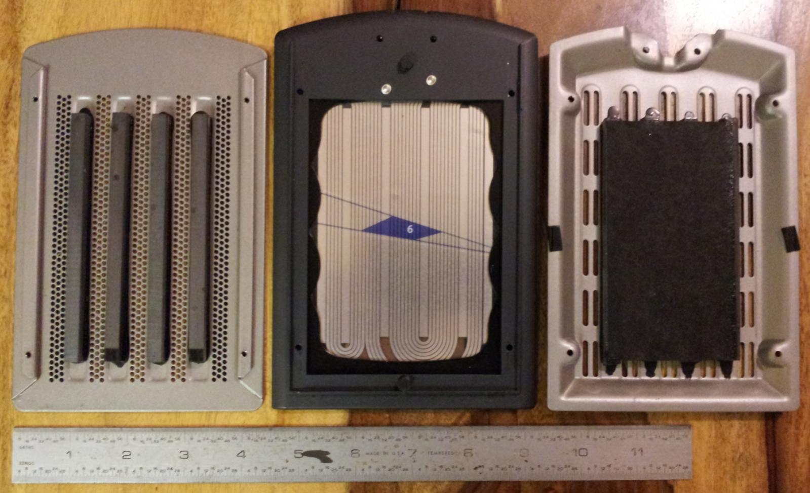

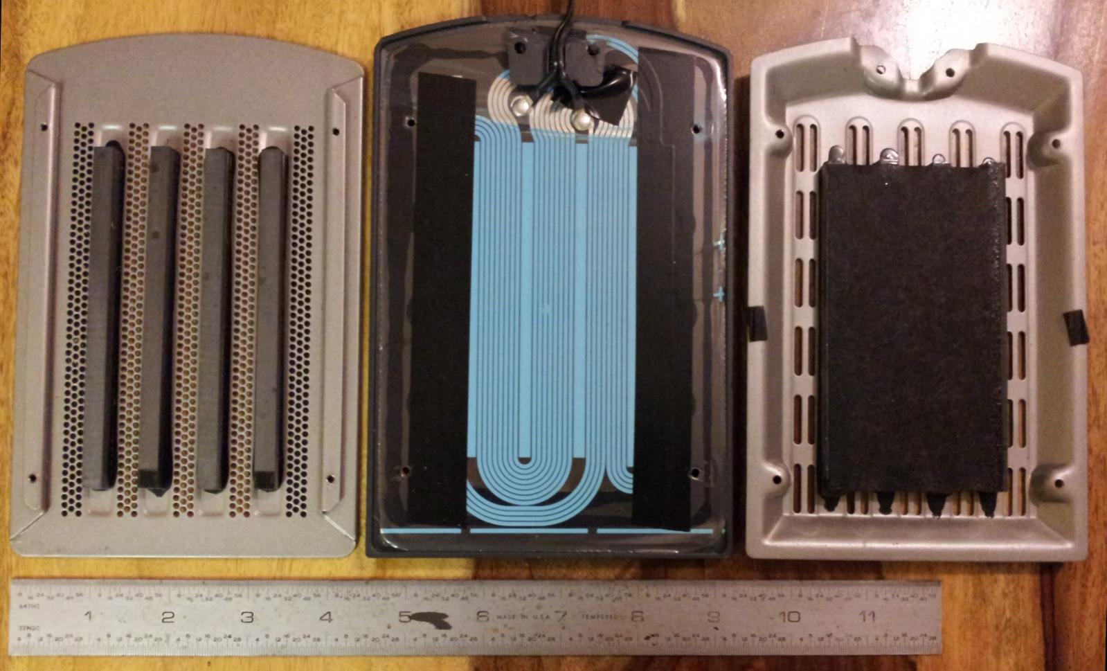

You may actually be right, Andersonix. Taking a closer look at things, it appears the damping cloth that they glue to the magnets is just inside the rear grill. Also, the traces don't look the same to me:
MM-???
Very odd looking circuit to me, specifically the bottom. Also, there's no discernable pleating.
MM-700 with horrible buzz, the first MM-700 I took apart.
Notice the pleating and squarish tines to the serpentine (sigma) layout.
No pleats, wider and shorter then the MM-700-1000's. Have an excellent response from 200Hz (requires wider baffle to do this well tho) to 10k or so. Diaphragm width dictated a cross at 5k before beaming sets in.
Last time I'll do this til another project requires the need. Want 2 more for an MTM dipole setup with an AMT. When opening the magnets repel and slide to the side so care must be taken. The unbound edge crinkling creeps me out thinking you're tearing it to shreds. They are fine drivers for sure, perhaps build them into my Lazyboy on adjustable arcing poles extending out a meter, with a sub in the base, dunno, it's a thought ;)

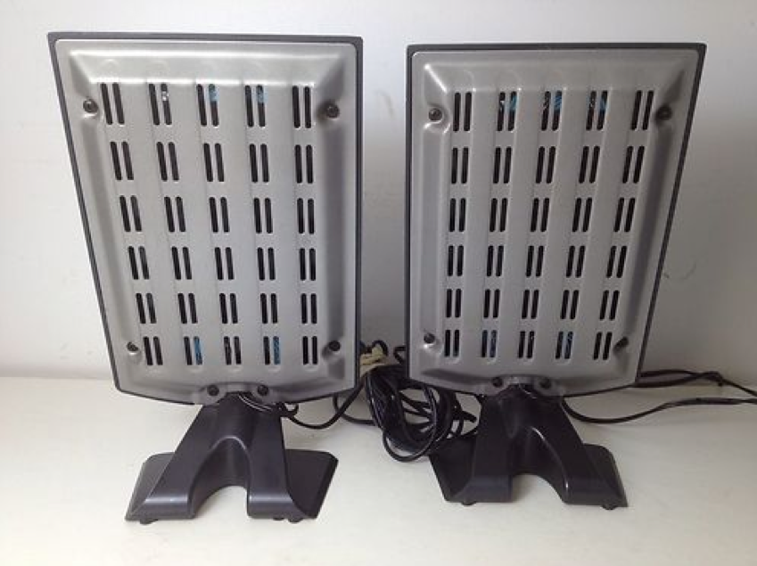

Nope, not bidding, knee deep in another project atm. Tho was offered to buy a full PM-9 setup by a member back last December, new in box for $150+50 to ship. He had bought his the same time as I when eBay was littered with them for $50. They retailed for $100. Several others here have them, some of the best nearfield computer desktop speakers made IMHO
