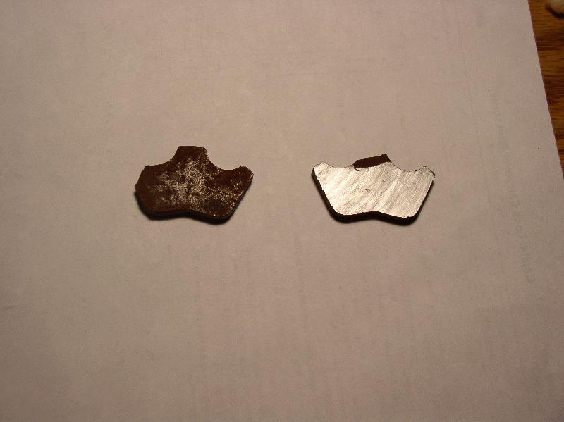

I just discovered this manufacturing problem in the main panels: There is a plating on the bar magnets which partially peels loose and causes a buzz.
A couple of days ago, I persuaded a friend to sell me his MM-1000, and while dusting and running a 200-300Hz tone through them heard an annoying buzz from both. (I had heard the buzz earlier while playing music: Israel Kamakawiwo'ole's 'It's a Beautiful World' is perfect for exciting this buzz.) Wondering if it was a track that had come loose from the diaphragm or something, I began poking through the rear slots (with the rounded end of a small plastic tie wrap so that I didn't damage the diaphragm) and discovered that the magnets have a plating which had begun to peel and separate from the magnets, and this partially loose piece of plating was now vibrating in the gap. Each unit oddly had only one area which was separating, and it was actually visible through the slots in the rear once I realized what I was looking at. (You can't see anything from the front as there's a sheet of black felt between the diaphragm and stators.) With a lot of patience and some bent wire ties of different sizes (I bent the end of the wire ties into an L, so that I could actually scrape the far side of the magnet facing the diaphragm.) and a pair of tweezers I was able to push, scrape, drag, and pull out the offending pieces of plating, and now the speakers sound good again.
peeling plating

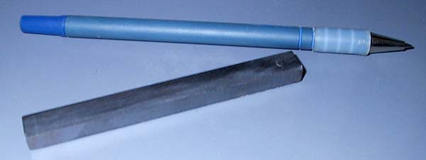

poor picture of a tweeter magnet.
dave
Joined 2004
Dave, the magnets in my MM-1000 are thinner (I estimate 5 mm) and shinier (from the plating) than in your 'poor picture.'

At the time I had them apart, I should have taken some pictures to fully document my repair:
It involved first making a hook from some sheet steel to pull apart the barbed clips holding the front and rear grills together. Then covering the panels in a bag to keep out the steel chips while I drilled out the rivets holding on the base. To make them more easy to disassemble in the future, I made a small triangular plate with threaded holes for screws to replace the three rivets. (I think it becomes obvious what I did if you examine an MM-1000.)
