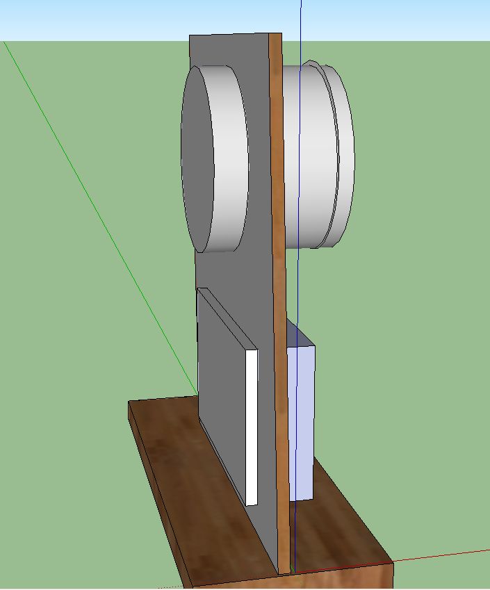

For those who have already an Ncore with connectors: do you think it is possible to fit it into a tube with an internal diameter of 10cm; not centered necessarily and it is not necessary to plug the connectors at the end but I would them connect right from the beginning before fitting the module onto the plate. Hope I'm clear, my fear is that the connector and cables which part sideway make the module "wider" than 10 cm.
Thanks.
Thanks.
Gets pretty tight. You would have to have the leads do a very tight bend.
Thanks;
Alternative is to bend leads doward a little bit towards the plate and go out "below" the tube which ends 2.1 cm above the amp base (not sure I am clear).
The connector end more or less 2.3cm above the amp base ?
As far as I can measure, yes.
@ jmbulg: I also looked at that. You are looking at 101.6mm pipe, no? I found the SMPS600 to be more of a problem. See attached quick CAD drawing. That is the SMPS600 on 5mm stand-offs (45mm high). The problem you have here is that you still need a base, and then there are the stand-off's leads (if you screw them in from the top). A thin plate with screws from the bottom is probably an easier alternative. Still very tight and you'll probably have to insulate the inner of the tube to make it "safe". Regarding the NC400 itself, I don't think that is an issue. If you bend the wires down like you've mentioned I think it should fit quite easily (given that the connectors are assembled before moving it into the tube).
I will put the SMPS600 in a separate box. Will try to prepare a sketch of what I plan (not very usual and maybe too fancy)

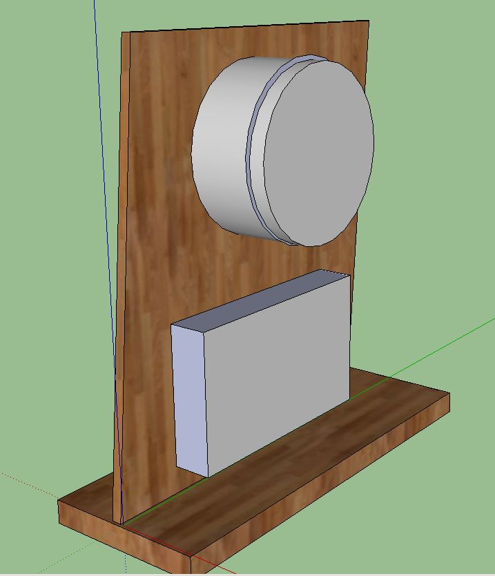

Ok, so here is my plan.
Ncore in a tube
SMPS in a box
both across a wood (see wood color on one side),
mounted on a thick aluminium plate (other side)
and finished by some decorative "recall" of the other side (round heatsink in front of ncore and thick plate in front of SMPS box).
Cables in the wooden plat and then out at the end of the wooden base, nothing visible.
Plate slighty inclined towards the back to recall my audiophysics speakers ...
Ncore in a tube
SMPS in a box
Well also SWMBO needs to like itthat is... different but at the same time I would not want it in my living room
but you're the only one who needs to like it.
