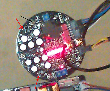

So, all lights but no sound. Is it switching at all? Check by measuring DC offset with and without load. Without load and no switching the output wanders off a bit because output impedance becomes high.
Can you do a quick check of the supply voltage, say between a screw and the two pins marked with a red arrow.
DC offset without load is 1,39V.
DC offset with load is 2,2mV.
The supply voltage is 66.5V.
