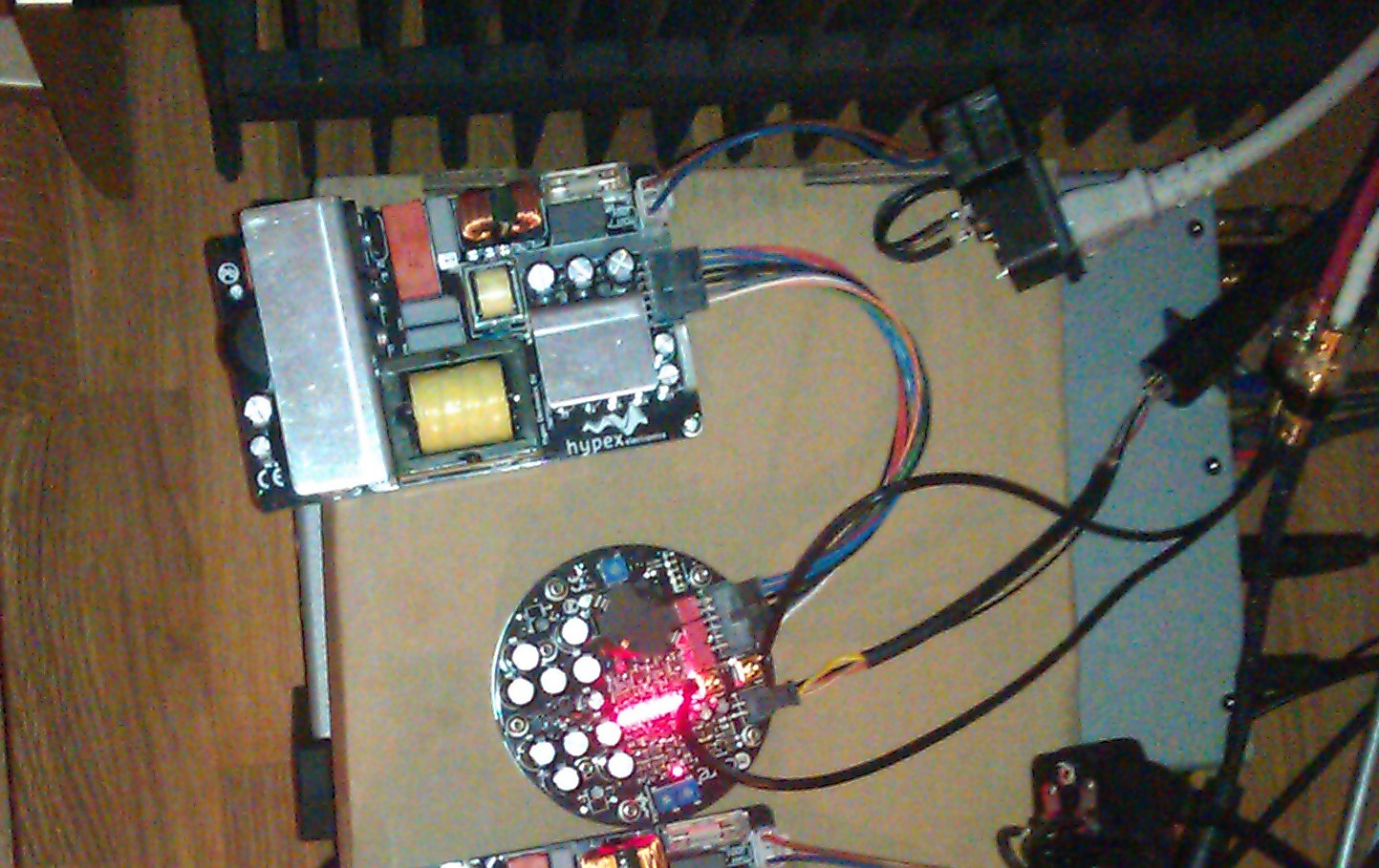

I get home from vacation, hook the nc400s up and they won't amplify the signal. Looks like plug and play can be hard sometimes.
Did you connect the separate black wire to ground? Otherwise -> photo
nAMPON is connected to pin 1 xlr, I guess that should work?

Here is a bad photo, but I think you can see everything.
