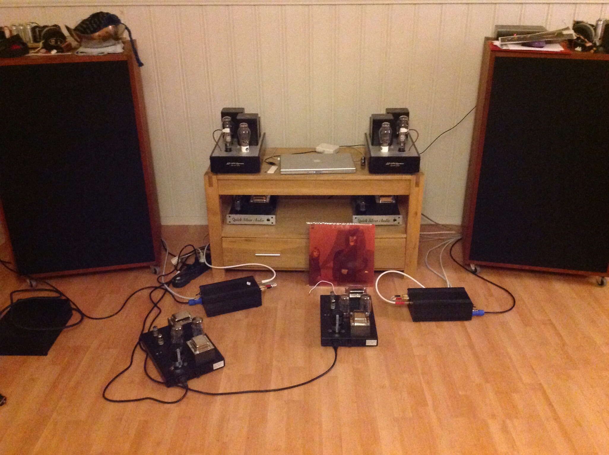

Tested them on music now and the sound was sublime. Maybe I have never heard the mono blocks as they should sound, before. :)
nCore 400 blocks doing a good job. The valves awaiting their turn :)
Agree :) Once I got the crossovers sortet the Altecs play a lot better than many new speakers. The hypexes and push-pull kt88s fit the Altecs well, even if they are 98-99db they need powerful amps. The triode amps (300b) have their force on relatively simple music, like late night jazz and vocal music.
Locomotive breath with the hypexes on full blast is a religious experience :)
