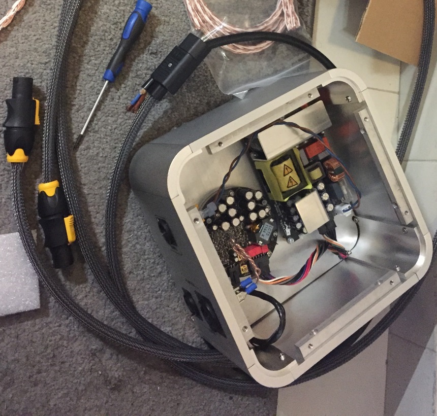

Santa gave me strength to get off my lazy butt and give my Ncores a proper home.
It's been almost 3 years since I organized a group buy to get my hands on these enclosures, but better late than never I guess.
Internal layout is temporary, as these enclosures will, eventually, hold one more module each (to have a set of 2-channel amps, with one SMPS each), but I decided not to procrastinate any further and get on with it.
Got fed up with that DVD player cover I was using as a temporary "enclosure".

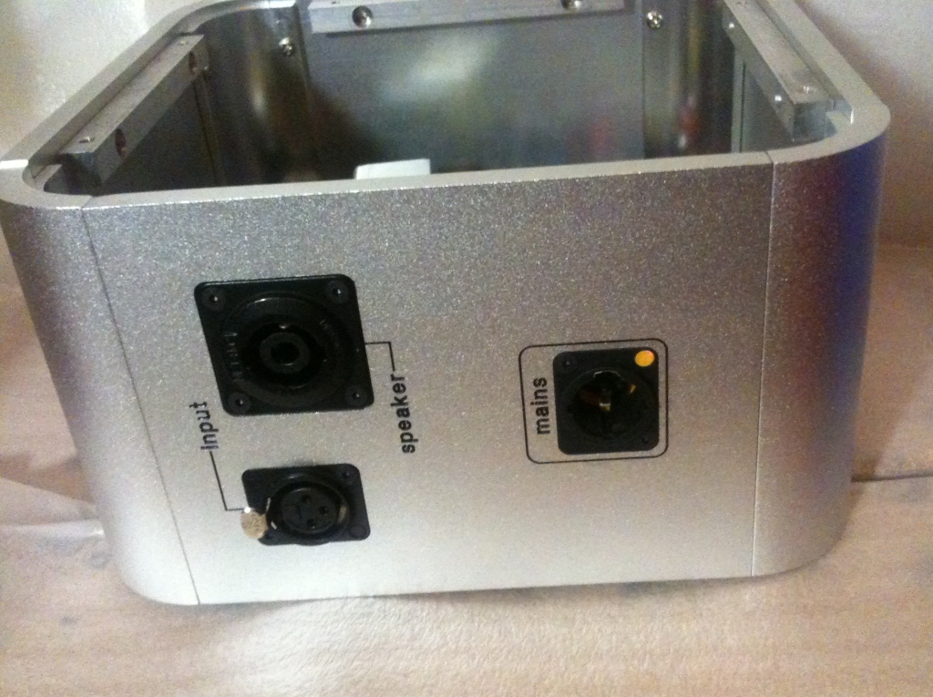

Thanks for the comments guys.
On my previous post (#7841) I have a link to the group buy thread.
This was a custom-sized enclosure that we decided upon (thus the need to buy more pieces), but the vendor typically stocks other sizes with the same looks.
There should still be the option to order custom ones, though you may have to reach a certain MOQ.
Back panels were sent to Schaeffer for milling.
I might send other parts of the enclosure too (side panels for vents, front to add some sort of indication), but I kinda like this minimalist look.
