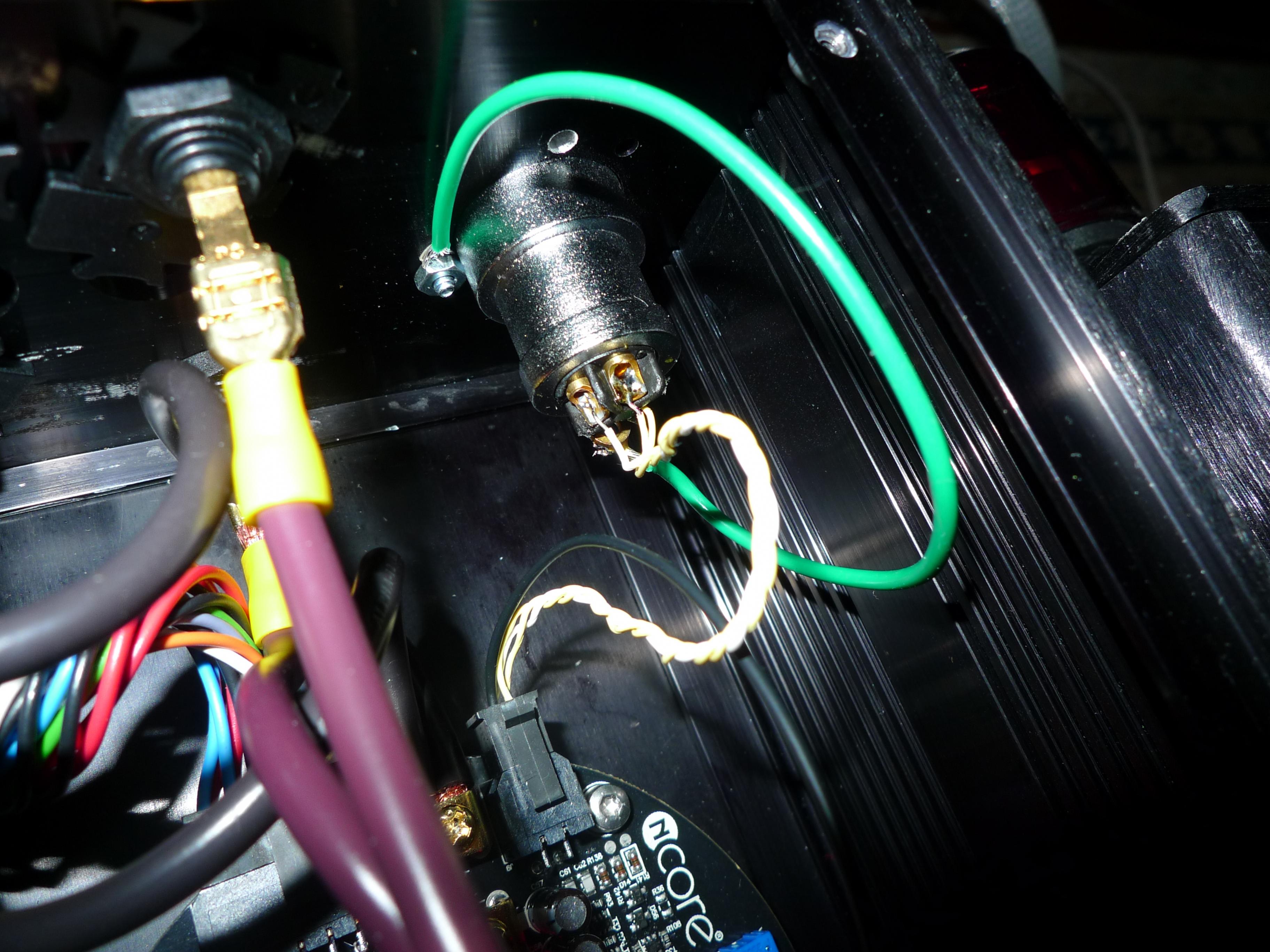

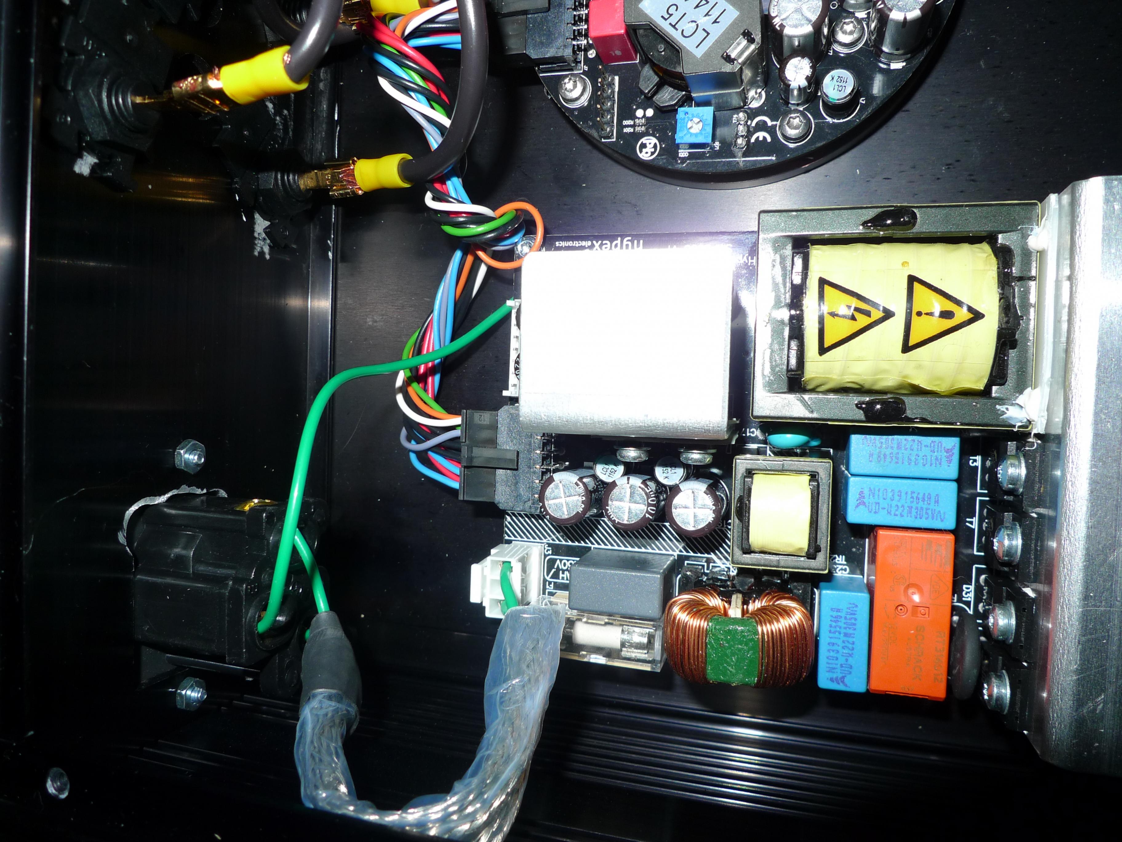

A little help.
So I finally was able to build my amps and sadly, they are not working! I am sure I did something, but any suggestions would help. First, are ALL the red LEDS supposed to light up? I am taking the fact that they have lit up, as there is power to the amps? Is this accurate? My other question is on the power button. I have opted not to have one. If I read the directions correctly, if you don't add a power button, the amps will just go into sleep mode when idle? Thus, I did nothing with the NAPON cable. Am I correct here? Finally, I made my own XLR cable. On the directions, they say to take the the shield wire and ground to the chassis and then ground pin one to the chassis. I took my shield wire and connected this to the pin 1 and then grounded the XLR connection I am using, via the supplied ground connection. Any reason this would not work? I am attaching some pics. I know its not pretty, but there are a lot of FIRSTS for me in this little box!
Chris
Any help would be greatly appreciated.
The nAMPON needs to be connected to ground to enable the amp.
AHH, I knew it was something this simple. Back to lair..
Quick question. I had the NAPON connected to the one metal leg of the power supply, mainly becuase I saw someone else do it that way.. and it still does not work? Should I be using the ground on the XLR?
THanks
