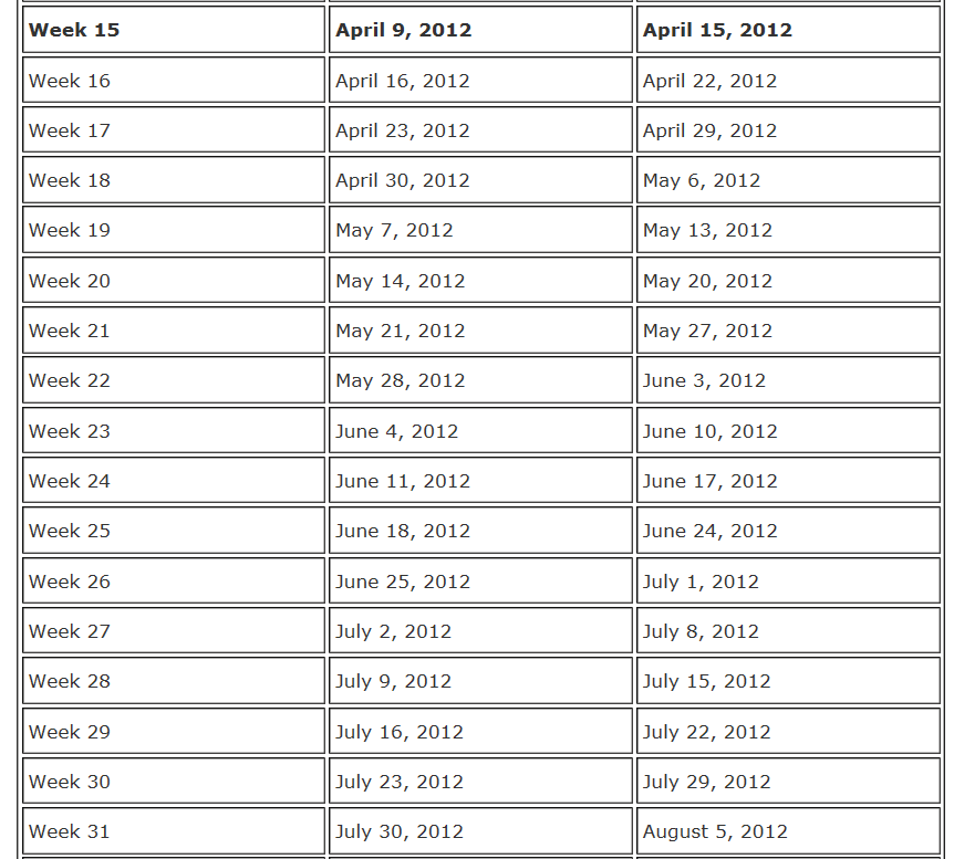

It's week 18, isn't it. Can someone from Hypex confirm that they will be shipped soon?
Two months since I placed my order. Long time to wait.
I need a calendar that shows me weeks as well.
Hey, I'm just trying to help.
