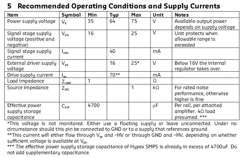

Do we have an estimate of current requirements from the aux supply?
Would ~250mA per rail be adequate?
Nevermind, it's actully in the datasheet.
