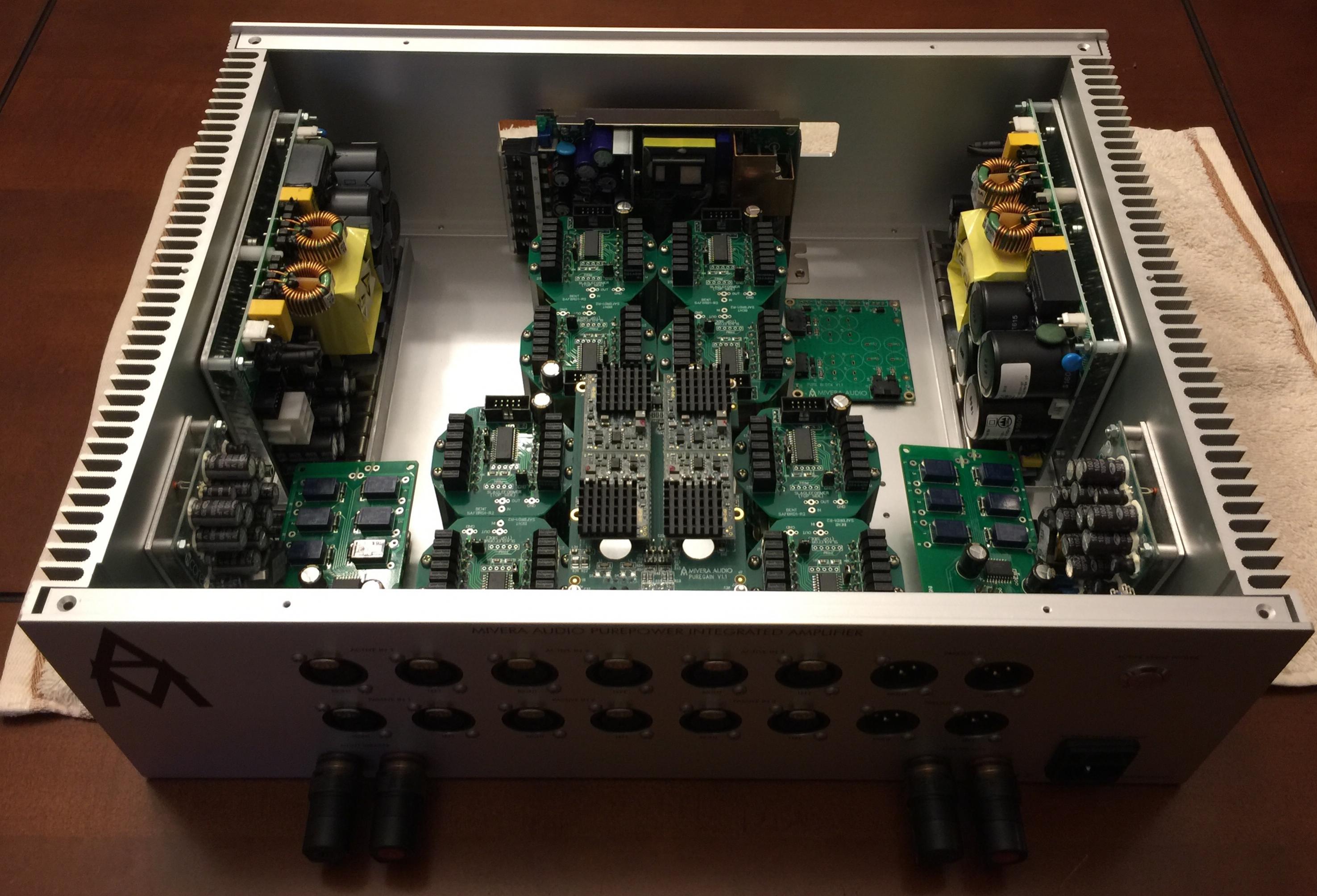

The real limitation is not being able to bypass the buffer. You can always add a buffer of any grade if there's no buffer or option to bypass the on-board buffer. It would be nice to see all of the all in 1 integrated amps (PS and amp on 1 board) with a header pin buffer bypass jumper.
When I asked Hypex if there was a way to bypass the buffer on the MP series, they said "no, you don't need to because the opamps and regulators are of the highest standard already"
I guess that means they think the NE5532 is better than the discrete buffer in the Mola Mola Kaluga
The new HSR discrete regulators look pretty fancy though. Wish I could give this thing a listen.
What are those extra stacked boards on both sides?
Those are SOTA remote controllable AVC volume controls. "Slagleformer's". Widely known as the best AVC volume controls on the planet. Nobody makes a better AVC than Dave Slagle.

For fully balanced you need 4 of them. They charge double for their balanced version. Our NC-500 buffer is similar to the balanced Preda, only they use through-hole gain stages with the Slagleformer's, and we use the Weiss OP2-BP SMT based gain stages together with the Slagleformers.

Transformers are always somewhat problematic in terms of linearity and bandwidth. Do you have any measurements?
Dynamic range is better than 120dB. As long as you don't feed them any DC, they measure great. The way they increase current and lower output impedance as they attenuate, seems to be the biggest advantage. I've yet to hear anything close. Which is why I'm willing to spend several times more compared to the next best option for them.
Rough layout of my big custom Purepower
Not sure I see the advantage - don't you need the lower output impedance at higher signal levels?
Rather than ******* the current away as heat, they increase current and lower output impedance as you attenuate. If anything more current and lower output impedance is more desirable at lower levels. However at unity gain our gain stage has a 10 ohm output impedance, and can sink/source 60mA running in pure class A, while meeting the specs on the Weiss OP2-BP datasheet.
