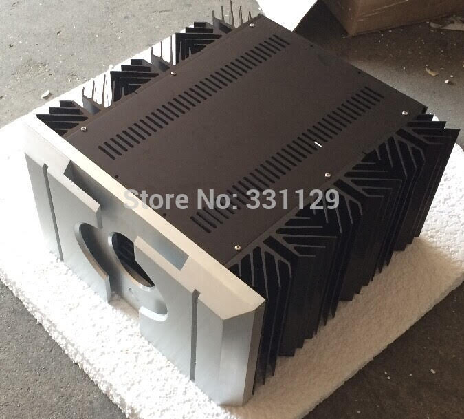

Ill email him, cheers for that, I bought some Chinese cases in, they were very good, again one of the decisions in choosing Modu was lead time, consistency, same case in multiple sizes, spare parts and cost. I've had 20 cases arrive in about a weeks lead time, I changed the order from steel covers to ally so I could machine them easier, no problem 4-5 days later they arrive on a pallet.
This guy is very good. And fast. Talk to Yang Wang. He speaks very clear english.
Here's a Pass labs knockoff he did just so you know his capabilities.
For Boggit
http://www.whatsbestforum.com/attachment.php?attachmentid=18371&stc=1&d=1420144889
...that sort of design I was thinking of, which I think looks more modern (just remove/wish-away the cylindrical looking glass)
Beveled edges and single line in the center, right up to the little power button...lovely
