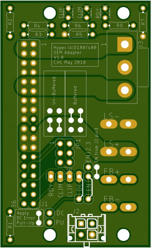

Well I think I figured out how to make use of the 'clipping', 'current limiting' and 'amplifier ready' pins. I think these schematics show what needs to be done to make them light up some LEDs, so I'm thinking I might put the corresponding LEDs on my adapter board. Ultimately I think I'd like to have one LED for each condition on the amplifier faceplate, but the schematic for that can be a job for another day.
I also added an option to use a pre-installed pull-up resistor for the 'DC Error' pin, as instructed in the UcD400OEM documentation. I'm not sure if I can tie all 6 DC Error pins together *after* they are individually pulled up, so while I figure that out I've added an option to disconnect the pull-up resistor by removing a jumper.
Here are my schematics - resistor values still to be calculated depending on the LEDs I choose.
Feel free to point out the obvious blunders!
And here's my current draft of the PCB.

My sums for for those resistors. It would be good if someone was able to check my interpretation of the way these pins operate, and also my calculations.
Clipping Detection:
An open collector, that gets pulled low when there's clipping. I have to pull it to a positive voltage, max 65V, with a pull-up resistor, keeping the current below 100mA. That maximum of 65V suggests it may have been designed to be pulled up to the voltage of the SMPSXXXA400, i.e. 63V. So if I make R2 a 100K pull-up resistor, the current will be only 0.6mA, and the resistor has to cope with 40mW. Easy.
If I want to drive an LED from this pin, then that 63V supply needs care. A typical LED will drop 2-3V, so R1 has to drop around 60V, and unless I choose a low current LED then the power requirement for R1 will be quite high. So I could use a 2V, 10mA LED, which means I need R1 to be (63-2)/0.01 = 6k1. So if I use a 6K2 resistor, the power requirement is 61^2/6200 = around 0.6W. So a 1W, 6k2 resistor seems ok.
Current limiting:
This one is different. It's internally pulled-up, and goes low in the event of an error. If I'm reading the provided circuit diagram correctly, then it's limited to 5.6V under normal conditions, but drops to -VB (-63V) when there's an error. So R3 needs to do the same job as R1 if I want to light an LED when this pin goes low. So with another 2V, 10mA LED I need the same 1W, 6k2 resistor here.
Amp Ready:
This is different again. It's internally pulled up when there's an error. I think the diode in the circuit diagram limits the high voltage to 5.6V. Since it's named 'Amplifier Ready', rather than 'Amplifier Error', I think the idea is that it could drive an LED when everything is OK, but turn it off when there's an error. So in that respect it's a similar circuit to 'current limiting' above. I need the LED to be on when the pin is at -VB (-63), but off when the pin goes high to 5.6V. So in fact it's the same circuit as the current limiting circuit, meaning R4 is the same 1W, 6k2, and the LED is also 2V, 10mA.
DC Error:
There's no point in having an LED here since the point of this pin is to turn off the power supply ASAP, which means there'd be nothing to drive an LED. It's an open collector which goes low when there's an error, so all I need to do is pull it high so that the power supply doesn't randomly switch off due to a floating voltage which might be interpreted as 'low'. I'd like to provide a suitable pull-up resistor on my adapter board, but I also want the possibility to tie together all these pins from multiple amplifier channels, since there's only one 'DC Error' input to the SMPS. If I didn't have an on-board pull-up resistor I think I could tie them all together and pull them all up with a single resistor. So I *think* my on-board pull-up resistor needs to have a high value so that one channel going low pulls all the tied pins low and triggers the SMPS to shut down. In other words, the combined resistance of, say, 6 of these on-board pull-up resistors in parallel needs to be no less than what a suitable value would be for a single channel. I've read that 10k-20k would be ok if there was only one channel, so I *think* that means 100k on each board would sum up to be less than 10k even with 10 channels, so the tied together outputs would still go low if only one of the amplifier channels experienced a DC fault. I'm a bit unsure about this point (hence the jumper on my PCB), so would appreciate some expert advice.
In fact, I'm quite unsure about all of this, so once again, please feel free to point out any blunders!

Nearly there now I think. I added an extra pair of pinouts onto the board for the 'DC Error' output (DC) and the 'Amp On' input (EN), so there are now two connections for these signals. This is so that I can easily daisy-chain these signals together for any number of UcD modules, using just a 2-way cable between each module, and take the last one back to the 'Amp On' output and the 'DC Error' input on the SMPS.

A few more tweaks to my UcD400OEM adapter.
I swapped the power supply connectors from blades to a 3-way JST-VL connector, from the same series as the 6-way connector on the Hypex SMPS.
Still not sure how I'm going to connect 6 UcDs to the one SMPS connector - maybe a little PCB with one input (from the SMPS) and 6 outputs. A bit of chocolate block would probably do the job, but once you find a way to produce your own PCBs it becomes a bit addictive!
I also swapped all the LED resistors to resistor pairs, to split the power between them and to give me more flexibility over resistor values and LED choice.
Will run this past my friend tomorrow (he's better at this than me), and will then place an order for a batch - so if you're going to point out any blunders, now's the time!
I'm seriously wondering whether you lot are paying attention. If you were, you'd have spotted my little trap there.
If I use a 6k2 resistor where a 6k1 is required to drop 61V (seems close, right?), then I'll actually drop 62V, leaving only 1V for the LED, which probably wouldn't be enough if it's rated at 2V. So the amount of that resistance is quite critical, and probably also the tolerance.
Having modified the board to use a series pair of resistors (to give more flexibility over combinations of resistor values and to split the power between them) I've actually gone for 1W 1% metal film resistors with values of 3k9 and 2k2, giving exactly the right total. The 1W capacity is nice, because they would allow me to use 20mA LEDs if I wanted to.
Boards are ordered. If you spot any blunders they'll have to wait for the next iteration now.
No, the voltage drop over a LED is constant. What the resistor limits is the current, and you are fine even if the current is off by 5% or whatever.
Ah, thank you, that's really useful. So 61V dropped through a 6k2 resistor would give me a current through the LED of (61/6200=) 9.8mA, which is close enough to the 10mA rating. And the power dissipated through the resistor would be I^2 * R, so 0.6W.
Yes. You might want to split up the resistor in two in series to allow you to use standard low-power resistors.
Yes, that's what I did on the board layout. With a 3k9 and a 2k2 in series I get my 6k1 total, and the 3k9 resistor sneaks in just under 0.4W. But I found some 1W resistors in those values anyway which should fit the holes on the board, so I have plenty of margin.
