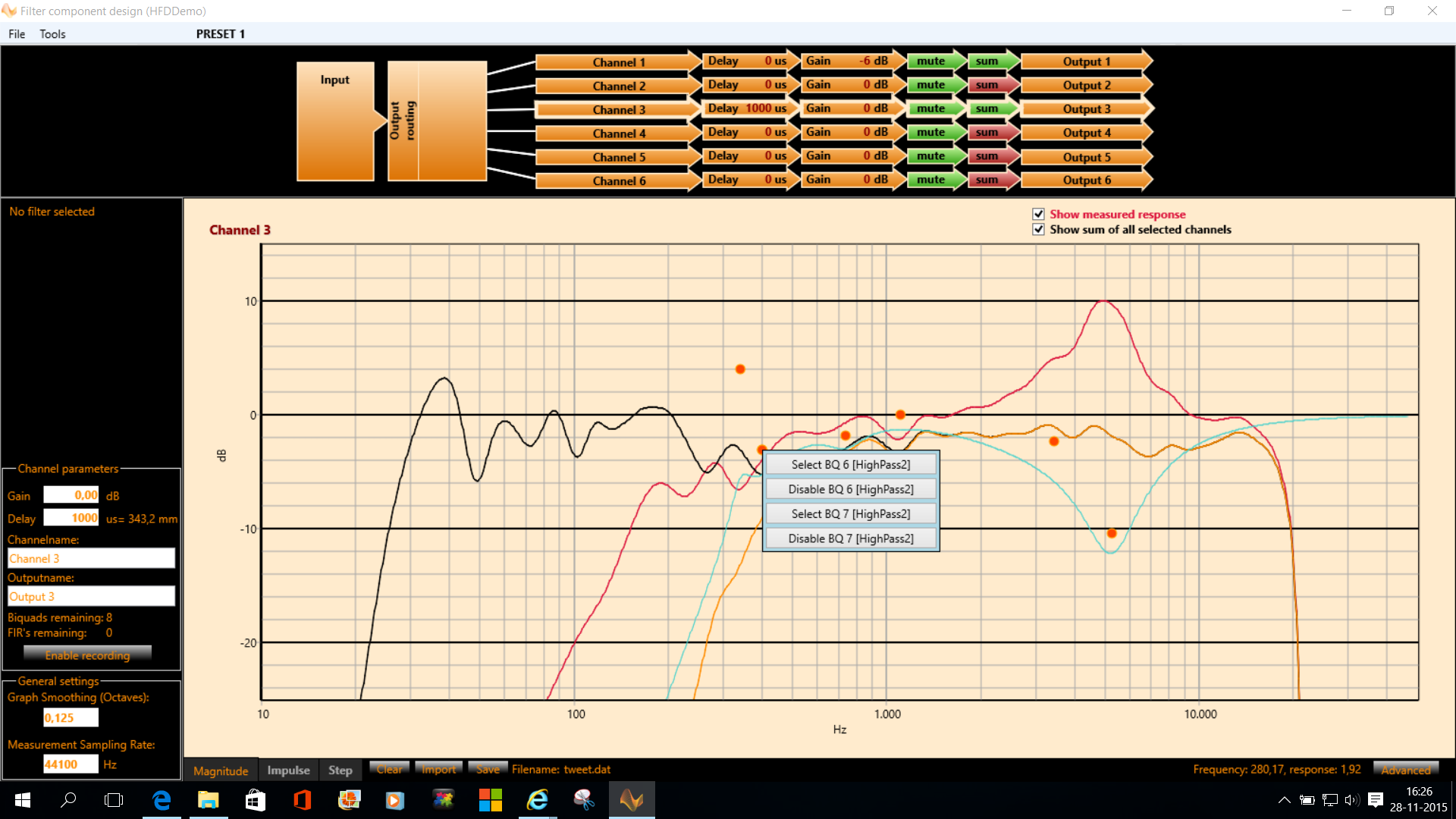

All secrets:
- right click : add filter/ disable biquad/delete biqaud
- Left click and hold: changing freq. and gain
- scroll wheel : Q factor
- click on the graph to deselect the biquad to see the total curve
You can also change values with the mouse pointer and scroll wheel in the value windows ( freq, gain, Q and delay)
In the impuls respons screen you can zoom in with your scroll wheel pressed, this will not work on a touch pad.
