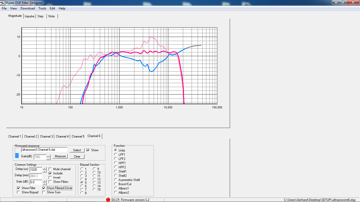

Easier to use? First you have to make measurements with REW and eq them. Then importing it into the minidsp? Filterdesigner incorperates a measurement tool in the program itself.
BTW Minidsp only support 6 biquads for eq per channel. DLCP has 15, only 2 of them are needed for a 24db x-over.
+8 if you use the crossover biquads so 14 in total. Those, however, are not as easy to use as the others unless used as crossover slopes but with two crossover slopes and 6 biquads it's usually enough anyway.
I used 10 biquads for my B&G RD-50's
