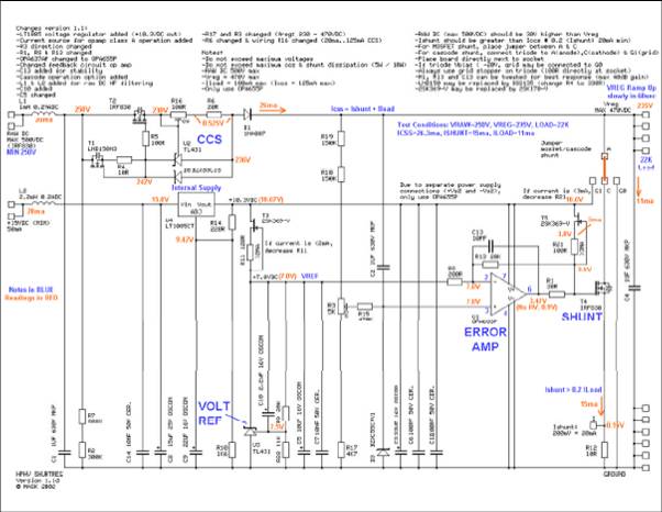

Thanks to Alex and SB for helping me built this regulator
The regulator now works with LM741 and LF351 perfectly
But it will not work with OPA655 and AD817
I am very puzzled

When fitted with OPA655, the following are the voltages:
Pin 2 6.9V
Pin 3 6.5V
Pin 6 2.1V
Supply voltage 10.5V
Original Schematic
Goh
Looks OK. -in is higher than +in so the output will drive down. 2.1V at Vo is about as low as it will go, but apparently it is not low enough to close the shunt. I assume that the HV output is too low?
Are you sure there is no other change and that it works when you just plug in a 741? Did you also change the shunt fet type?
Edit: what's the Vo with a 741?

Yes, no changes, plug in 741 or 351 and it works. The o/p at pin 6 is 3.4V , pin 2 and pin 3 are 7.0V with 741.
I think the o/p needs to be 3.4V to turn on the shunt Mosfet
According to the manual, the check for opamp is OK , ie pin 2 and pin 3 7.0V
pin 6 about 1.0 V befor the HV is turn on

There is something fishy. If the HV output is too low, then the voltage at +vin is also too low, below the 7V ref at -vin. Therefore, Vo should go down to turn down the shunt so that the HV rises again, until +vin=-vin. Yet, Vo is already lower than with the 741, so there's something wrong here. I only can think about oscillation, and you never know what your DC multimeter indicates with a (hf) oscillation signal. That 2.1V Vo is probably much higher, higher than with the 741, but with an oscillation ac imposed. What does tan ac meter show on pin 6? (Probably not much, the freq is probably too high).
Try a brute force to kill the oscillations, increas the feedback cap across the opamp to 10nF or something (C13).

I made an error in my previous post. The Vo must be lower than with the 741 to keep the shunt off.
But with oscillations, the DC value measured with a multimeter has no validity. So if you have a scope, check it as described by ikoflexer.

You got it!
Try to increase C3 (I think; its the one from output to -in) until the oscillations stop. Depending on the value, it may be acceptable. Or try a more docile opamp, one that doesn't have such a very wide bandwidth (but not a 741 ). Did you try a 5534?
