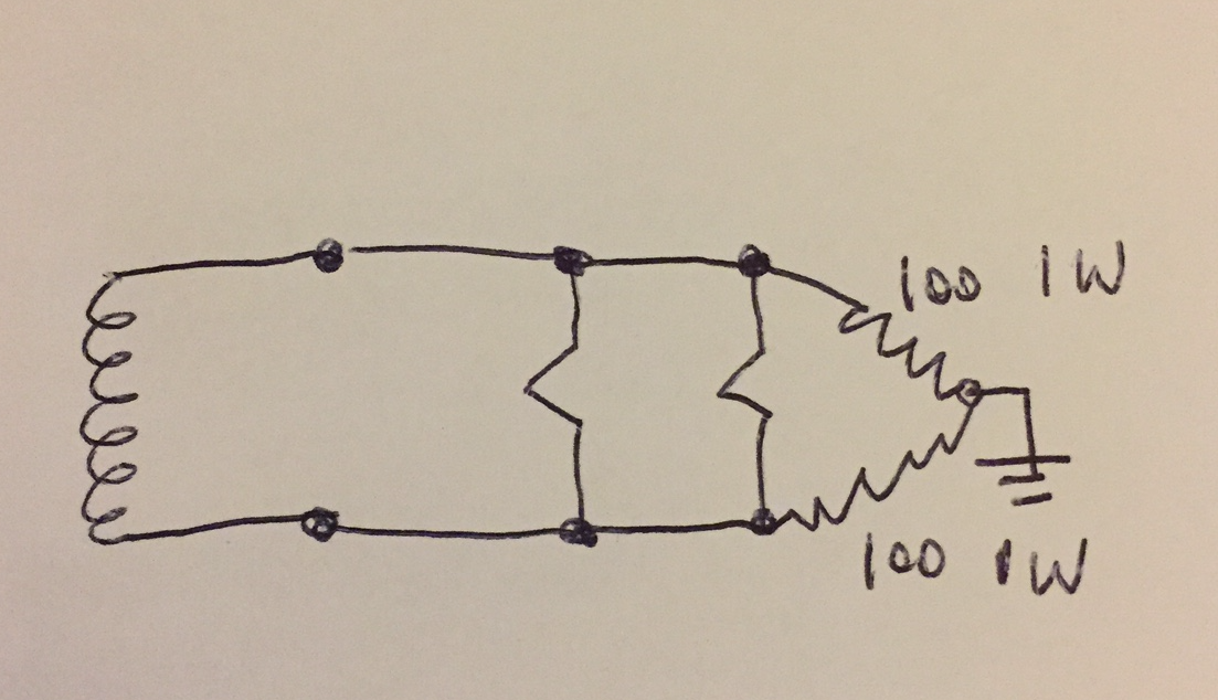

One more thing I want to try is to use DC voltage for tube heaters - both 12AX7 as well as 6L6GC. One question here - I will use a rectifier and LT1085 regulator - should I leave both outputs (plus , minus) connected just to heaters floating or rather ground the minus?
So I spent some time experimenting and what I found is that no real benefit of using DC filament voltage, so I switched back to AC with center tap elevated to a resistor divider between B+ and GND.

What I’m finding now is:
- when I open the top cover where output transformer are mounted I have almost silent output from speakers - my iPhone mic spectrum analyzer shows something like -80 dB
When I close the top cover or move it closer to the chassis I can see a peak of - -69 dB / 150 Hz for the left channel and -70 dB / 50 Hz for the right channel —> hum goas up by ~ 10 dB and becomes audible - different hum from left (150 Hz) and right (50 Hz) channels
- by closing top cover (aluminum chassis) I’m moving top mounted output transformers closer to a choke (left channel) and main power toroidal transformer mounted in the main chassis
So it seems the hum is somehow caused by coupling between output transformers and power transformer, choke,....
Also when I remove tubes from one channel the hum peak drops down by ~ 5 dB (happens with both left and right channel).
No effect of removing input tunes only, when I remove all tubes, amp is almost silent.
All chassis is made of aluminum. What I’m thinking of as a next step is to cover main power transformer by a steel cover and also add steel covers to output transformer windings which are open now and heading towards main power transformer ajd choke when top cover closed.
