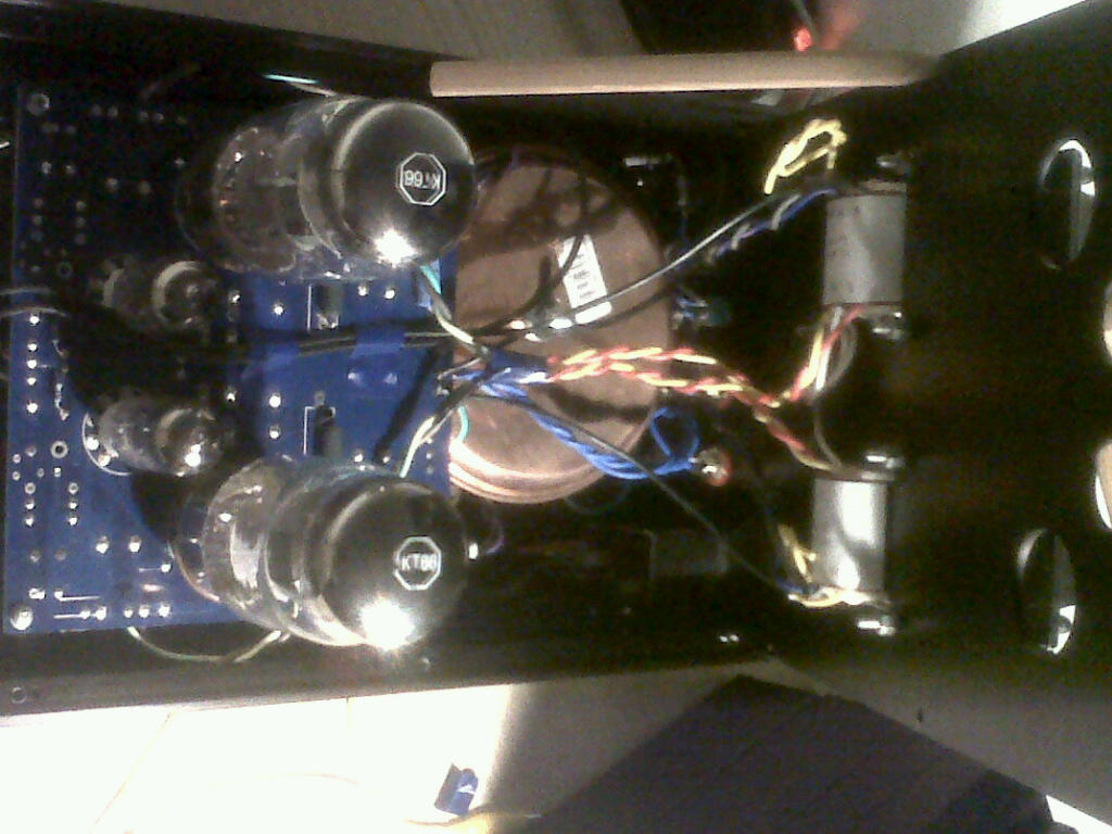

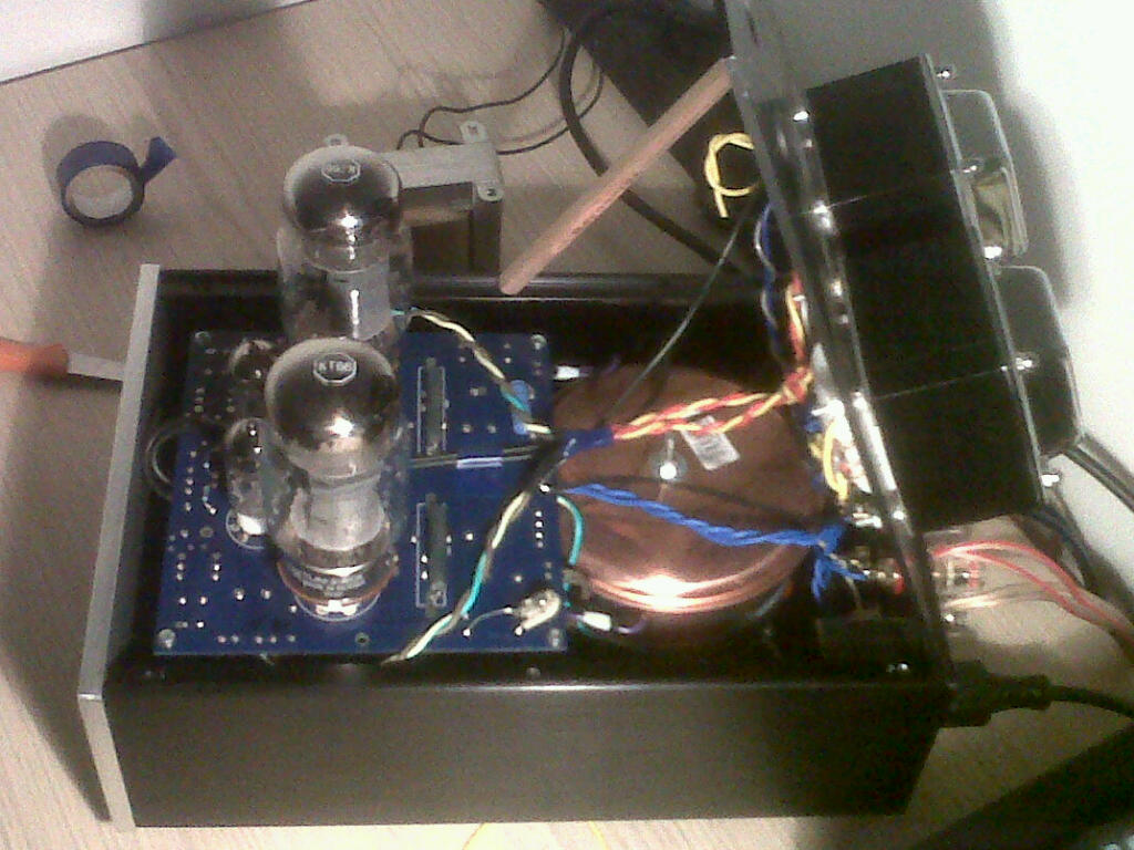

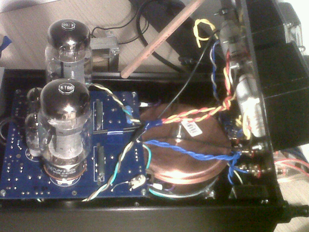

Well, after a couple of months I'm trying agan to sovle this issues with hum. A few observations:
- the hum is 100 Hz
- it doesn't appear immediately after power one but rather a few seocnds lates - maybe when heating of tubes gets to the right temperature?
- it disappears immediately after power off
- I have tried choke instead of power resistos but there is no difference
- I have tried hum pot parallel to CT resistors (connected to GND) but it doesn't help (it influences 50 Hz hum but not 100 Hz that I'm getting)
- I have twisted all pairs of wires tightly
- all grounds are star grounded - no loops
- I have tried shielding of power transformer but again no difference
Any other suggestions?
I'm trying to attach some pictures. The circuit is realized on PCB - see the first page with link to supplier's web page.
All pictures show top plate of amp with output transformers open but there is not difference in 100 Hz hum if the top plate is open or closed.
