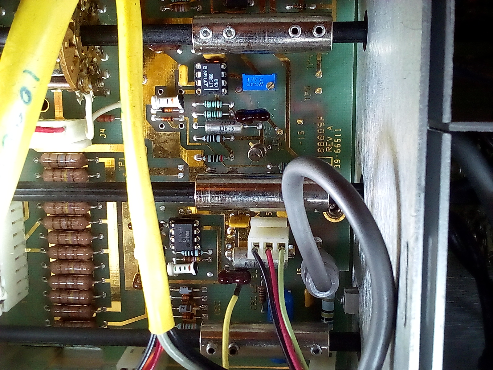

Again to review working on Unit #2 which showed about 11% to 12% distortion when it arrived here just over a week ago. Main problem found - open Jfet Q2.
Currently U1 was replaced with a socket and an LT1468, R30 was replaced with a 25 turn trimpot and the readings are seen quoted above (with original part for U3).
Tonight the two mica caps 510 pf and 27 pf were unsoldered, and U3 was unsoldered and replaced with a socket. A National LME48710NA from China was put in first in place of the original selected part from 1980's.

Hi guys,
After reading through the mods section abridged by Sync, I noted that for the 1468 at U1 it did state removal of CR7 and CR8 as well as C45 and C48, the mica caps, for the best overall performance. I left the diodes on the board, while not connected to pin 8, or really anything else, except +15 Volts, they are essentially disconnected, except for stray capacitance coupling. I doubt that they still may affect the circuit in a meaningful way.

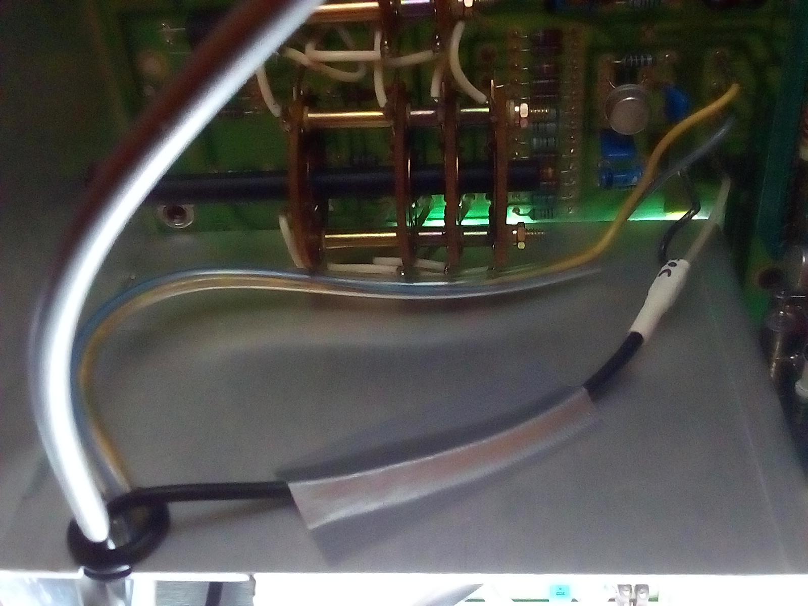

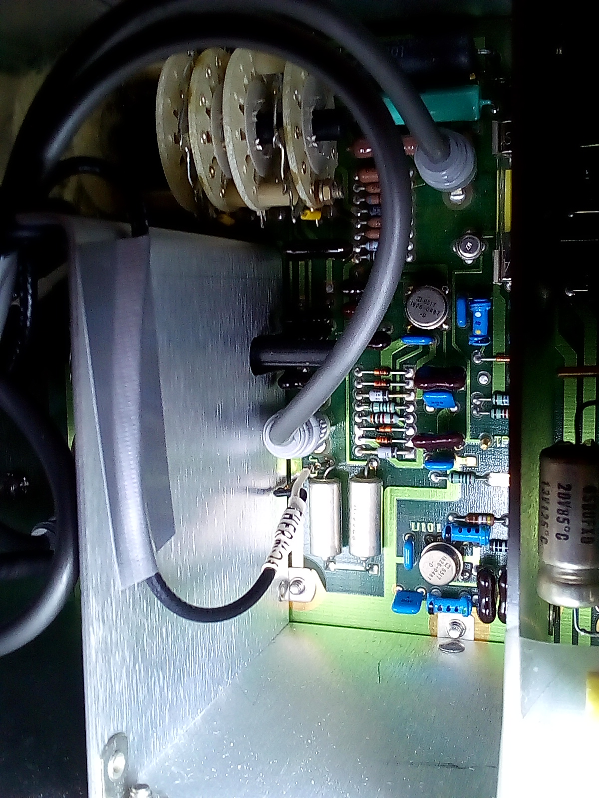

Last night I made a few more adjustments here and there, tightened up the setscrews on the switch couplings, and made up a shielded 1k ohm load plug, that I wrapped in clear plastic tape, then copper tape. Then covered it with duct tape. I then made one final adjust of the null pots on A4, and installed the A1 shields, and the top and bottom covers.
I was also thinking about replacing R51 on the Q2 Jfet, in each set, with a 1k resistor in series with a 2k 25 turn trimpot, and also replacing the 10k Output Level potentiometers, with a modern 10 turn wirewound pot, but decided I could always do those two things in the future if the results are not so hot. While I have more 2k 25 turn trimpots on order, I have yet to order any 10k 10 turn Output Level type pots.

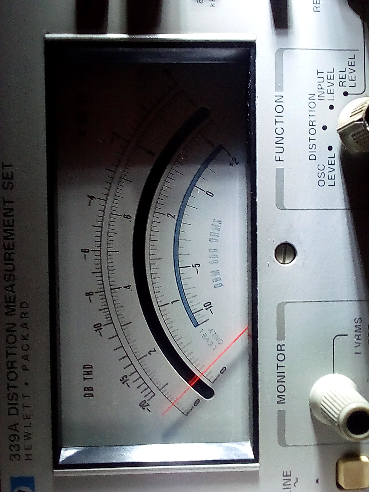

Unit #2, formerly 12% THD some ten days back, on the Residual Noise test reads -103.0 dB. That is below the scale starting point and over 10dB better than the spec. The 1 kHz. distortion, with the 80 kHz. filter on, at a signal level of 3 Volts came in at -98.0 dB, or around 0.0013% again way better than the spec. The unselected combo of an LT1468 at U1 followed by an LME49710 at U3, apparently gains a couple of dB over the selected HA2625 parts of 35 years ago, but realistically it is an improvement of about -2.5 dB to -3.0 dB.
Unit #3 my old set, with all the original 1983 IC's still installed, clocked -102.5 dB on Residual Noise, and THD down at -96.5 dB or 0.0015%. There is some jitter, and the meter does move down to -97.0 dB back and forth continually, but -96.5 is still a pretty respectful reading. This set was just slightly worse than spec some five years back, when it would come in at 0.0020% to 0.0022%, but I had never adjusted the null trimpots on A4 previously, that I remember.

The photo is Unit #2 Residual Noise at -103 dB.
