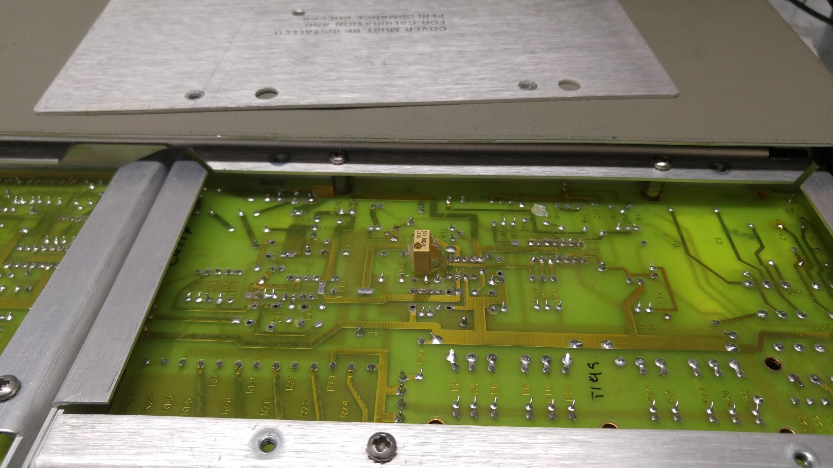

Today I installed the TL074 into the 339A oscillator (U2) and replaced R51 with a 10k multi turn potentiometer to complete the mods pioneered by you guys. I noticed that it would be easier to mount the R51 potentiometer to the backside of the oscillator PCB (pictures included). It sits perfectly in the space between the pcb and the cover. In so doing if you drill a hole through the upper oscillator cover you have quick access to this potentiometer to adjust the 2H. I put a dab of liquid nails glue on either side of the potentiometer to stabilize it to the pcb and drilled the hole in the cover. Now all I've got to do is slide the top cover back about 4" and I can adjust the 2H, if I leave the upper slide cover retention screw out then it only takes a couple of seconds to gain access to it without having to power down.
If you mount the potentiometer the other way to the front side of the PCB then you have to flip the 339A over and remove two panels to adjust the oscillator 2H, in other words its a PITA.

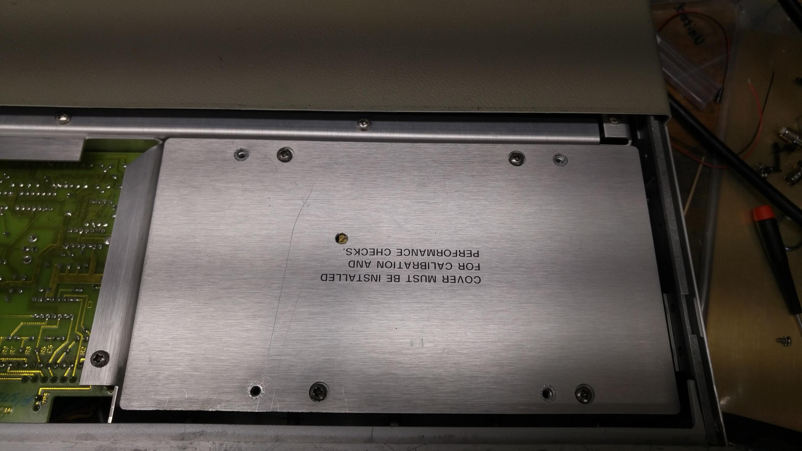

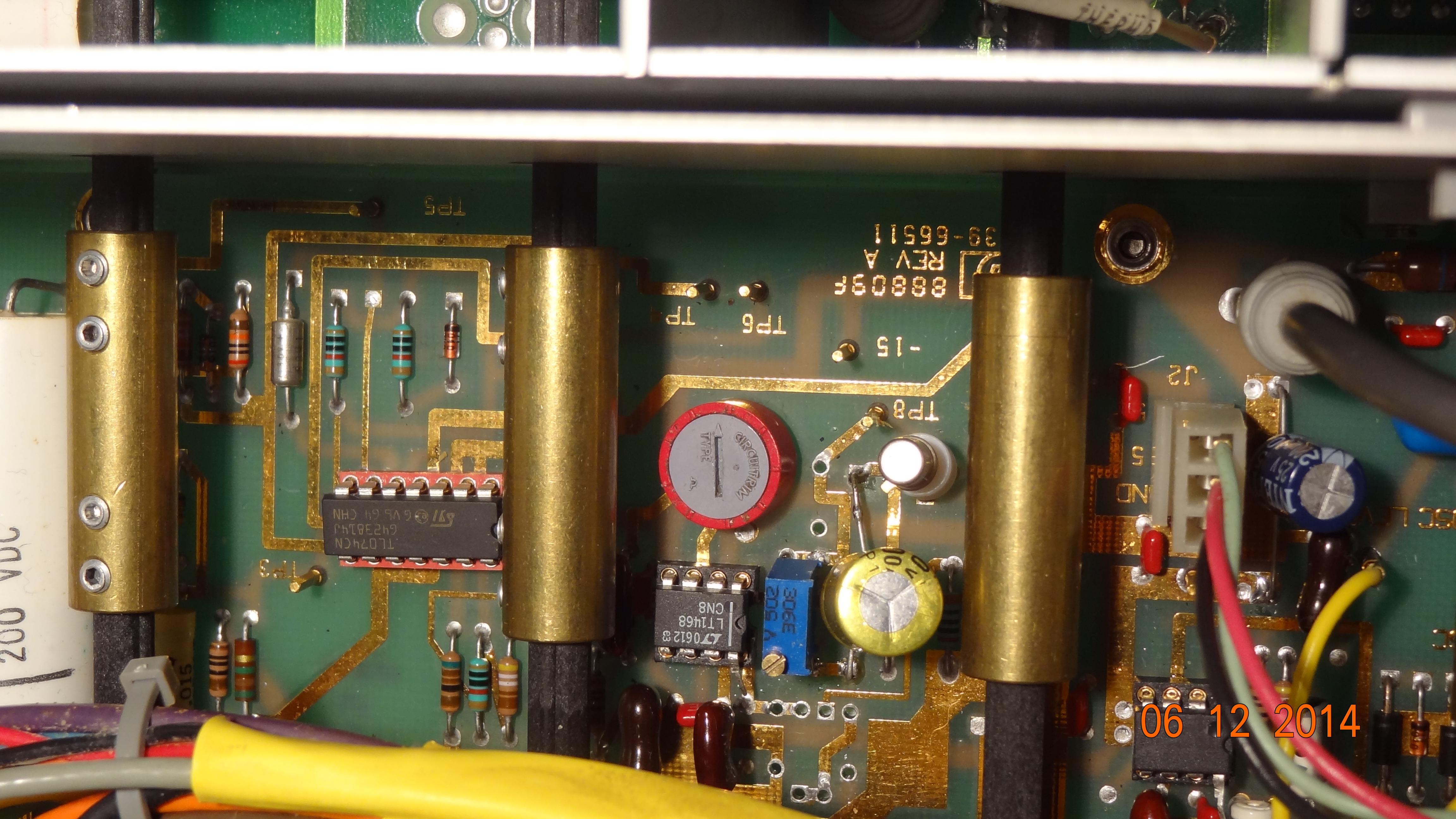

I’ve started work on making some improvements to my HP 339A, so that I can at least get it back to standard spec – or maybe slightly better for the oscillator. I know there has been a lot of work done by a number of people on this forum on repairing/upgrading the HP 339A and I have looked through most of this.
The HP339A (option1) was in working order, but the lowest distortion reading on the internal oscillator was .03% (1000Hz), as measured on the instrument itself. So I made the following changes based on the minimal upgrade suggested in the forum:
1. Replaced the power supply electrolytics (C304,C305,C306,C307). Supply voltages are low (around 14.2VDC for + and – rails) on both the oscillator and analyser supplies, but ripple seems OK (about 0.1mV)
2. Replaced the oscillator output pot (R3). This reduced distortion level to near .01% and allowed low output voltage (to around 2mV).
3. Substituted A1U1 (HA2-2625) with a LT1468 and removed associated compensation components (C44,C45,C48,CR7,CR8.,R29). C32, C47 left unchanged.
4. Replaced trimpot R30 with a 28 turn
5. Replaced R51 with a 3kohm trimpot
6. Replaced C30 with a 100uF bipolar

You should be able to get the oscillator out to 110kHz at 20Vpp at TP1. Can you test at TP1 and report? We need to know which section is slew limited.
I had one or two LT1468 which I suspected were not up to spec. But this was at a gain of 20 and slew limiting began around 350kHz.
Could be there is something wrong in the filters. Bad switch or cap.
Anything that could be causing unusually high stray capacitance around the op amp U1 could cause this. Sometimes a bad socket can cause this or other problems.

Hello David,
On TP1 there is 18.2Vpp up to around 5kHz when it starts to drop off towards 16 Vpp at the maximum frequency obtainable of 65kHz. The waveform becomes visibly distorted (triangular) above around 50 kHz. The lower (than 20Vpp) TP1 voltage may be because the supply voltage is lower than spec?
So it looks like the problem is in the U1 circuitry - and this is the only area I've made changes (apart from the power supply). Prior to making any changes the oscillator worked up to 109 kHz.
Looking back at earlier posts, some people have removed (or changed) C32 and C47, both of which I have left in. Could this be the problem?

I don't recall C32 causing any frequency tuning issues. As far as I know this problem has never been reported before this. Whenever we make changes it a must to do a thorough inspection of the work. Check for shorts, solder bridges and if you used a socket try replacing it. It's possible the IC was damaged when putting it. These things, I'm sure, have stung all of us at one time or another.
The LT1468 is pretty much a drop-in replacement for this oscillator.

Hello David
I've checked all my soldering (and recleaned the area) and can't see anything wrong. Replaced the LT1468 with another one - but this only reduced the maximum frequency to 60kHz. Also took out the IC socket and put in a new one - again no change.
Although very unlikely that this would be the problem, I removed C32 and C47. This had no effect on the frequency range.
At this point I'm wondering if there is a bad contact in one of the frequency range switches - in particular the 10/100/1k/10k. I did clean the contacts before starting the other work and don't remember there being any issue with their operation then. I'm reluctant to start fiddling with the switch too much unless I've eliminated everything else - they are fairly easy to damage, I think.

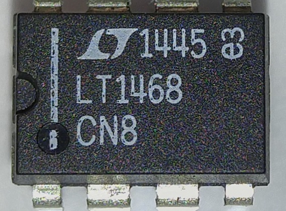

Hello David, Chris
The LT1468 markings have on the top line the Linear Technologies logo, then "1626" and then "e3" (rotated 90 deg anti clockwise).
The second line has "LT1468" and the third "CN8".
From what I can find in the LT documentation, the pattern for their ICs is that the top line should contain 1468, followed by another number/letter(s) depending on the package type. The e3 indicates it is lead free.
So I think the LT1468s I have may be fakes.

Thank you all for your help on this.
KC - the photo of your LT1468 is identical to mine, apart from the "1445" on the top line. Looking more closely at some of the info on Linear Technology date codes, I think the first 2 digits are year of manufacture ( not sure about the second 2 - perhaps week or batch number). So my "1626" code could well be valid.
In any event I have a couple more LT1468s on their way from Digikey, so I'll try those before delving further into the problem.

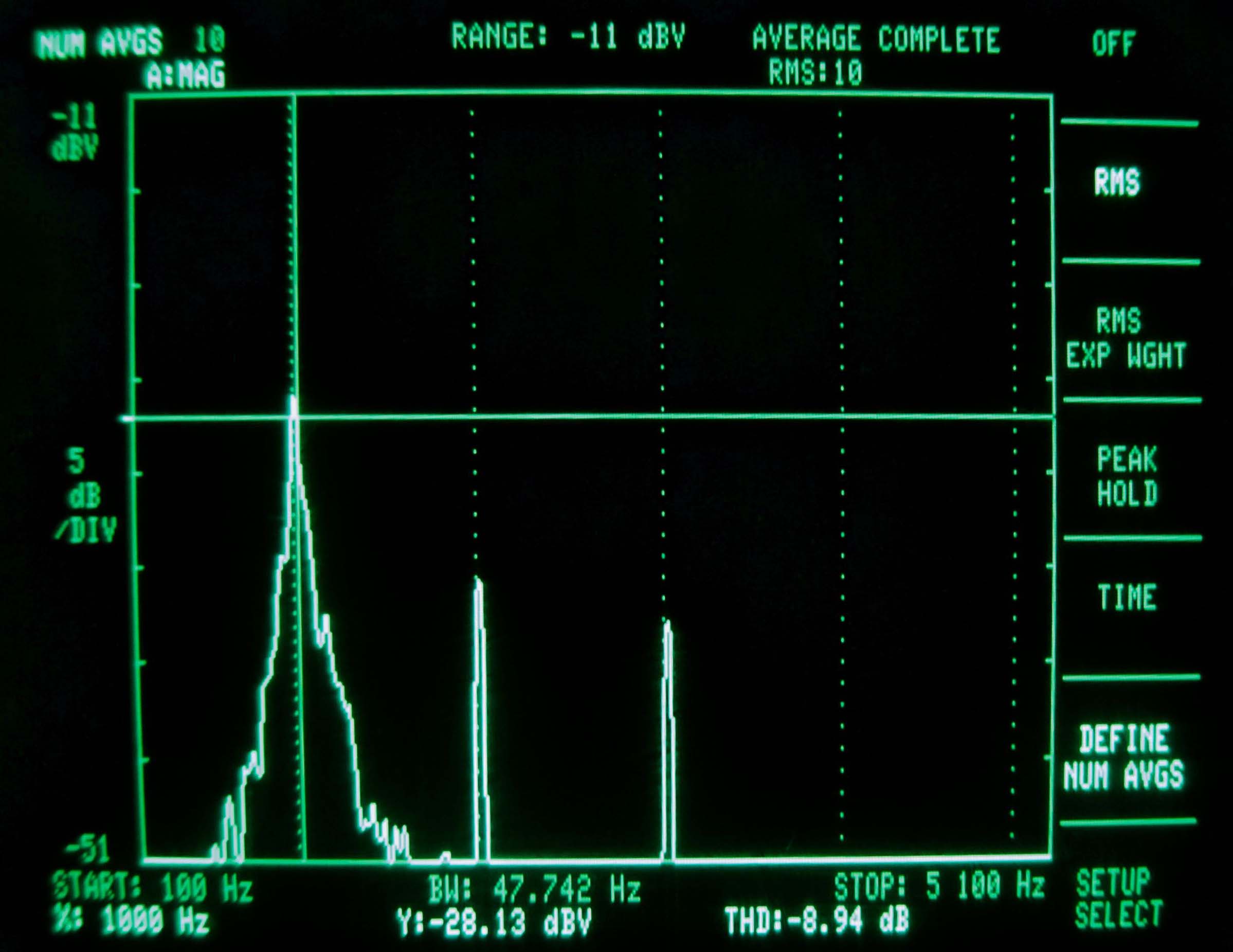

Looks the problem was with this particular LT1468. I substituted a new LT1468 sourced from Digikey and the oscillator now seems to be operating normally. The new chip has the date code "1609" and a circular stamp adjacent to pin 1 (as does the photo posted by Chamberman). The old LT1468 (from Utsource) lacks this stamp.
The oscillator bandwidth now extends to 109kHz and distortion is below spec across the range. As measured by the HP 339A (3v output) it shows 0.0008% at 1000Hz (all filters on), 0.0012% at 10kHz, 0.0015% at 20kHz(80kHz filter on) and 0.0015% at 100kHz (no filters).
I don't have a computer based system to check these figures (or a better stand alone distortion analyser). However, I did attempt to use a HP 3561A to look at the 1kHz monitor output and adjust the trimpot substituted for R51 to minimise 2nd harmonic level. Screenshot attached.
I may be misinterpreting things, but it seems to show the 1kHz residual at -108dB, H2 at -48dB and H3 at -50dB.
I know others have been able to obtain much better performance from the HP 339a, but I think I'll probably leave mine as is, for the moment at least. It should be adequate for my main areas of interest - valve amplifiers and reel-to-reel recorders.
