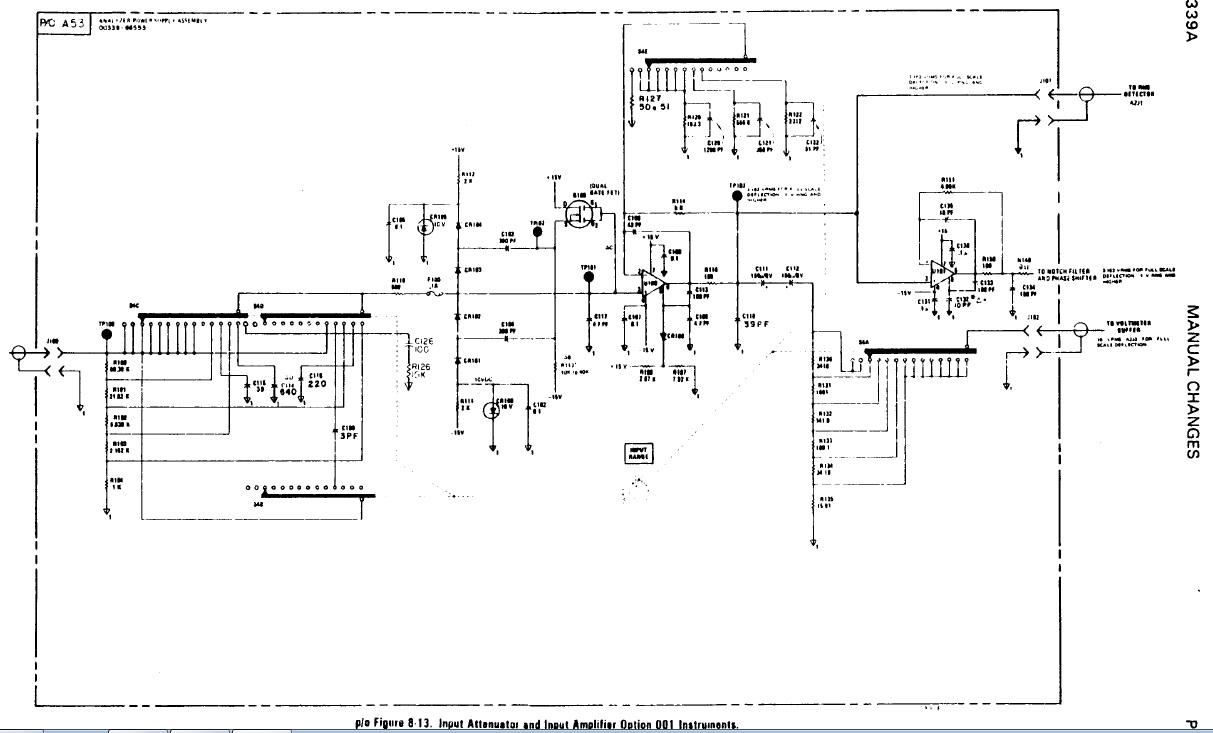

Hi David,
So I started on your last list of items to check. I had previously reconnected the CR102 & CR103 protection diodes so I pulled U100 and F100 and started checking DC voltages.
Pin 3, -7.7V
Pin 4, -15.35V
Pin 5, 0V
Pin 6, 73mV
Pin 7, 15.25V
Pin 8, 9.56V
Pin 3 is extremely high so I lifted the CR102/103 diodes again to get them out of circuit. Pin 3 still measures -7.7VDC. My thinking was that there has to be something wrong with a shorted solder trace or something so I inspect the hell out of the board on both sides. I then realized that what I'm seeing on the board didn't match up with the schematic I was following. After about a half hour of following traces around the board it dawned on me that I was chasing my tail. The 339A Opt 1 schematic has more changes than I had realized. See the attached schematic for the Opt 1 A4 board.
In the Opt 1 339a the dual gate FET in the protection circuit is directly tied to Pin 3 and NOT Pin 2 as in the non-Opt 1 instruments. I didn't pull the Dual gate FET but I'm sure that's where the neg voltage is coming from, its the only thing tied to pin 3/TP 101 now. I will lift it tomorrow to verify this though.
Pin 3, -7.7V
Pin 4, -15.35V
Pin 5, 0V
Pin 6, 73mV
Pin 7, 15.25V
Pin 8, 9.56V
You'll never get another one of those dual gate mosfets. If that is damaged you will have to get creative.
I had a feeling that would be the case.
There's other ways of replacing it. Just takes a bit of work.
An op amp can be used for same purpose. it just cost more.

Okay the problem is solved.
I removed the Q100 dual gate FET and I still had -7V at pin 3 of the U100 socket (U100 removed). I removed the U100 socket again (3rd time now) and inspected, all looked fine. I powered up the 339 and checked the U100 pin 3 location on the bare board, no DIP socket, and measured 0 volts. I ohmed the DIP socket I removed out between Pin 3 & 4 and I measure about 200k ohm with my DMM. All other pins measure open on the socket to their adjacent pins. I can see no visible link between Pin 3 & 4, but its surely conductive between them.
I grabbed a new DIP socket out of the parts bin and it measured open between Pin 3 & 4. Installed it into the U100 location and powered up the 339 with no U100 opamp and there's now no DC voltage at Pin 3. I reinstalled an LME49710 into U100 and the 339 is now working perfectly on all ranges. No DC offset whatsoever, the sine wave stays nice and centered on the scope no matter which range I choose. Its also measuring distortion on all ranges again.
I still need to put the protection circuit back together, hopefully the dual gate mosfet is okay. It only saw about -7V so I think it should be fine.
David I appreciate your help and the good information!
I got the 339A protection circuit reassembled and working again this morning. Its working great now, showing .0007% THD+N with a 1kHz signal. Its also very stable with the needle occasionally wavering about +/- .0001%.
