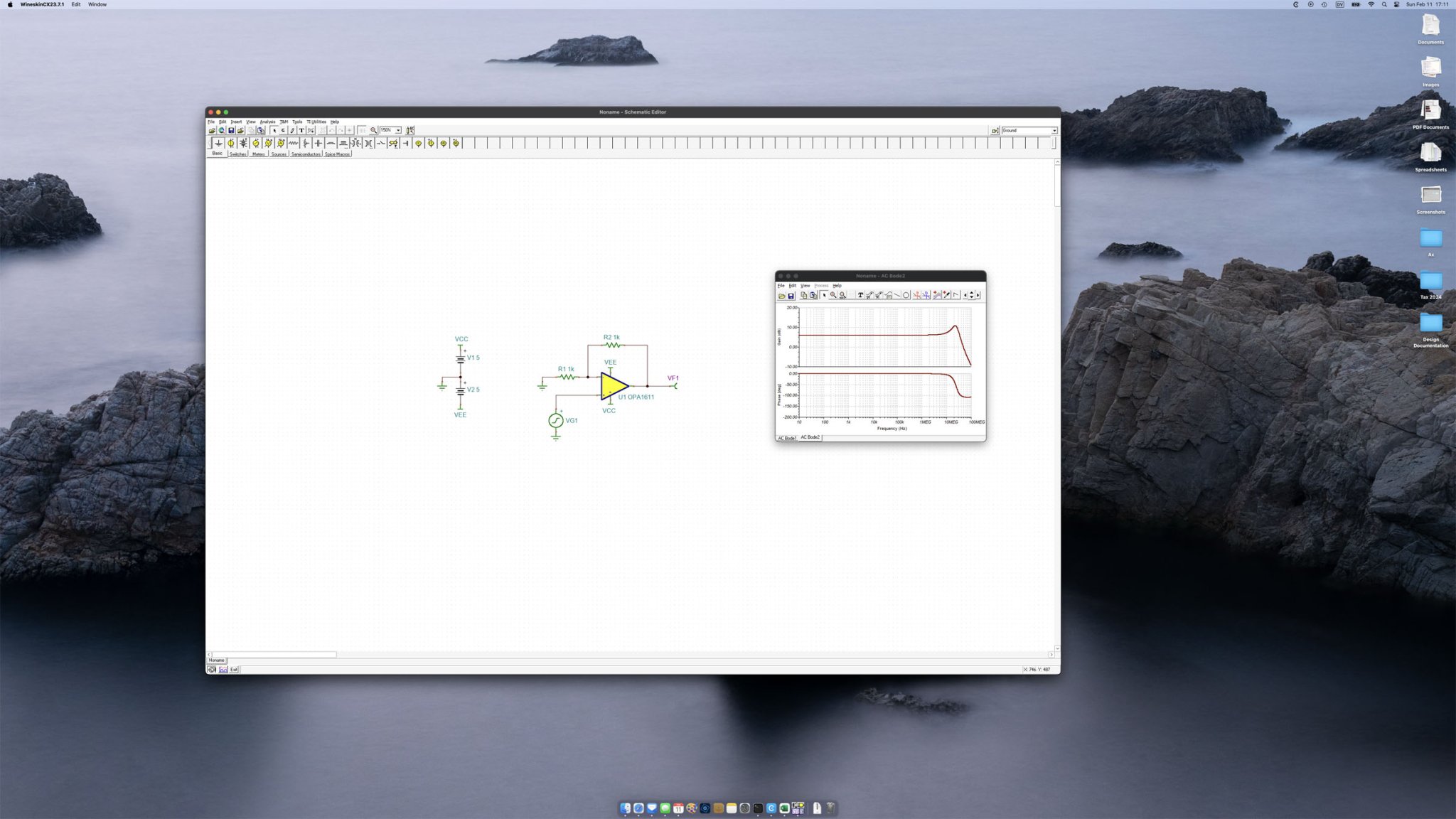

I'm pretty stoked. I have found a way of running Windows applications, including TINA-TI, on my MacBook Pro with the Apple M2 silicon. That seems to be a pretty common desire, so I thought I'd put a guide together on how to make that work.
I have used vmWare Fusion in the past and really liked it, so that was my first go-to. Unfortunately on the M2, Fusion installs the ARM version of Windows 11. That seems to run really well, but for some bizarre reason TINA-TI won't run on Windows 11 ARM. So I decided to give Wine a go instead. That worked! The image below shows TINA-TI running on Mac.

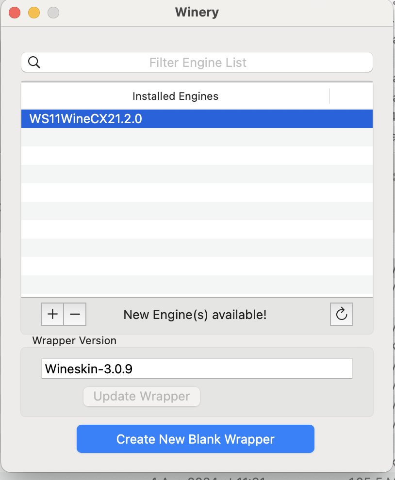

- Download Wineskin Winery from Github: https://github.com/Gcenx/WineskinServer?tab=readme-ov-file
- Double-click the downloaded file to extract it and double-click the extracted app to start the Winery.

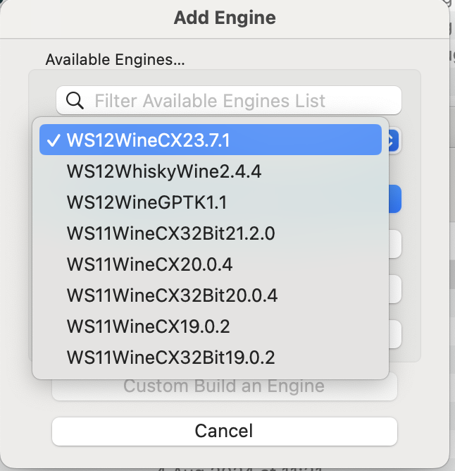

- Install a Wineskin engine. I went with the WS11WineCX64Bit23.7.1_D3DMetal-v1.1 engine.
- Create an empty .app wrapper. This takes about a minute.

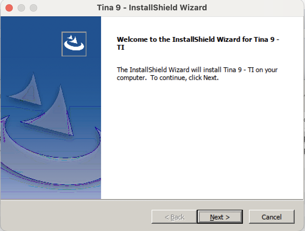

- Download or locate the Windows software you would like to install.
- Double-click the empty .app wrapper to launch the installation process. Click Install Software and then Choose Setup Executable.
- Point the file browser to the installer file for the Windows program that you wish to install. Click Choose.

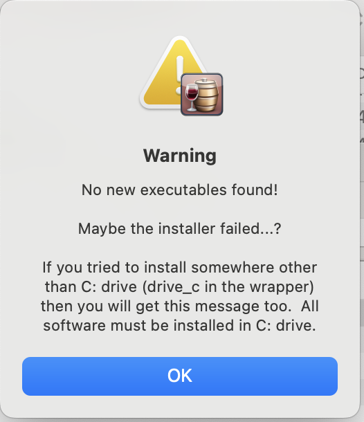

- Then install the program as you would under Windows. You'll have to grant permission to access the Desktop, Documents, and Downloads folders. That's normal.
- <tada.wav> You now have a Mac app that contains your Windows program. You'll find the root directory of your Mac mounted as Z:\. If you need to access network or USB drives, mount them on the Mac as normal and browse to Z:\Volumes within the Windows app.
