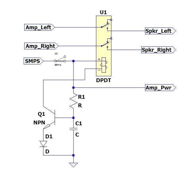

Is there any way to add a delay or filter to these, or modify the circuit in some way to make this less noticeable? Honestly, the $10 isn't the issue, it's that they're otherwise perfect for what I need, I just don't want them to make a loud thump. They are tiny, look great and sound good with anything I've tried so far. I'll be using the amp for a retro-computer setup, where it will be used for playing old game audio (Yamaha OPL3 FM synthesis and a Roland SC-7 Sound Canvas for General MIDI).
You could probably build/find an external relay that you could hook up to your speakers to provide the delay. But it's going to cost a few bucks, probably more than the amplifier itself.
Another choice is to hook it up, turn it on, then plug in your speakers and just leave the thing on all the time.
Still another choice would be to use a DPDT switch in the speaker lines and switch the speakers on manually a few seconds after turning on the amp.
Thanks for the ideas, all of those sound feasible.
I have don a fair amount of electronics repairs, but I don't have much experience designing my own modifications for circuits.
I've read a bit about small, solid state relays being good for things like this, but I can't seem to find a discussion that names a specific part (or even some specifications to look for) or how to implement it.
For a relay I would stay with a bog standard coil and contacts device. It would need to be rigged with a simple circuit to delay it's turn on by 4 or 5 seconds when the power supply is turned on.
By putting a jack and plug on the external unit you could also use it to turn the amp on and off.
The attached thumbnail is a quicky drawing to give you a visual... The part values shouldn't be too hard to work out on your own.

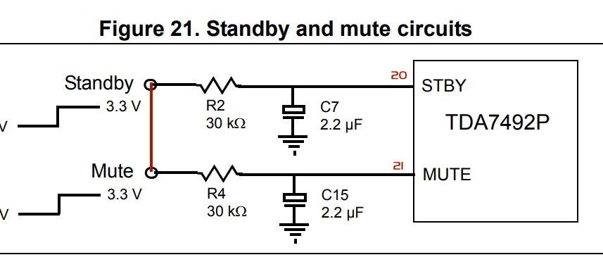

After looking at the datasheet for the TDA7492P, I see it does actually have a standby+mute startup sequence to eliminate the turn on thump. There are very few components needed for this since the board does seem to have a 3.3v source already. Is it possible that the board just needs some components added or changed out for this to work properly?
https://www.google.com/url?sa=t&rct...tda7492p.pdf&usg=AOvVaw27Ok_vp49JuKaVxHM-9ttb
Just looking at the pictures I took, it looks to me like the STBY and MUTE pins actually connect together with a ceramic cap between them, and then they proceed on (need better pics to see where). Having them connect together doesn't seem to match the suggested schematic in the datasheet. Maybe they are just both connected so that the circuit is "on" immediately.
If it's possible to just add a few components internally I'd really prefer that so I don't have to have an external box.
Sorry for all the posts, I'm not allowed to edit posts.
I just realized the standby+startup thing is just a suggested way to start the amp, not an actual sequence. Meaning, you need buttons for standby and mute. They suggest switching the power on, then switching standby off, then unmuting. How intuitive... 😉
I can either add a tiny toggle switch for mute\standby or if there is a small enough time delay relay board (I see them on eBay) that would fit inside this, I guess that's a possibility, but I don't know enough about these things to know what would work.

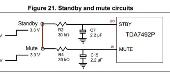

The thumbnail shows the Mute and Standby from the data sheet. I've added the pin numbers and 3.3v connection for you. Now comes the fun part... can you get at this on your board?
According to the data sheet both pins need to be at +3v before the chip will operate... so it's likely they have it tied to 3 volts on the board. So start at pins 20 and 21 and follow that circuit back until you either get the 3 volt rail or (hopefully) a resistor. In practice I would make the cap on the mute circuit a bit bigger than the one on the standby... let it power up before you un-mute it.
If you come to a resistor... that's perfect, all you need to do is change that resistor and add a capacitor to ground, for each pin.
IF you come to the direct rail, you will need to find a point where you can cut the foil, then add the resistors across the cut and caps to ground. This might not be easy as often power traces are buried in layers of the board.
I would say it's doable provided you can isolate those pins from the direct 3 volt rail.
Another consideration might be to troubleshoot those pins with a scope or meter... it's possible the cap(s) you're seeing are either defective or too low in value... in which case a parts replacement might win the day for you.

For my dodgy little schematic...

The transistor can be almost any NPN power transistor, the good old Tip29 comes to mind and you may already have them in your junk box. At one time they were as common as rice.
Any resistor that will saturate the transistor's base, without destroying it should work fine... Try 56k, 47k, 33k, etc. until connecting the resistor reliably pulls in the relay.
Any capacitor that provides the time delay you want is also just fine... with 47k a 100uf cap would provide a couple of seconds. This too can be determined experimentally. Higher values give longer delays.
If you have little or no experience with this kind of design, this would be a nice, simple, project for you to start with... It's quite the rush when your first actual prototype comes to life and starts working.
Okay, I've traced out the circuit a bit more. I was following the wrong pins before (big surprise there). Now that I've identified the right ones, it does almost exactly match the diagram you've shown. I measured 3.3vdc coming from the AMS1117 voltage regulator, going to the shortest leg on the power switch. When switched on (up position) it connects the 3.3v to the middle leg of the power switch, which connects to a resistor for the LED and the 33kohm resistors and ceramic caps (connected to ground) leading to the STBY and Mute pins.
I'm still not sure if I understand this part of the circuit properly, but going by what you said, it seems that replacing those caps with higher values would add a delay and possibly fix the problem? What values would you suggest trying? Also, this may be a dumb question but would I have to use a ceramic SMD cap for this, or would something else suffice? Just for testing purposes, I have tons of other caps, and I down own an LCR meter to be sure of the values.
Okay, so try touching something like 1uf or even 10 uf temporarily across the ceramics and see what the effect is. Be sure to watch the polarity. Do the standby pin first. It should take longer to start up, which is what you want. Once you isolate the right value, you can figure out the best way to do the permanent modification.
Keep in mind that it should come out of mute after exiting standby... so use the next higher standard value on the mute pin. (eg. 1uf on standby, 1.5uf on mute)
Exactly. The chip has internal logic that switches the outputs off when those pins are low. So when you first turn on the switch the caps are discharged from sitting. They then begin to charge slowly through the series resistor. When they reach the operational threshold (2.5v, if memory serves) the amp comes out of standby and/or mute. The larger the cap the longer the charge time... the longer the startup delay.
I would start with 1uf and go from there. The higher the value the longer the delay.
Replacing SMD with SMD is always preferable, but a real pain in the patookus. You can tack solder standard through hole parts on there, no problem as long as it's not going to interfere with a heatsink or other parts.
