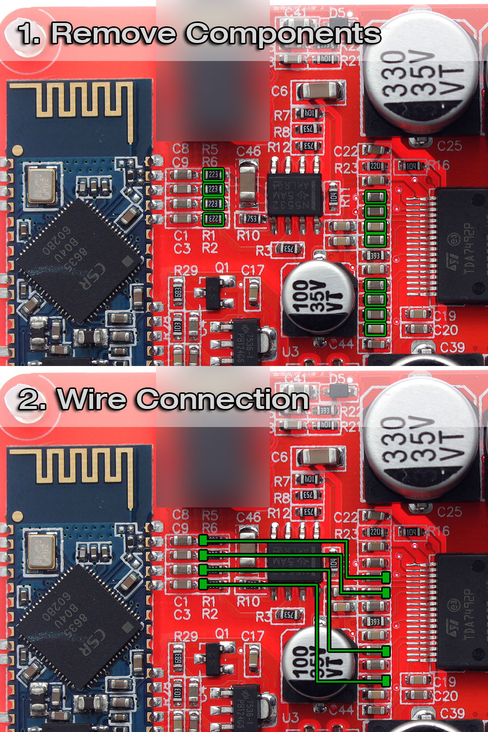

It hasn't the popping noise as described, but I hear a light hiss noise (coming form the twitter) when it plays music. When not playing, it is dead silent. How can i fix this?
Removing the Opampstage (Diff2SE) should normally fix this. (Direct connection of the BT modules output to the amps input) This only works for the boards WITHOUT the additional Line-In.
Thanks, but give me some details (photo?). Do you mean to bypass the NE5532?
Also, shouldn't I try to change the output filter (15mH instead of 33mH and put some good film capacitor?)

Try this:
attachment.php
Untested, but should do.
I want to thank doctormord for his excellent advice! I have this exact board and was really annoyed with the hiss and pops when turning on (and a bit when turning off or pressing pause button).
For me only bypassing the opamp cures the start up pop. I didn't have to replace the resistor value of the mute circuit. Admittedly the hissing noise is still there when you pause the music, but it is not that annoying anymore.

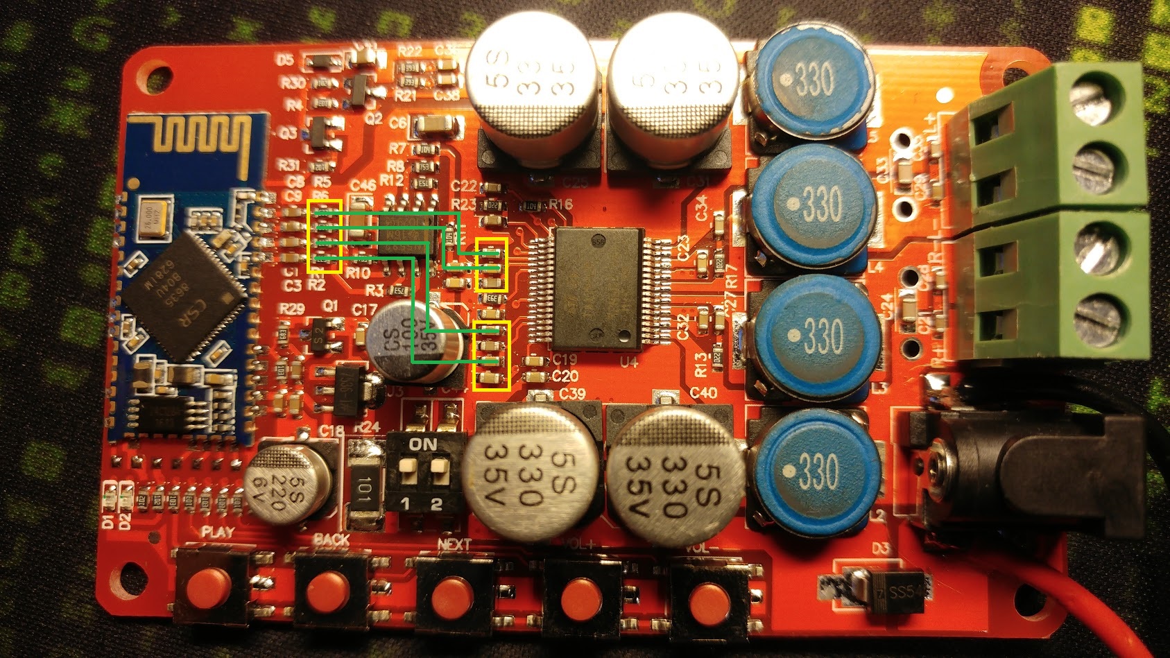

I'm building a portable speaker with TDA7492 and the hiss and other annoying sounds are very audible. First I'm going to try to bypass the opamp for a fix, then for the resistor swap. But I have a slightly different layout, missing some components, but can I still follow the same instructions? Look at the attached picture, yellow ones to remove and green ones for wiring?
