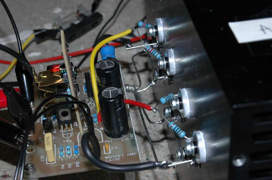

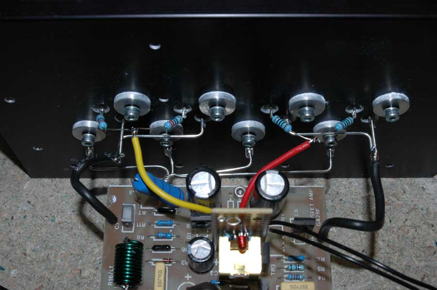

Having compromised down to just two 16A devices per side, i.e. 2 x 16A (N) + 2 x 16A (P) (the devices are paralleled 8A FETs anyway), and shortened the length of the connections, it appears to be working ok.
Whereas the original plan was to build a pair of mono amps, with each having 4 x 16A (N) + 4 x 16A (P), I now think that it will probably be for the best if I make 4 amps and biamp the speakers. I suspect this will sound better than just a pair of mono-blocks, not to mention the fact that the wiring for (4 x N) + (4 x P) will be a logistical nightmare.
Please take a look at the attachments for shots of the amp on bench. Note that this is a rough jig, things will be rewired and made neater before going into service (not to mention the addition of heatsinks to the VAS transistors).
Unless someone knows better, I’m going for 4 amps with 4 x 16A devices per amp.
BTW – Yellow lead = N-Gate, Red = P-Gate – Black 30A cable = Drain +/- and the 1.25mm wire is for the Source. I’ve also wired 2 x 1.25mm copper wire bars running on top of all the T-03 MOSFETs on the other side (print side), held in place by the screws, just to make sure there is minimal resistance between Source connections.
Thanks again to all.
