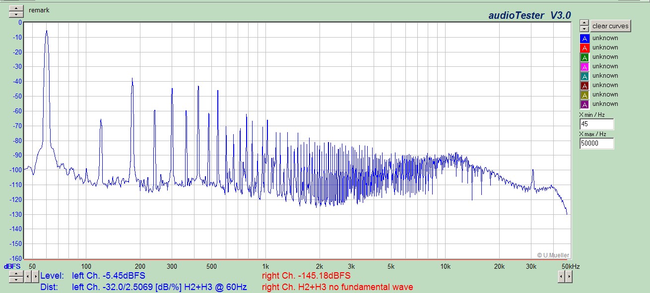

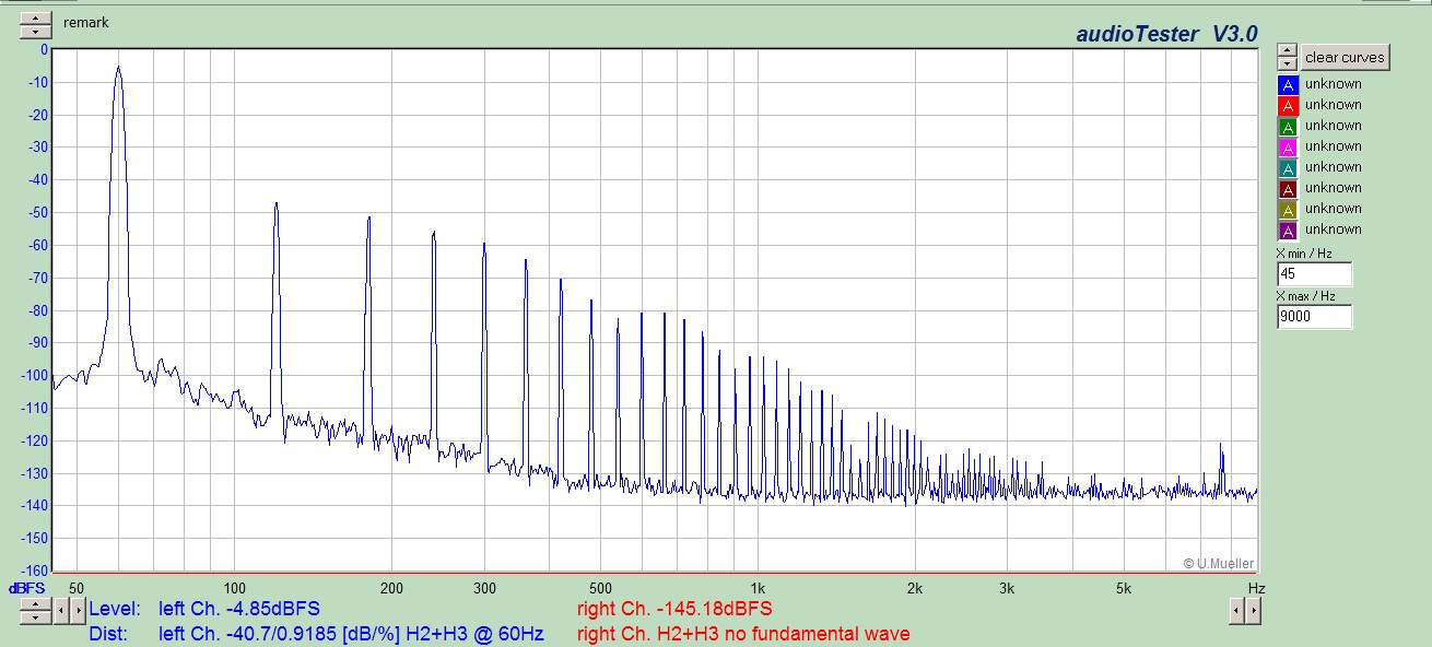

Distortion on the AC line input is 2.5% only based on 2nd and 3rd. Output is 1%. Most significant is the higher order distortion and hash is attenuated by almost 50 dB ! That's no slouch.

Do you understand that the design I have submitted will take a 2% distorted AC main and reproduce a 1% AC regulated output with very low hash and higher order harmonics?
This same design will take a 20% distorted AC main and reproduce the same 1% AC regulated output?
Feed it 95VAC, feed it 130VAC, the output is 115V regulated (or whatever set point I choose).

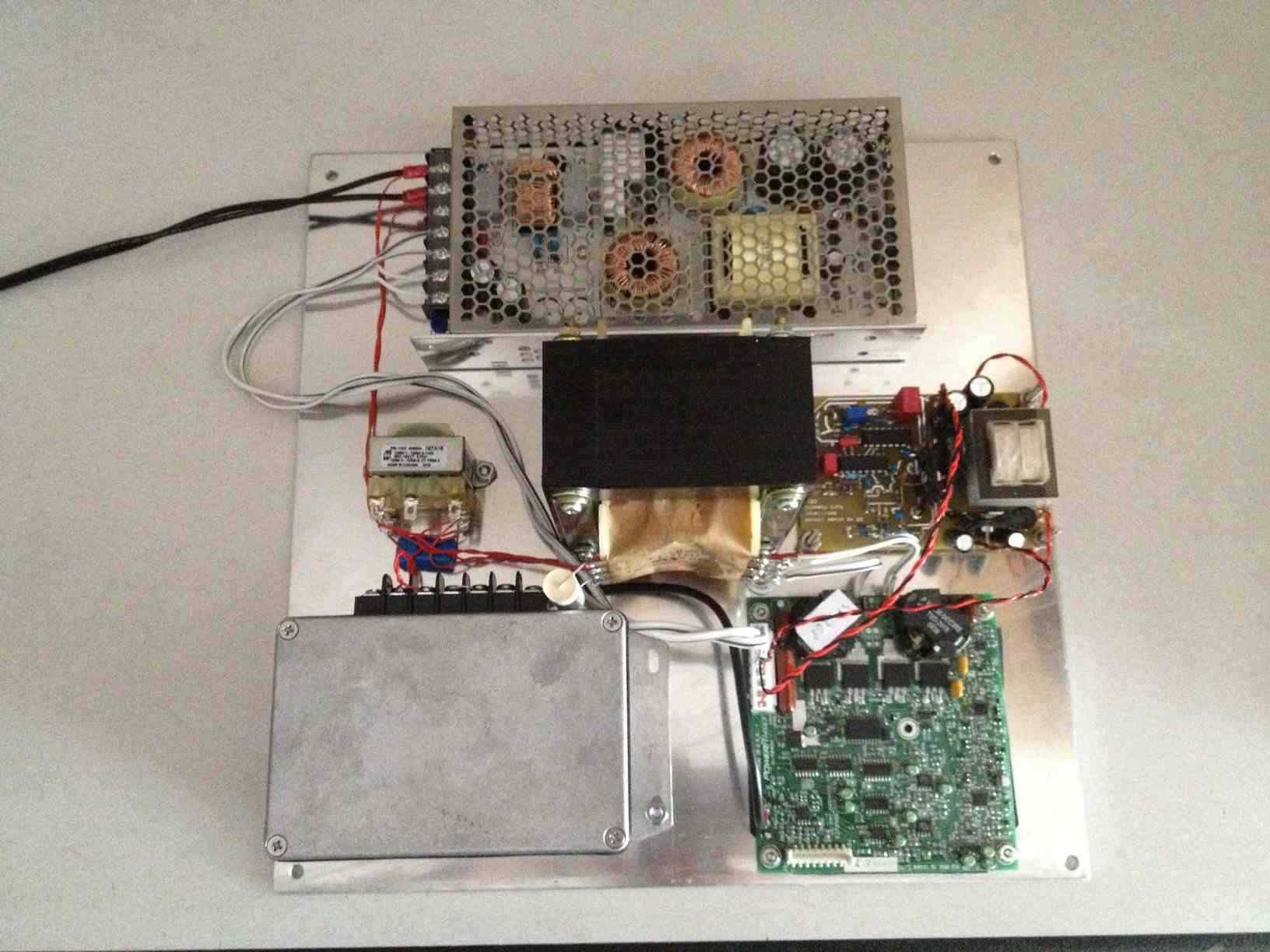

I give up. Were did you get the FFT plots from?Already built. Where do you think I got the FFT plots from?
Would you mind explaining what each module is. They all look like they are commercially available "things" except the one on the right.Already built. Where do you think I got the FFT plots from?
The intent was to prototype something in order to validate it would serve my design goal, so yes, there are commercial products in use. It was quicker and cheaper to buy a 48VDC switching power supply rather than to build my own (that's the one at the top) - same goes for the class-d amp (lower right).
The little xfmr on the left is no longer used (prototype version).
The pcb on the middle right is a theft from a different project; I just used it to provide the +/- 15V supplies required by the class-d amp below it.
The aluminum enclosure houses the PLL/oscillator shown in the schematics from prior posts. It takes a 120VAC input and outputs a 1V sine wave synchronized to this AC input. I discovered I had to enclose this board in an enclosure as the class-d amp was emitting EMI that was hiccupping the 4046 PLL lock. I never was a big fan of that chip, so sensitive and always in need of select-at-test.
So the 48V supply provides power to the class-d amp. The PLL/oscillator provides a clean sine wave to the amp. Amp is designed for 4 ohm loads, so the output feeds a 240/120:48V step up transformer. Primaries wired in series, so we run less than 50% saturation. VA of transformer approximately halved with this config, but I only needed about 50-60W. Amp is well within its limits, and runs quite cool, 30C rise over ambient IIRC. I can sit with my variac and bounce the input voltage from 95-135V all day long and the output is rock steady.
