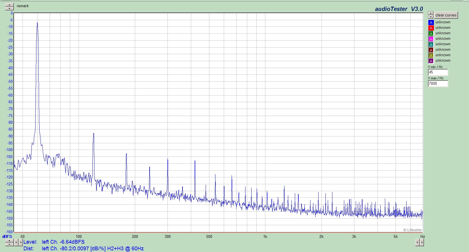

Those designs look quite complicated and inefficient. You would be better served by purchasing a Class D module for the amplifier and driving a step up transformer. I built a line synchronized oscillator with lower distortion and variable phase shift (which I needed for other reasons) as attached. Extremely low distortion. The most distortion is added by the transformer, even though it is running at 50% of the volt-sec product, no where close to saturation.
If you are daring and want to build your own class-D amp, there is a forum for that. They are relatively cheap and ridiculously efficient, so I think you are better served just buying one. Either way, you can build any frequency power supply you want with this design; just substitute a bare bones RC oscillator up front, and you get a clean sine wave output better than what your amplifier can provide.

Thank you zigzagflux for the schematic.
Could you please point out what to change for 50Hz ?
The input called "AC in" is simply a tap off the 6.3V winding, which feeds a comparator to produce a square wave synchronized to the line voltage. My pcb comes with a jumper that allows me to either use line voltage or any external source, such as a function generator. If your AC line is 50Hz, this device will produce a very low distortion sine wave at 50 Hz; there are no changes to make. And it will be phase locked to the AC line, and you have a full cycle of phase shift at your disposal to displace this phase lock in time (which is what I am working on testing with my DHT amp).
If you wanted to produce 400 Hz, you would need to provide a 400Hz input signal to the "AC in" points. This could be sine, triangle, square, whatever - the comparator transitions at the zero crossing. Keep in mind the PLL was optimized for 40-70 Hz range, so I don't know how fast and smooth it will operate at 200Hz+ frequencies.

Unless you want to run your 1970s alarm clock from a generated sine wave, I do not think it is important to phase lock to the mains at all.
Much to the contrary, there is a difference between requiring tight frequency control versus phase lock. I don't care if my power is 59.9 Hz or 60.1, as would be important to drive a clock. However, I do need it to be in sync with the line. I heat my DHT's with this generated sine wave, and need to phase lock to the mains in order to maximize 120 Hz cancelation between the DHT residual and the ripple on the power supply. By adjusting the phase shift I have even further control of cancellation. Without this I would get varying degrees of hum at some low beat frequency, which could be annoying (at least psychologically, knowing it's there).
