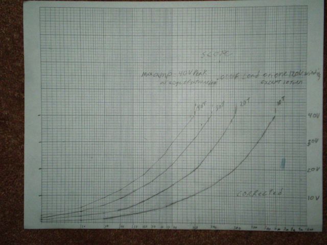

I have included the B-H curves of my core and the data of the core you suggested for all to compare.
And hopes to persude anyone whom has the funds too invest in a quality core.
Although one should not despair ,because good results can be had with what is available.

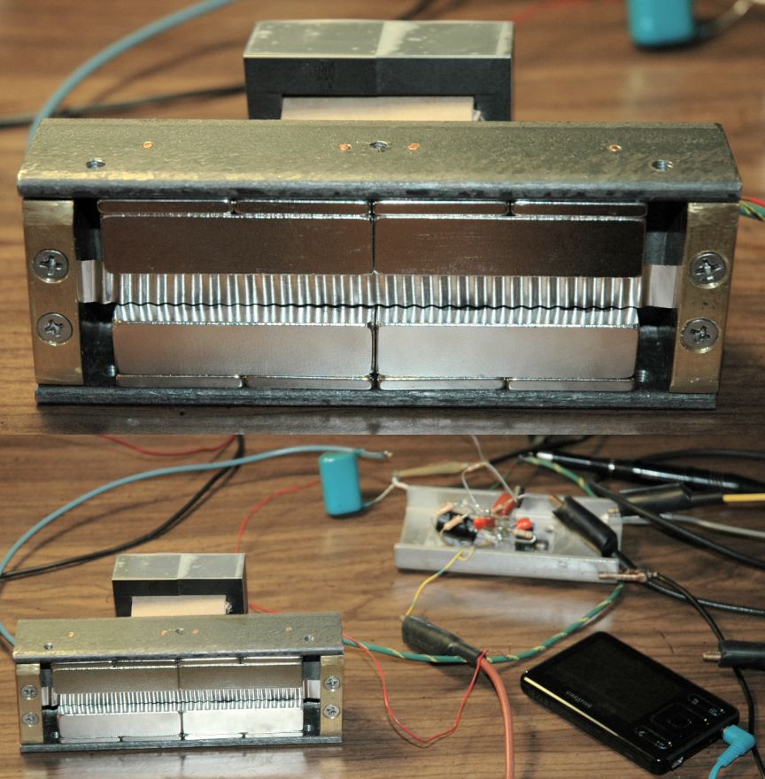

I needed a way to measure the magnetic field so I created this handy little tool.
A magnetometer.
It is not calibrated be any means.
But it does allow me to check the uniformaty of the magnetic field.
I found that even a gap of a 1/4" to an 1/8" between the ends of the magnets showed a reduction in the field strength by as much as 50%.
At a measuring distance of 3/8".
Since I could not gain any significant amount length to warrant the reduction in strength I set the magnets touching end to end.
The field strength is compleatly uniform across the entire length. jer

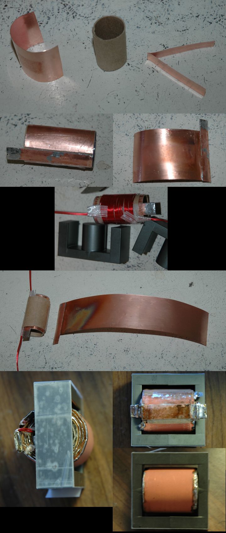

Ribbon tweeter Matching Transformer That really Works
I had some of those Pioneer Tweeters and the transformer was a joke! I tried regular iron cores, and they are more than 50 percent lossy, so tried Ferrite. The size of the core is 2 3/16 inches square and no gap. It is wound based on RF tech, so not an easy job. For ribbon resistance of .03 ohm, which is what the ones I made are, the ratio is 17 to 1. just for 36 watts, that is 36 amps on secondary! I used 5 mil copper sheet that is wound so it is a tube when done. layer of foil, wind 16 turns of 2 ea #21, then another foil. Side ends are pinched together and soldered making it a flatened tube. 4 of these in series to complete it. The connection ends of both of the foils has a piece doubled over and soldered. This is because of the high current. I tested it for the amount of voltage it would take with little loss. For 3 Kc lowest frequency, it would take 35 volts RMS, which at 8 ohms is over 150 watts! The ribbon won't even handle that! This has almost 100 percent coupling, and very little loss.

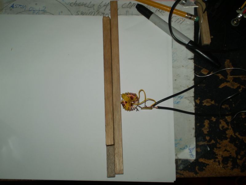

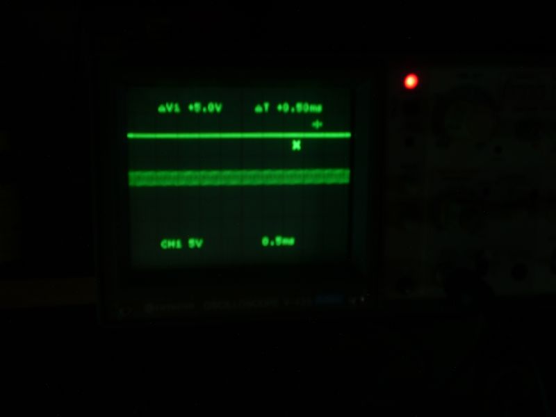

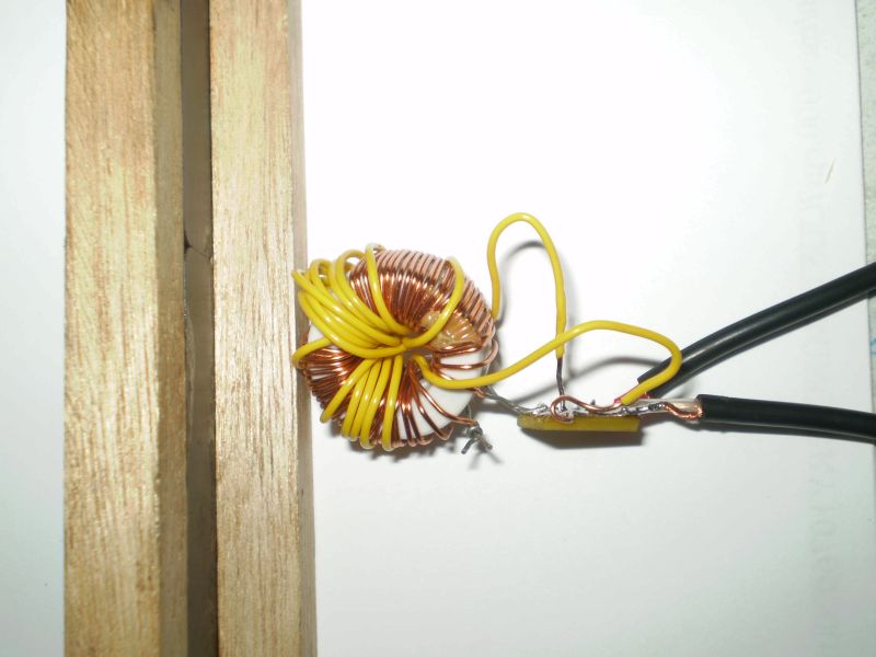

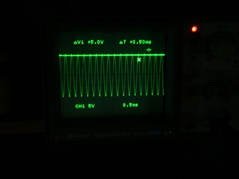

I finally got around to actually testing the tweeter using the transformer I wound shown above. It is almost twice as loud as the Heil AMTs I have and sound is a lot more natural. The impedance of the input was totally flat from 3 Kc to over 40 Kc, and probably well beyond that. Transformer loss was less than 0.5 Db. Was exactly 8 ohms! Air core made the same way will work, but would be very large with a lot of turns.
