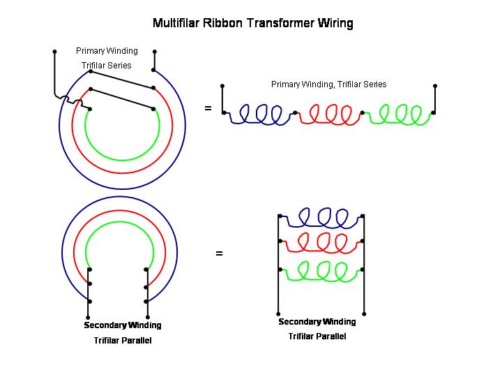

I think a trifilar winding, where three thick low resistance copper magnetic wires are run in parallel to cover a large area when wrapping the core for the secondary with low'ish inductance. Also, trifilar series winding on the primary with thin high resistance copper magnetic wire covers a large area because of the large number of turns. I use this construction techinque for ribbons under 0.1 ohm. Insulated magnetic wire is easy to find.

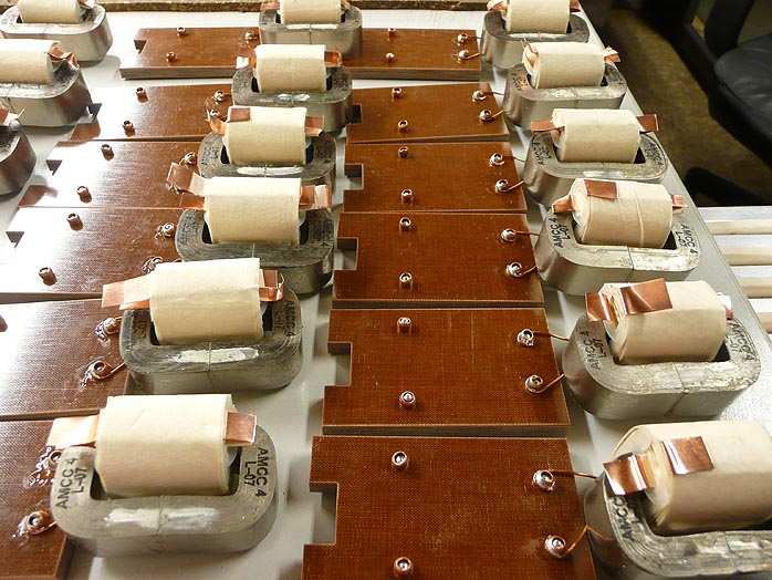

Unwrapping insulated copper foil inductors is probably the easiest source of tranformer foil for experimentation. For DIY, I would probably use no-glue cloth tape as the insulator and accept spaces between the foil windings

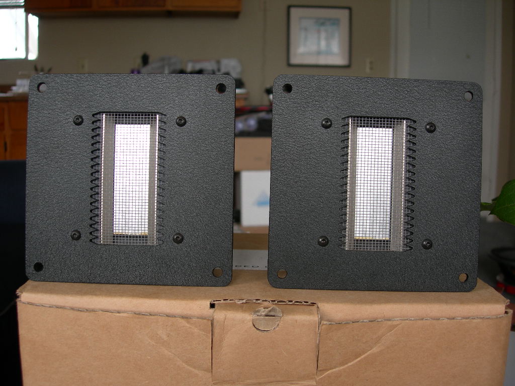

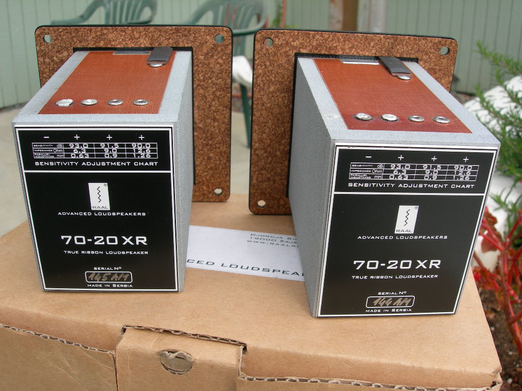

LUST....LUST...LUST..... WIDE RAAL monopole ribbons from DIY swap

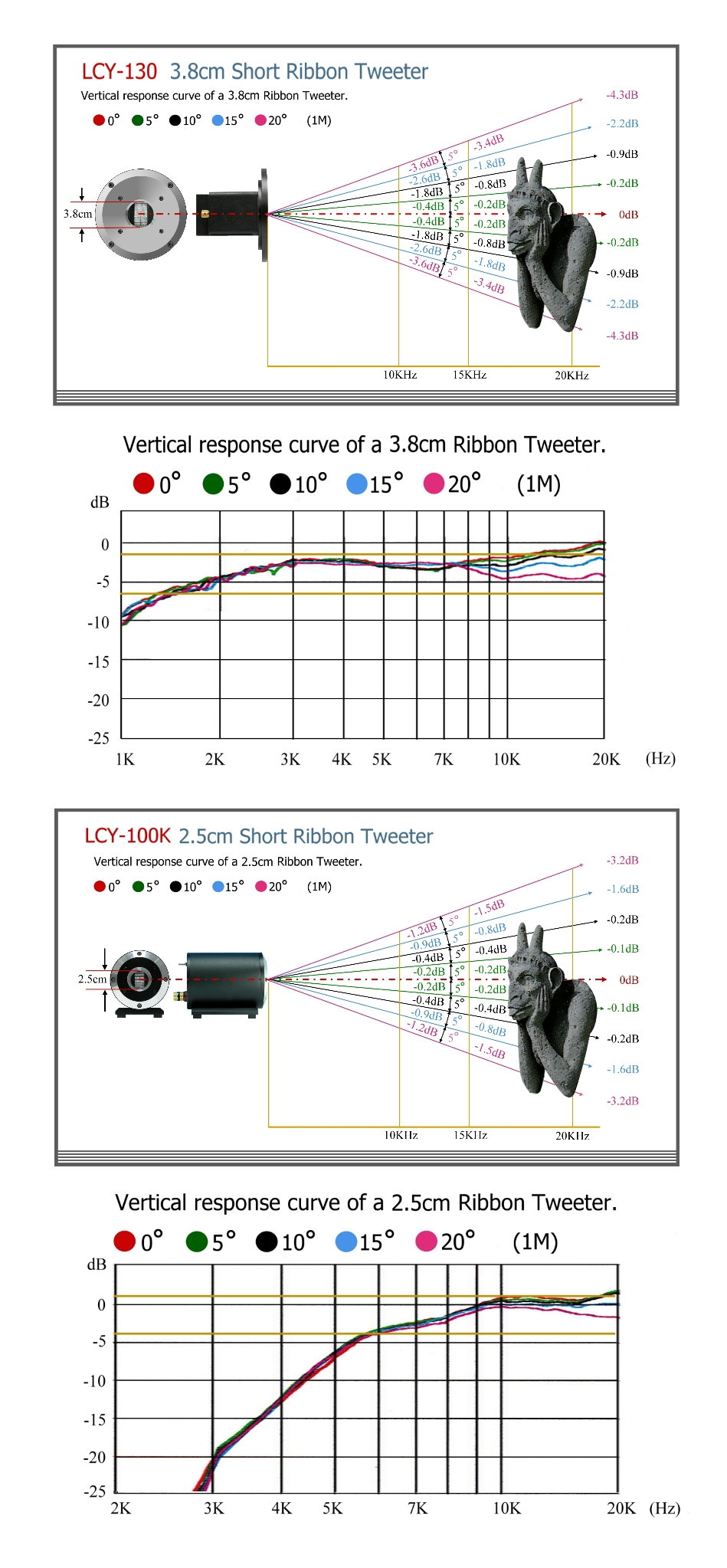

I have been DIY'ing 2" high, 1.2" wide dipole ribbons recently in an effort to obtain good vertical dispersion. NdFeB grade N52 magnets are getting cost effective. A clever ribbon suspension is my real technical challenge. I'm willing to give up some high frequency, SPL, and horizontal dispersion for vertical dispersion. I will need to build a step-up transformer, and will use a "slit" amorphous metal toroid from PowerLite and trifilar winding with magnetic wire. I'll post measurements if the vertical dispersion looks good.
shorter, wider ribbon tweeters look interesting for vertical dispersion.
