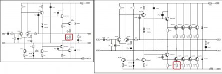

in some quasi circuits 0.33 ohm resistors of the bottom shoulder ( minus power supply ) are in emitter in some are in collector . which option is correct ???
Emitter is correct if you are putting multiples in parallel, since paralleled transistors need individual emitter resistors, regardless of what’s in the collector. With a single it may be either. Collector side makes it easier to implement a current limit circuit, emitter side makes the top and bottom match for ratio of driver to output idle bias.
  • Thank You
Reactions: 2 users
Thats the only way to connect it on the collector side. The only time I’ve ever seen a resistor in the collector that’s not common with the driver is if there is already one in the output emitter. Even then, a resistor is often used in the driver’s emitter (22 to 100 ohms) to add thermal feedback.
