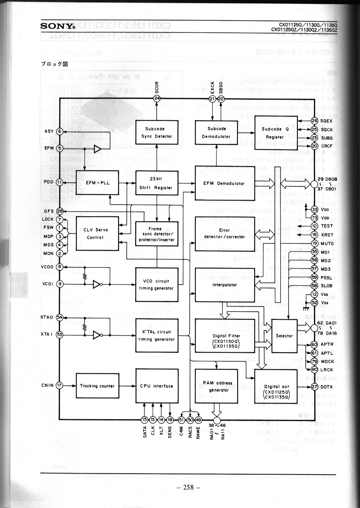

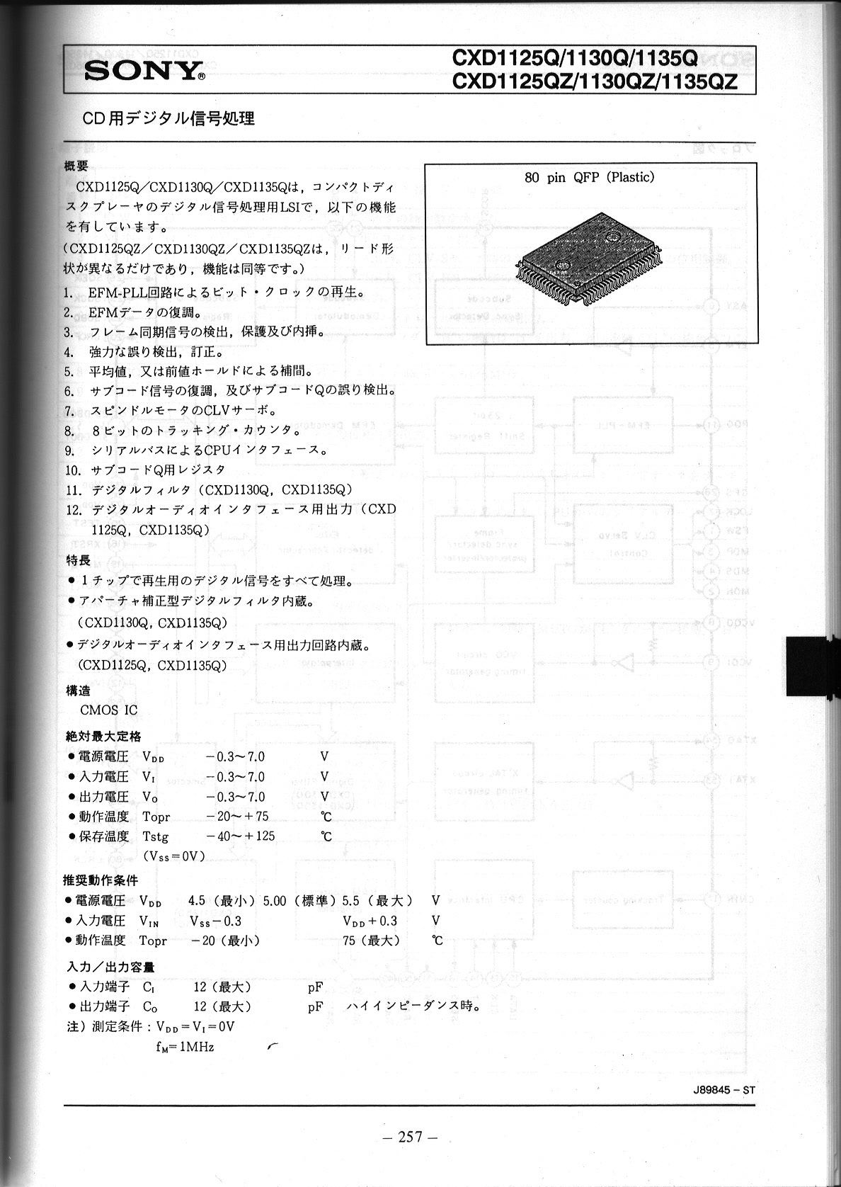

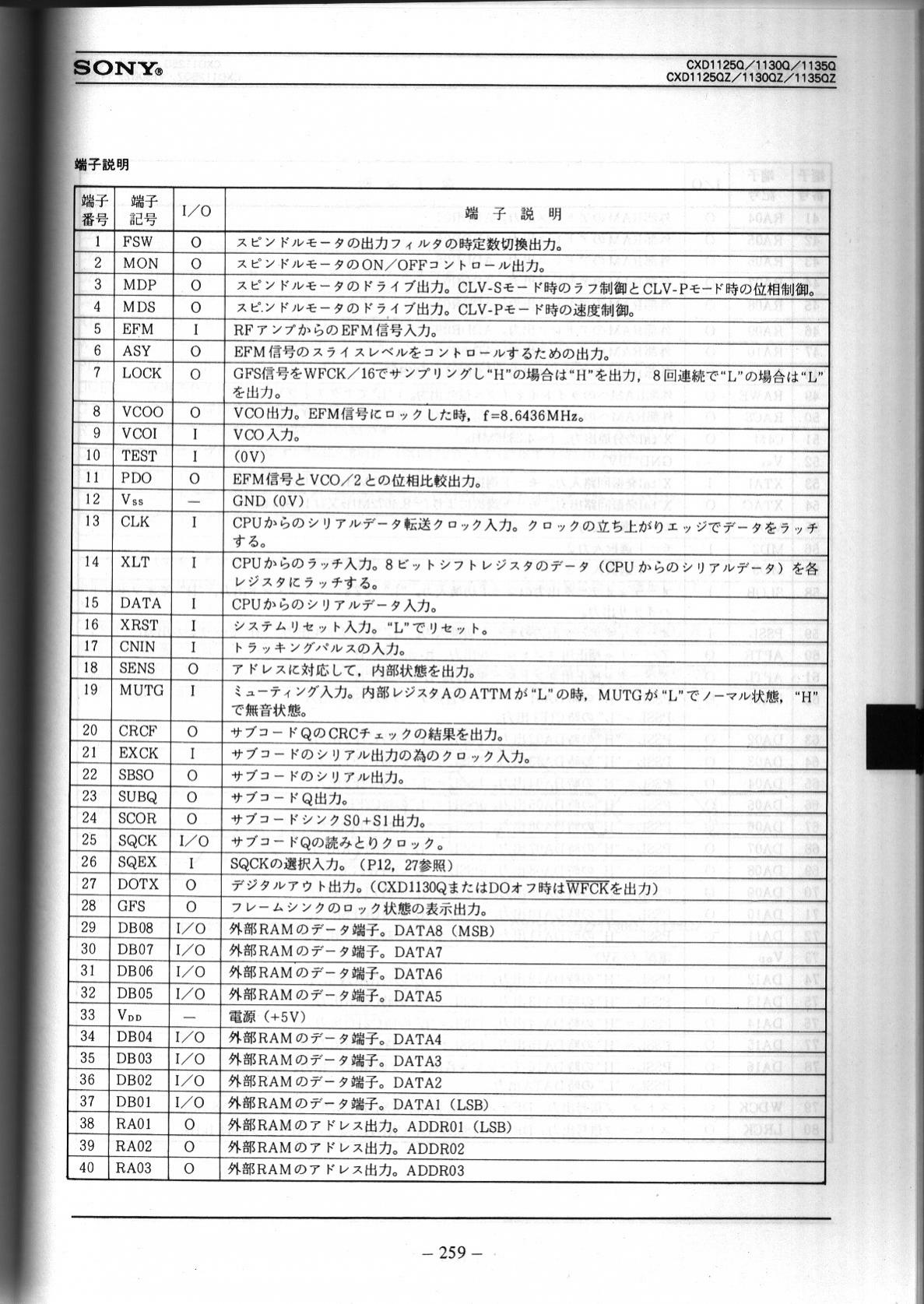

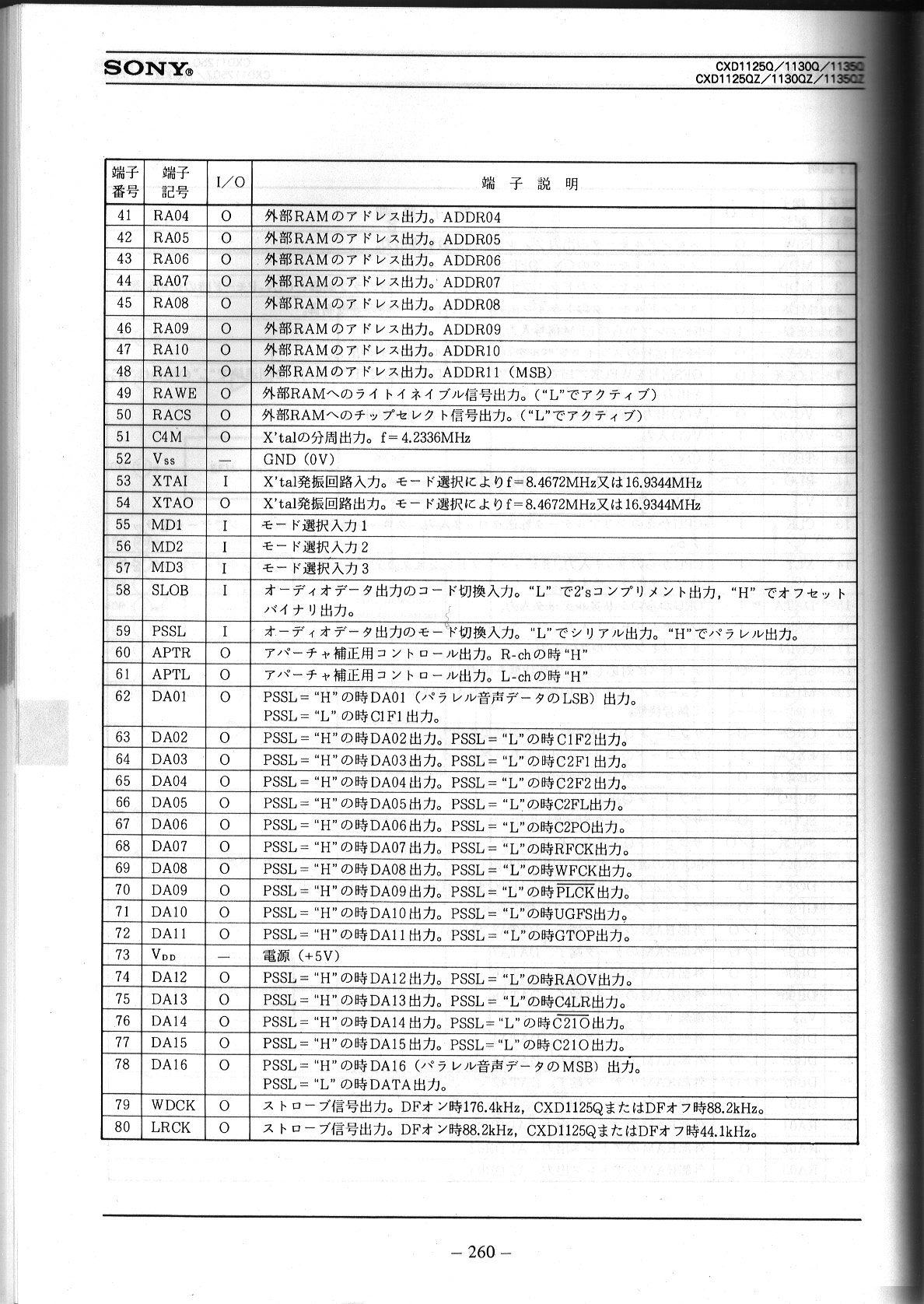

Thanks! Cool and would be nice to try.
CXD 1125Q have some extra features other than DOTX. I believe it can be set/disabled with some pins I/O (or, worse case scenario, controller settings).
The CXD1125 outputs 2FS
CXD1125, pin 56 "H", 57 "L", 2FS;
pin 56 "L", 57 "H", 1FS.
(CXD1135 too!)
also can take a look on the thread (some delay added)
(CXD1135 too!)
