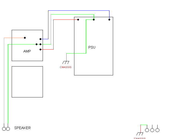

Mark W's diag Post37 is perfect.Try this: Rotate the power supply board so that the board is in the middle top of the chassis.
It is important to twist the parallel leads.
It shows the dedicated mains safety PE connected direct to Chassis, via a short wire
It shows the close coupled triplet supplying power.
It shows the close coupled speaker pair.
It shows the Safety connection from Main Audio ground to Chassis, via a short wire.
And he tells everyone to twist the leads. So that is a twisted triplet for power and twisted speaker pair. Do not plait triplets and quads. Twist !
