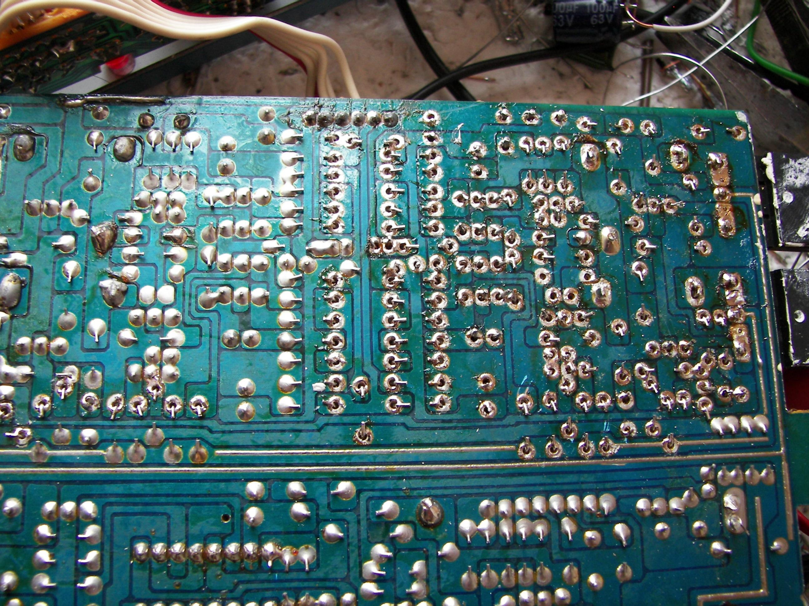

The most in here do love pcbs;-)
But how is to solder;-?
An old picture:
Left side, as has been taught. But has NOTHING to do with AUDIO-physics, AUDIO-electronics...
Right one: "Solderjoints with holes"-)))
Attempt!!! And tell the result respecting "dynamics"-)))
Should anyone disagree ... trust me, he is inexperienced, in practice and complex theory;-)
