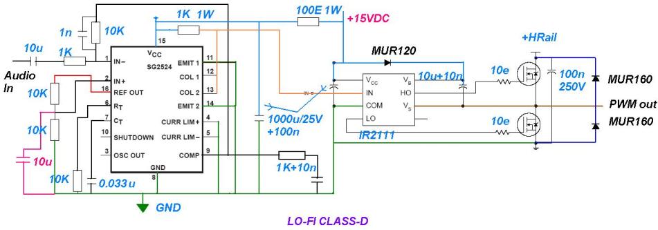

Let's try to clarify the confusion
I fully agree in that soft-start, overcurrent, etc in an amplifier are mandatory, I was only saying that the on-chip features are not suitable for a double-ended topology with push-pull, where 25+25% duty-cycle is required and hence a variation from 0% will produce a negative output progressively going up to 0% where the circuit regulates properly at 25+25%=50%.
From what I can see in your schematics, you are using ONLY one of the outputs of the SG3524 (the collector of the upper output, pin 12 is tied to GND, so you are deactivating that output and using only the lower transistor, you are really wasting a diode).
That setup won't work when trying to implement a power stage for it, as your duty cycle only varies from 0 to 45-50%, and you really need it to vary symmetrically (0 to 100% or 10 to 90% for example) in order to implement a half bridge and DC couple the output as usual.
I don't know if you understand me, Ledmania. I am not saying that the circuit doesn't work for you, but we are trying to buid a High power class-D so the mosfet stage is needed and your circuit can't be used as it is for that.
If the way you combine your double outputs is different, then what I say doesn't apply. If you could show us
Pierre said:Let's try to clarify the confusion
No pierre, maybe you are looking at the wrong drawing. Take a look at it once more and you'll see that I used sg3525 double ended totempole output but not sg3524 with open emiter/collector output. as I said earlier that this sg3525 was tested by myself by loading it with a headphone.

Sorry, Ledmania. I though it was an SG3524.
OK, if your sch. shows an SG3525, the outputs are push-pull and then they are connected OK (wired OR with diodes and pulldown).
But what I was trying to point out is that it works for you with shuwdown, slow start and all that stuff because you are AC coupling the output directly: at starts, output increases from 0 to 50%. At 50% (that you have pre-adjusted), you have VCC/2=6V at the output, but as you have a coupling cap, no problem. So the effect will be your coupling cap slowly charging and hence no turn on "pop". (without that slow start, you would get the same effect as with old Class-AB amplifiers that used unipolar supply, that kind of nasty "thump!")
So we agree so far...
...BUT in the right moment that you use this chip in conjunction with a power stage, that it is all DC coupled: steady state corresponds to 50% duty cycle, that produces 0V at the output. 0% means -VCC (-50V or whatever) at the output, and 100% means +VCC (+50V or whatever). SO if you use slow start, your output will start at -50V and then will rise to the final point of 0V (assuming no input signal). And that's NASTY, believe me!
The same applies with overcurrent: you can implement a circuit at the power stage that detects overcurrent, but it should shutdown the power stage (IR211X chip or both of its inputs), but NEVER the PWM chip, as it will go to 0% duty cycle which equals -VCC at the output, burning your speaker!
Conclusion: PWM chips CAN be used for Class-D half bridge designs, but several questions must be had in mind, such as WHERE to implement slow-start and overcurrent, as well as feedback. We will try to build a high-power one based on SG3525 (or UC3825 for better fidelity)

It's nice that you see the correct sch. Take note that my sch was intended only to verify the validity of the chip to use as class d source thats why I put coupling caps on the o/p to isolate the dc supply through the head phone as the load.This is my old technic in verifying such audio circuit:breadboard+scope+headphone.I dont have cuircuit simulator yet.But in real world of application the coupling cap must be remove then the output of the chip must be split into two via inverter (just same as your PDF sch).
The topic is becoming more interesting.
I understant your point Pierre, and I think I have a solution for that initial logic "0" at 0% duty. You are correct that the speaker may encounter instant "pop" even the ss is at work.
First, Lets use your PDF sch because it is the most typical to most readers and is available now.
Since you use inverter at the output of the "OR" diodes to split the signal in a complementary fashion for hi/lo side of fet driver, My solution is to change that inverter with inverter also but with "TRI state" feature. Remember that IR2xxx drivers has a safety faeture of always at logic "0" on both o/p at start up unless a signal is comutated on its input. This logic "0" on both output of IR2XXX will corespond to both "off" on o/p of the power fets.
Take note that when the o/p of the two power fets are "off" it means they are at "TRI state" also and not negative. You will measure at the o/p a very small leakage current comming from the driver because of the isolation barrier on the driver and not the power fets itself.
Now, this control pin of the tri state inverter must be connected to the o/p of UC3XXX with proper RC filter to accept only plain DC.
BTW,the inverter must be "schmit inverter" so that it will respond in a sharp "knee" of hyterises to the RC filter input.
I hope you got my point

Some comments for Kanwar.
Your schematics is for only a section of a full-bridge amplifier, isn't it? If not, your output must be AC coupled, or there will be a +HRail/2 DC component at the output. (and AC coupling at the output is something we really don't like in high power amplifiers)
You don't use feedback as well, that would be very nice and I think it won't be difficult to achieve.
Best regards,
Pierre
Best regards,
Pierre
