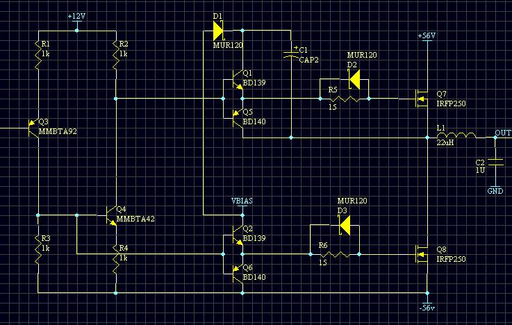

I think that the simplicity of the first sch, the Class-D design, should encourage us to try to complete it, at least to give it a try (it is obvious that the circuit is not well drawn, but some things can be fixed easily).
The oscillator cap and res (pin6 6 and 7) must go to the GND reference of the SG3524 chip. The thing is, did the author want to reference it to -56V rail? If so, the only level shift required for the PWM signal is for the high side. But in that case, a capacitive coupling of the input is mandatory, and I can't see it, so I think that its reference is GND, so there is an error.
The driver stage has NPN/PNP drivers. That's good, but the lower one should be fed at +12V referenced to the negative rail, which is not clear in the sch. And the high side one has a bootstrap diode+cap, but the diode anode should go to that same +12V supply, not to the +56V rail, unless there is a 12V zener in parallel with the bootstrap cap to prevent overvoltage.
The level shifting part is not clear. If the input stage is referenced to GND (it should be), level shifting is required for both parts (HS and LS).
That's easy to fix, we can use a PNP for the LS drive, but that's a bit more difficult for the HS part.
Another thing that worries me is the capability of SG3524 chip to generate a 0 to almost 100% PWM (from what I know it goes from 0 to 45% at each output, although this is wired a bit different in this sch...)

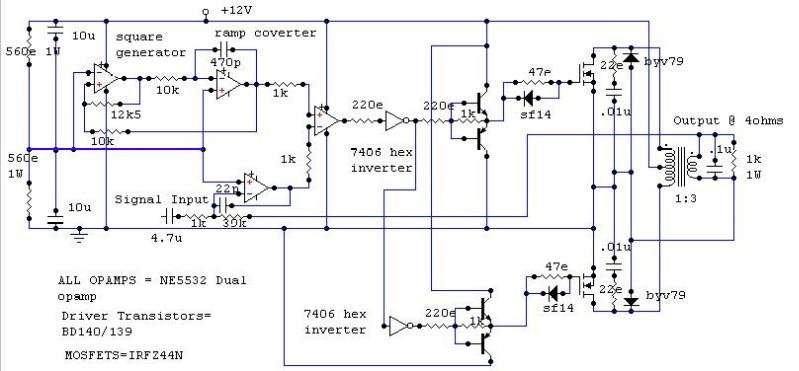

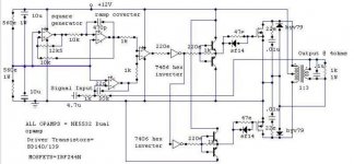

About the second circuit, the PWM modulator is quite straightforward, and the power conversion circuit is very similar to a DC/DC push-pull inverter, with buffered gate drivers.
The "secondary" part uses the transformer inductance in combination with the .1uF capacitor as the output filter.
However, due to the imperfections in the transformer (leakage inductance producing spikes, and its output going int o discontinuous mode, etc, I doubt this can produce an accurate representation of the input signal... unless someone demonstrates the opposite, of course!

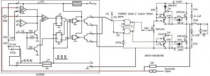

Hi, Pierre,
I found this on a member's website, Dan Fraser.
Do you think the first one (SG3524) based is more likely to work? I also think the same thing, because in the second one, there will be not-balanced magnetic flux on the transformer, will make it hot or saturated.
I wanted to build a lo-fi subwoofer amp, no need to be hi-fi, just be loud enough and runs cool And because it is for lo-fi subwoofer, maybe the oscilating frequency can be below 100khz or even below 50khz? (to fit the IC's purpose, usually SMPS IC's works below 100khz)
If the T-on is not close enough to 50% (just 45% like you said), I think it's OK for my application, it wont be a hi end piece.
About the T-on. Is it better to use TL494 to get T-on closer to 50%?
But....will it work AT ALL?

Lumanauw,
You may definitely give a try to the first circuit, but don't waste your time with the second one. But even that needs some modifications to start its basic operation.
I have to think more about it (there are people much more capable in this forum anyway), but the problem with SG3524 is not that it doesn't reach 50% (the only problem with that is that it won't swing to the supply rails, but that has its advantages also, as it won't never stop oscillation at clipping). What really worries me is the SG3524 output arrangement: I need to draw the waveforms in order to see if that resembles the required PWM format. Perhaps.
Another point to take care of are the level shiftings. I would modify that so the SG3524's PWM output is ground referenced. Then level-shift it so it swings between -56V and 12V above that (-44V). Then you can need to have it level shifted for the HS driver:
The second level shifter could be something like that:
Use a NPN transistor (rated at 150V at least). PWM (after first level shift) goes to base. Emitter goes to -56V with a 1k resistor. Collector goes to bootstrap voltage via a 1k resistor. Output of the level shifter is taken from collector, and then to the NPN/PNP HS driver.
Note that this arrangement is inverting, so you don't need additional inverters. The first level shift also inverts, so in fact you don't need any inverter.
The bootstrap voltage can be easily obtained: 10uF capacitor negative terminal goes to mosfets midpoint (bridge output). Positive terminal is fed from +12V (referenced to GND) via a schottky diode. The join point supplies 12V referred to HS mosfet source and that's all.

Kanwar,
Did you use the SG3524 referenced to GND and the IR2111 to -Vrail? In that case, you need level shifters.
If not, you will need input AC couple.
Did you use feedback from the output of the mosfets or output filter, or simply locally, at the SG3524 opamp?
Please, could you send an schematic of what you did (specially input section and level shifters, if present). With that we can try to optimize the design further. Just as a curiosity and at the risk of become scared what power did you produce this way?
If you configure the SG3524 chip to 40KHz and wire it in "or" output, you will get an effective PWM at 80KHz, is that right?
In theory, you can use that chip at 100KHz ( effective 200KHz ), so you can start thinking on a full-range amplifier.
A suggestion: if you need some more fidelity, I would use another similar driver (IR2110 or IR2113) so you can set-up dead-times more tightly. However, for subwoofer, you need a lot of power and reliability, so using BIG mosfets and BIG dead-time will do better.

Let's see...
This is what I was trying to describe. Please take the general idea. Input is PWM from modulator (SG3524 or whatever).
Then it is level-shifted and inverted at once, so it attacks directly the LS driver. Then it is level-shifted again, with another inversion, and that attacks the HS driver, which has a bootstrap supply.
It needs +12V supply to GND for modulator, and +12V referrenced to -56V for the driver (as usual).

Pierre,
Your gate driver proposal is clever. I like it, because the purpose of this project to me is low cost, lo-fi subwoofer amp, so this is a good solution, compared if I have to buy those expensive Hewlett Packard power optocouplers . Is it free from crossconduction?

Do you have the Full Bridge one? To advoid bus pumping when using half-bridge+heavy work on subwoofer?

lumanauw said:Hi, Pierre, Kanwar,
Thanks for the ideas

Hi LumanauW,
TL494 couldnot be used because the output of error amp and the input of its comparator, has a diode in the series in between them....
Dear Charles,
The LTP is a good choice,as it eliminate seperate supplies when you simply reference the LM360+IR2113/2110 to Negative rail of Mosfets...
Is there is a need of error amp , certainly not because i think LTP acts as an error amp itself....
correct me if i am wrong

About the proposed transistor circuit, it is only an idea and should be polished and experimented for cross-conduction, etc, although that can be somewhat controlled. with resistor+diode in parallel at the gates.
Is it possible to have the SG3524 referenced to -VSS with a half-bridge, and AC couple the input? If so, what are the possible problems? And how to implement feedback correctly then? I once did that simply by AC coupling the feedback also, but that way DC was not corrected properly. I am sure there is another simple but better way to do it.
Let's try to keep the design as simple as possible!
Hi, Pierre,
I think it is the best that SG3524 is referenced to absolute 0V (gnd), like you said, to get best 0 DC offset. We can use of your level shifter, and make 12V+ relative to -56V, no need to make floating power supply, just make it with 1 zener, 1 transistor, 1 resistor (this transistor can be mosfet, runs quite hot, but making everything simpler, providing all mA needed by the gate drivers).
Yes, making the 12V supply referred to -56V is not a problem at all. If you see my schematics in the "Turn on/off transients" thread, you will see how I solved it: just a resistor, 12V regulator and decoupling cap, and power dissipation is quite moderate.
The first level shifter is well proven also in my design, but I haven't implemented the second in any of my prototypes, as well as the discrete drivers. I guess they shouldn't produce any problems.
I agree in that it is better to have the modulator referrenced at GND.
