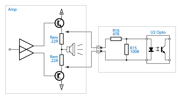

The current sensing is done by measuring voltage drop on the emitter resistors, which obviously isn't going to work in your situation.
I'm in the process of figuring out the best way to add Hall Effect current sensors to the supplies as an alternate option for current sensing. This could be an in series module with the supply rails too. One option I'm looking into is a ACS758. It could be connected to one of the AD converters on the Atmega328, but would require two AD converters per channel (yuck!). Another option would to use a comparator and have it tie into the existing current detection input. I'll likely go with the latter when time permits.
Thanks for the prompt reply… (seem to have sparked something off here). Actually sensing the supply rails directly was going to be my next query.
I'm no engineer but my guess work suggests that this idea would not only stop DC from getting to the output (saving the speaker), but also save the amp… or most of it anyway. Also it would enable us to get rid of the supply rail fuses… I think… no?
Plus, could we do without the output relay as well? While arranging for the DC offset detection to trigger rail shut-down, cutting off the DC at source, even if it's derived from DC being fed into the input?
Whenever I come across something I don't understand I always like to try and understand it (even if it's only for academic reasons). So in view of this, I'm still curious about how emitter resistor current sensing would be wired. Is it like this? (hopefully to pic has shown up).
Your diagram is correct.
Theoretically you could remove the output relay for protection reasons, but it's still needed for turn on and turn off thump delay. Many amps put out some ugly offset on power up and power down too.
It would likely be good to leave the rail fuses in place as added protection. The current sensors will react much faster than a fuse, so they would either need to be set to trigger at a higher current or slowed down to prevent false triggering. It would be better to leave them as fast sensing devices and let the fuses take care of slower failure events. The ultimate scheme would be to connect them to analog inputs and write software to allow high current for short bursts, and lower for longer lengths of time, but this would add a lot of work to the processor and would likely slow it down.

This system is meant to be connected to any amplifier, so there's no way of knowing how the amplifier will start or shut down. I prefer to keep the output relay for that reason. I also prefer the idea of monitoring the current at the amplifier input. It's possible to have an amp oscillating and suffering shoot through without having high output current. I would prefer to catch this and shut it down before it lets the stink out.
Actually you can use rail disconnect fets as current resistors, with optoisolators as sensors. Trip point 1.2v/.04ohm=30 amps trip point. I've bought some .041 max resistance nfets. This current should be adequate for most 3 to 5 output transistor pair amps. You can connect the phototransistor in open collector OR function with other fault detectors to set the fault latch, and turn off the drive current to the rail fets driver. I've got the photovoltaic rail fet drive IC input in series with the green side of the fault LED.
If you need more sensitive rail current fault, you can put 0.1 ohm or 0.2 ohm resistor in series with the rail nfets and put the photodiode of the isolator (plus current limit resistor) across both. Or buy a higher resistance nfet.
I've got the rail fet between mains cap and the output transistors. So I don't see the mains caps having anything to do with the response time. My PV-1.3k has .1 uf out locally on the output transistor board rail, that is all the stored charge out there.
If Rds is .0025, then use a .04 ohms resistor in series with it to set off the optoisolator. Better really,a hard resistor value doesn't decrease with temperature the way a a nfet resistance will. Optoisolators are about 10 mhz devices, so are 74hc74, so that should be fast enough for anybody. A Panasonic APV1122 would take longer to discharge the gate charge of the rail fet to shut it off, unless you use optoisolators in series with the red fault led to short out fet gate to source (which I'm doing)
