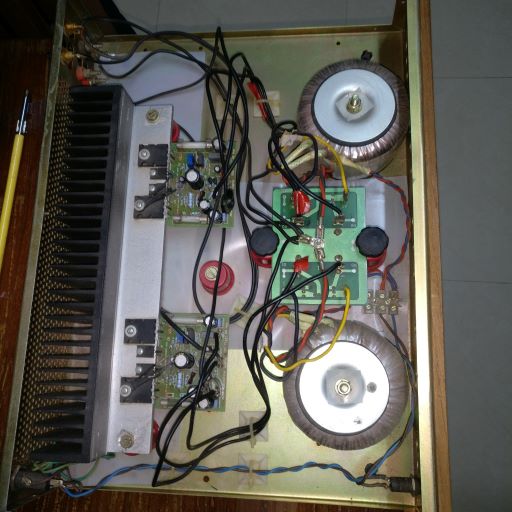

I think it is the original AKSA55. Will open it up later today and take some pics.
The last time I opened the top cover and looked at it was 2 years ago.
At the time the assembly resembled a 6th grade science project .
The unit needs some TLC. So planning a new enclosure, an IPA bath and reorientation of boards, transformers and connectors.
Since I don't have any documentation, I'll have to work carefully.

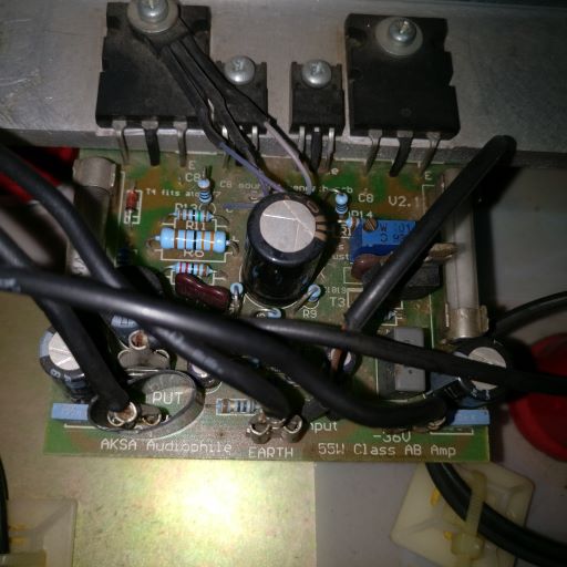

It says "AKSA Audiophile 55W Class AB Amp V2.1"
The PSU board is mounted upside down. Difficult to take a pic without dismantling. It has 4x4700uF Nichicon caps.
In the new chassis, plan to move the heatsink to the front, transformers to the midplane and PSU board to center-back.
New RCAs and binding posts, an IEC and a led in front.
