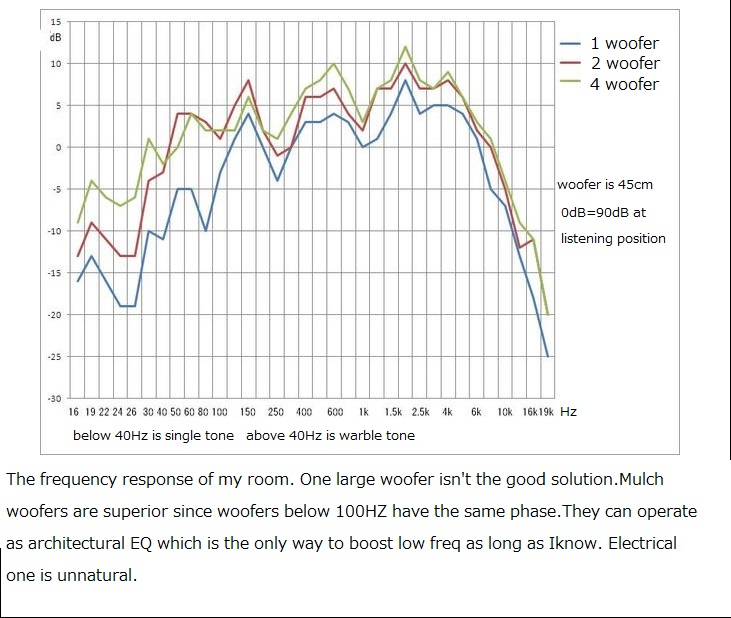

the lower,the better

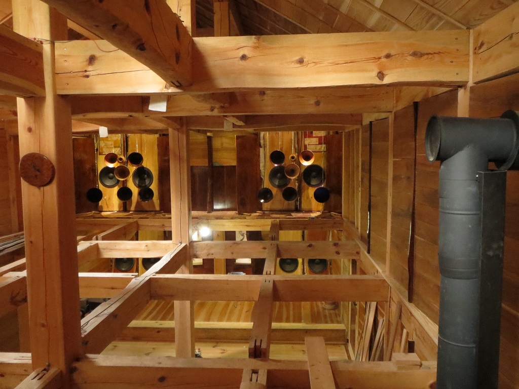

I was an engineer of electrical equipment and built my house and audio room after retiring. My favorite is classic music. I want to make my room like a concert hall though I know it's impossible physically.
The most important thing for classic is bass. The most difficult source for audio is also bass.
A 45cm woofer is not enough for classic as long as I did trial and error. An electrical EQ is also not good.They are lifeless.The only solution for classic is mulch woofers without an enclosure(open baffle).If you make a room rather than an enclosure, mulch open baffles are the best, as long as I have examined.
They operate as architectural EQ below 100Hz since they have the same phase.They have almost nothing to do with mid or high freq.This EQ is very natural which you can't achieve by another way.
What I have learned from my self-build for classical music audio is the importance of bass.The lower the better. You can't hear below 30Hz through your ears.Below 30Hz is the sense of touch where you don't listen but feel through your body.I think the bass is as low as possible if you want to feel music lively.
