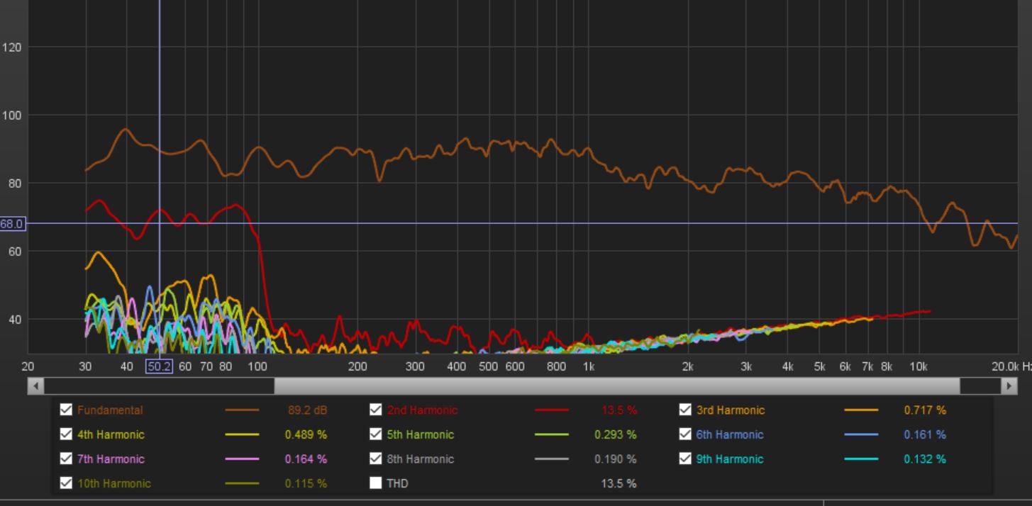

Ben, like I say, I shun indoor measurements, but here's one more at listening position, both speakers running..just for you
To me, everything about this curve says good bass, other than rather high 2nd order distortion below 100hz. IMO,it has good bass because it keeps up with the rest of the spectral output...that simple really...
And guys, pls don't get me wrong...I totally agree if you want either bass volume or extension, you have to go to cones.
That's the second reason I gave up on home HiFi.....killer bass...
and now run 4-6 labhorns...

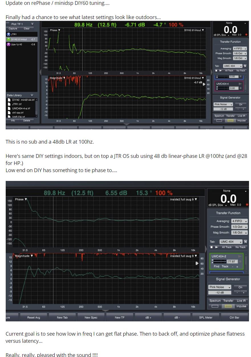

I'v just given up trying to start with measurements indoors anymore.
I believe in divide and conquer...fix speaker outside ... then bring known speaker inside, and see what can be done with placement and room acoustics...
Below is an example of that process on latest project...
..first plot is 3-way active box tuned outside (for x-over at 100hz)
..2nd curve is with the box taken inside and crossed with sub.
2nd curve is close miced and not fully representative of listening position,but it still shows that good tuning outside has real value inside..
