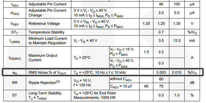

eN will be worst 0.01%/Vo?
eN=0.0001/15v= 6uV
I don't think the units are working out there to wind up with volts in the numerator. It looks like 0.0001 per volt out. So you would need to multiply by output voltage: (0.0001)(15V) = 1.5mVrms (worst case spec, 450uVrms typical).
The datasheet for the onsemi version of the part spells that out better, below.
eN=0.0001/15v= 6uV
You need to multiply by Vo, not divide. So its worst case is 100ppm of Vout which for 15V out is 1.5mV. Typically though 500uV. Note the bandwidth though is only up to 10kHz for this figure.

LM317 output noise at 15Vout is indeed 450uVrms typical(1.5mVrms worst case).
However that is without a cap at the adjust terminal.
Once you add that, the LM317 output noise essentialy becomes equivalent to 0.003% of the 1.25V reference voltage. So in most normal cases with say a 10-100uF cap at the adjustment terminal you would get around 1.25 x 0.00003 = 37.5uVrms typical output noise(112.5uVrms worst case). This amount of noise may vary depending on the manufacturer of the LM317 and process variations, but getting noise levels of around 50uVrms is not an issue with the LM317, even at 15Vout. Increasing the adjustment cap to 1000uF and getting noise down to the 20-30uVrms should be possible.
As an example, Douglas Self in his "Small signal audio design" book gets 39uVrms(-86dBu)noise and ripple with a simple 17Vout LM317 supply with 47uF adjustment capacitor. Although he doesn't specify the bandwidth I think is is safe to assume that he used a 20-20kHz bandwidth.
